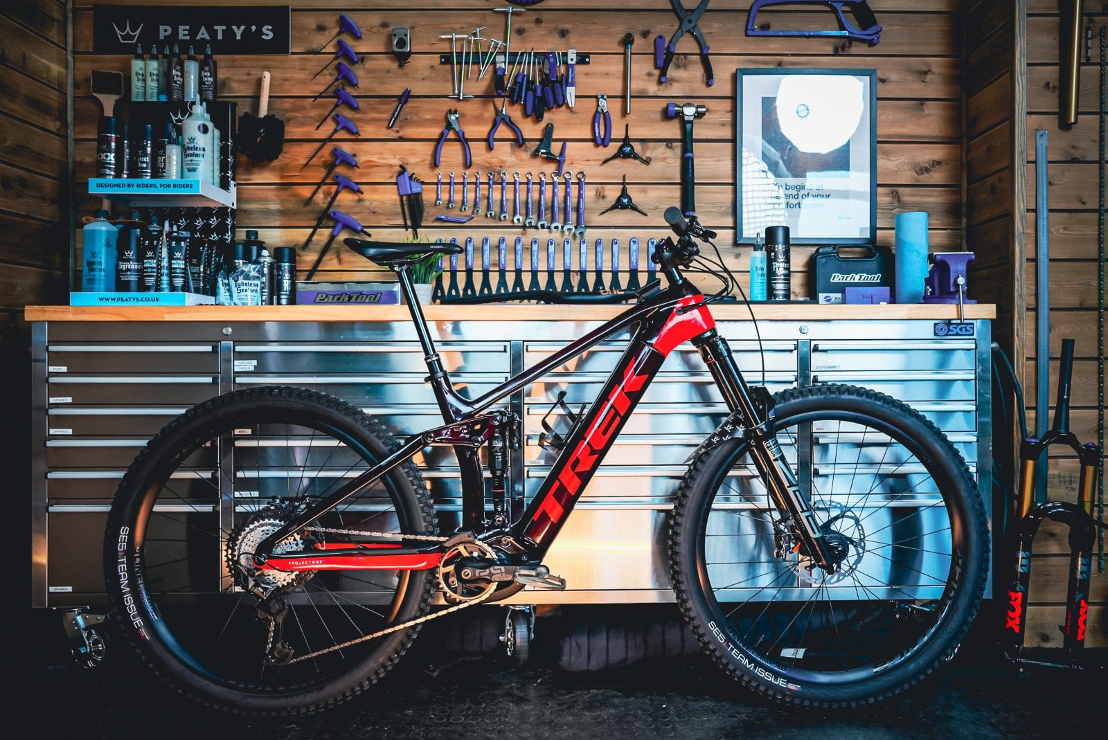

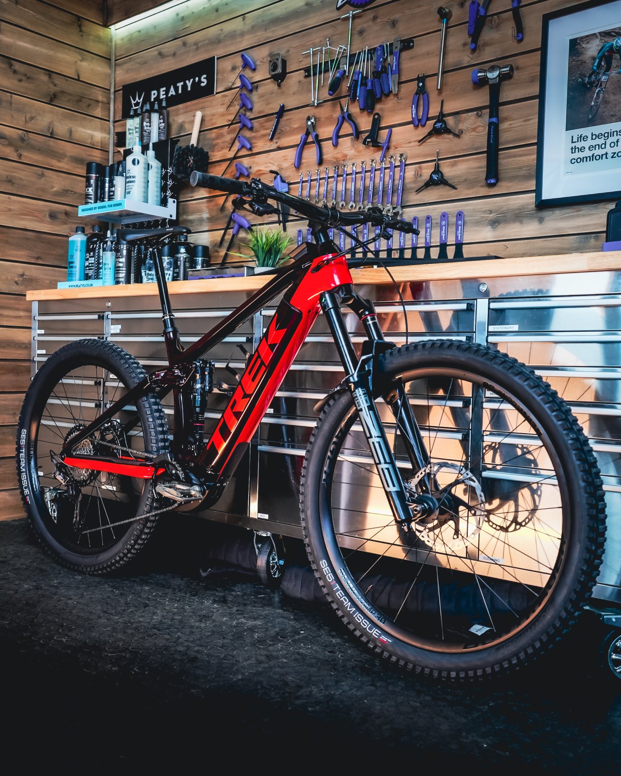

Super nice! Assuming 170mm in front. Is that a 160mm shock? The carbon wheels look mint & good choice on the tyres as the stock ones are not great in the wet/mud. Enjoy!
170 Front. I think it’s about 170 in the rear too.
Am running a 230x62.5 shock and in the high position (2.4” tyres are a fair bit smaller than the stock tyres).
Measured BB height is 442 mm (ish) and head angle is 63.8.
According to AndreXTR’s suspension analysis, the rail in the High position gives 5-6mm more travel than Low.

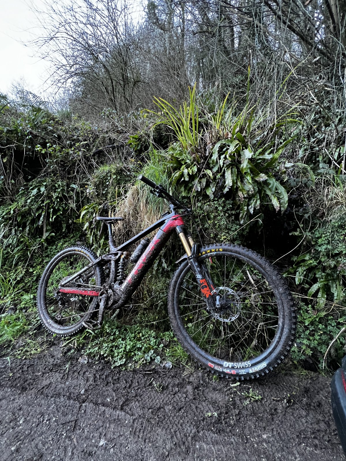

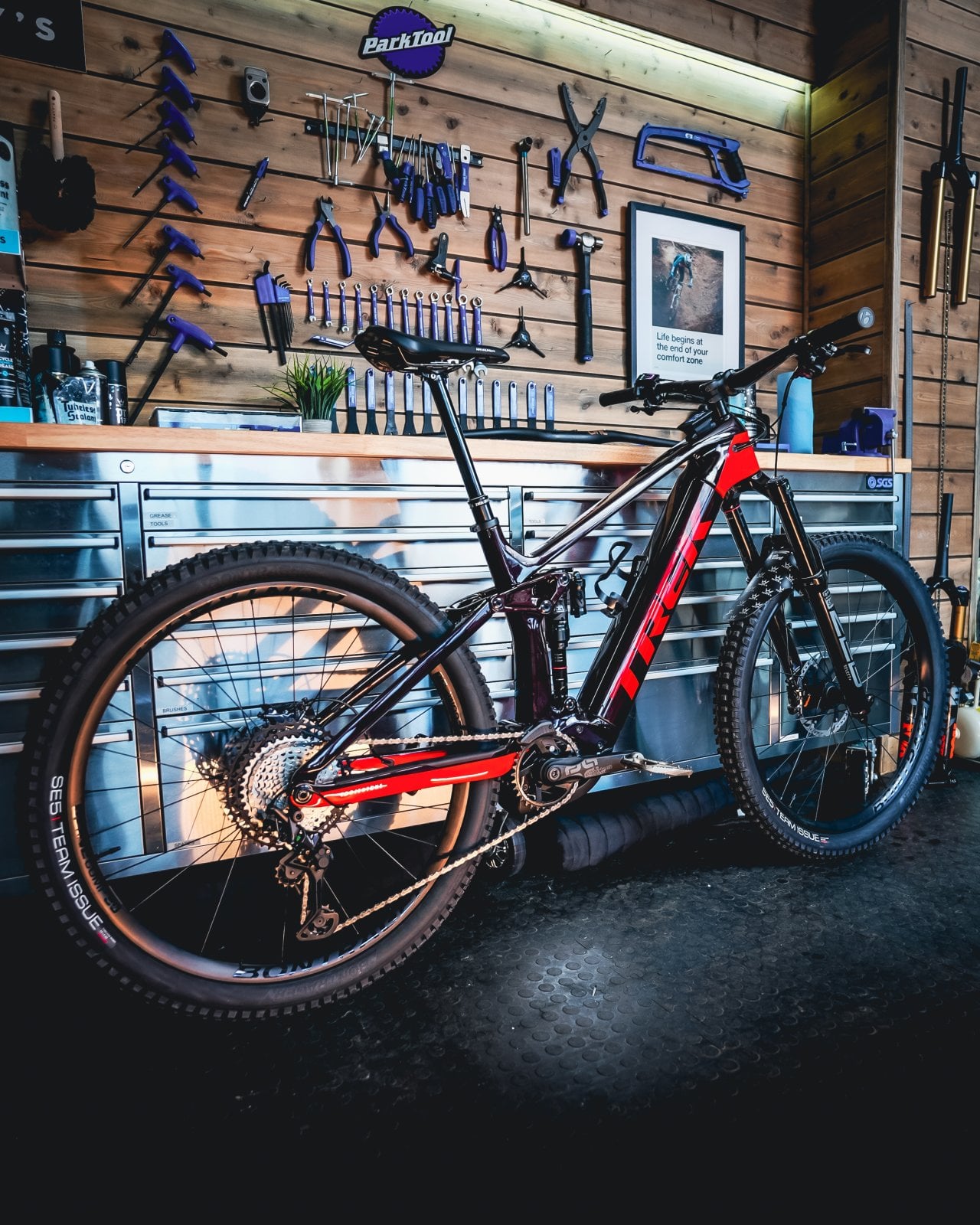

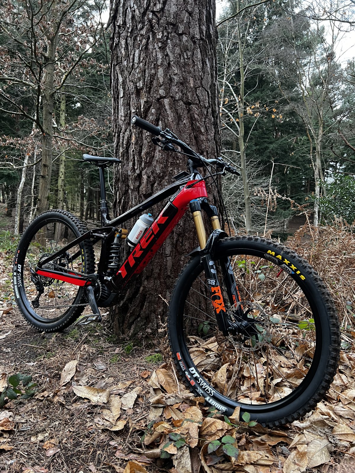

First proper ride today in the Welsh hills. Rocky, techy, slippy.
Bikes riding well.
to answer some specific questions on suspension:

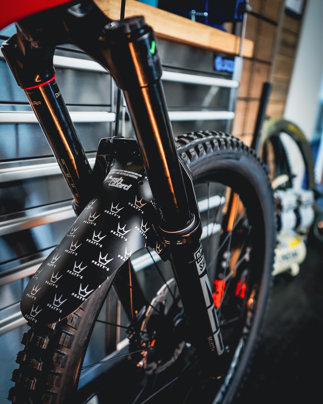

After riding 3 Fox 38 170mm ‘ebike tuned’ forks on other bikes (Nukeproof Megawatt, Yeti 160e, Giant Reign E+) I found them to be very high quality forks / tunes.
The ebike specific Fox 38’s have a different tune on the damper: softer initial spring rate and more progression at the end of the stroke according to Fox.
Having been extremely impressed with the performance of them on prior bikes I’d definitely have them on my own bike.
The standard rail actually came with the Select+ Zeb which has the standard charger damper. To be honest, if I could have sourced the ultimate damper upgrade then I’d have probably just upgraded the stock forks. But there’s zero stock anywhere.
So I bought A set of Fox Factory 38’s for the Rail in 170mm. Ebike tune.
The Ohlins choice was simple. It fits (EXT doesn’t) and with a 230x62.5 shock together with the Rail Mino Link in the high position, it’s getting around 165-170 ish rear travel.
So it’s now a super capable long travel ebike, can take big hits, suitable for bike park, Alps, enduro riding, local XC loops pretty much anything. It’s the ultimate do it all ebike maybe? Works well for me and my setup 👍
Sizing down to a Large has meant it turns quicker, is much easier to bunny hop, is more balanced than the XL (my weight is more central) at the expense of straight line stability.
With the massive 750Wh battery, the Bosch powerhouse motor and big travel it’s an incredible machine!

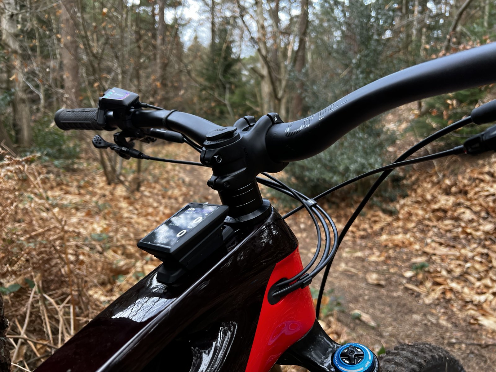

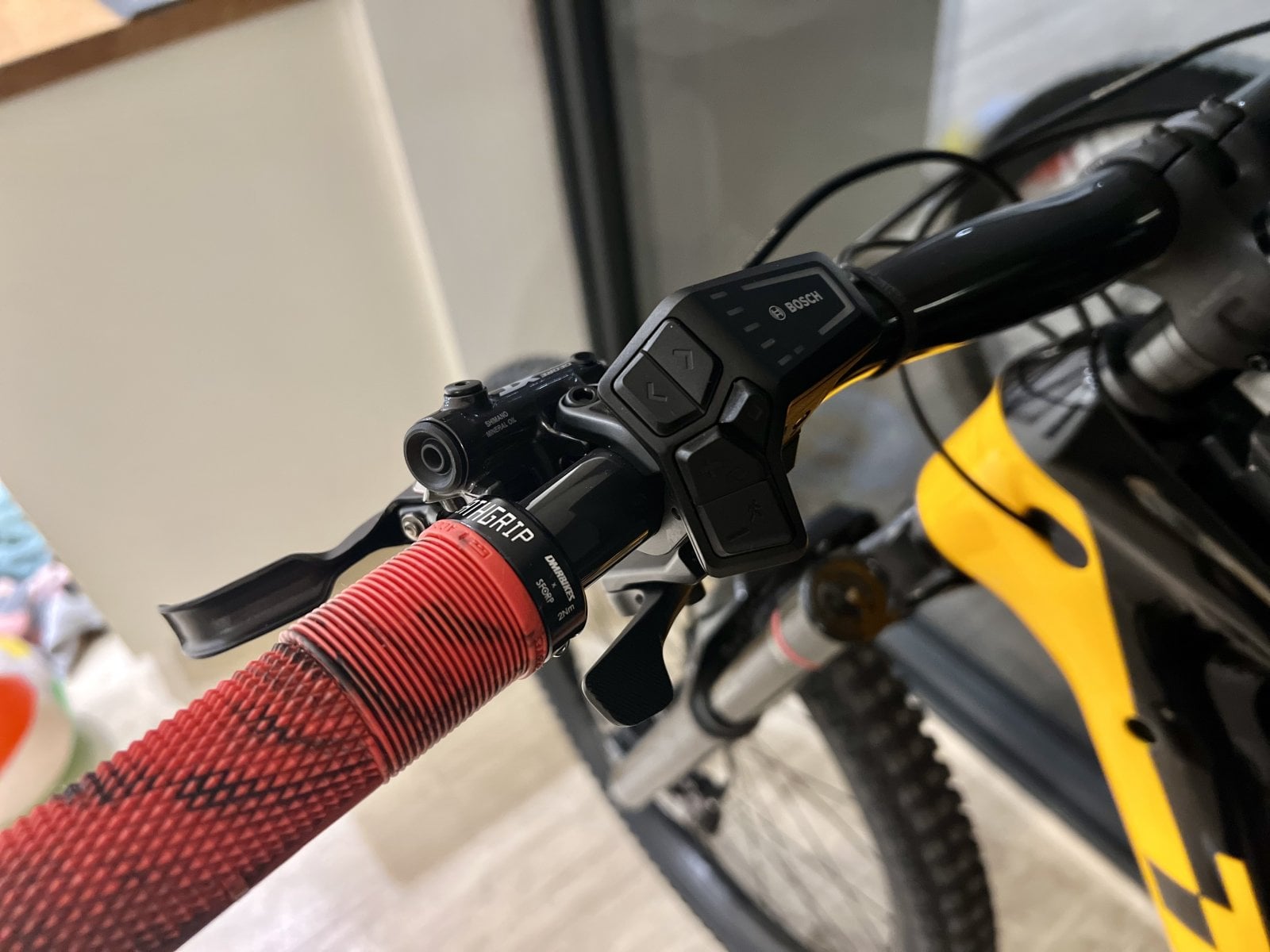

Hi. Is this controller solid enough? What happens if you flip over the handle bar? Looks like it's designed more for commuter bikes than for mtb

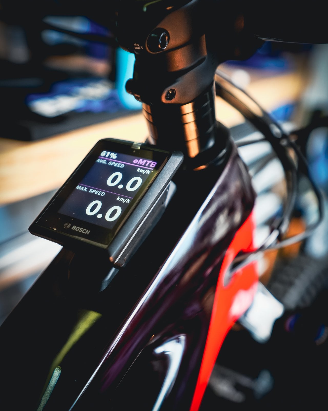

@Rob Rides EMTB : What is your impression on Kiox 300 and Bosch Flow app combination? How fluent is the integration with HRM-belts, Strava or equivalent etc? Every app has it's glitches but just wondering the current quality and especially end user usability on Bosch software.

@Rob Rides EMTB : What is your impression on Kiox 300 and Bosch Flow app combination? How fluent is the integration with HRM-belts, Strava or equivalent etc? Every app has it's glitches but just wondering the current quality on Bosch software.
I'm thinking for buying (but no actually for me) a bike with 750w system and I have a feeling that "all" development resources at Bosch has been directed to this new ecosystem and it could justify the little higher price.
Its a good looking app/system with great potential.
But sadly, at the moment, it's really basic in what it can do. Although it records rides automatically, there's no integration into Strava, so its pretty pointless. The ride simply sits on the app (or Apple health for those that use it)
.Can't even export the ride and import the GPX into Strava. So I end up just recording the ride on Garmin Fenix Watch as that integrated to Strava with more health stats.
The software looks very well designed, but extremely limited in application. Its only real function at the moment is to make custom riding modes. Even then its only Eco and Turbo that can be customised.

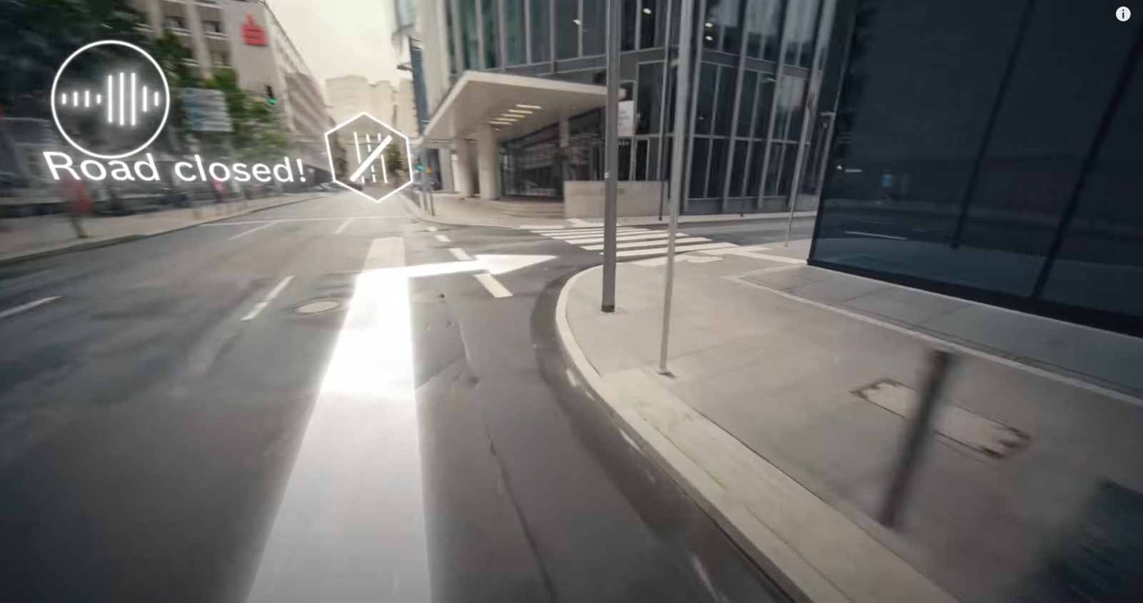

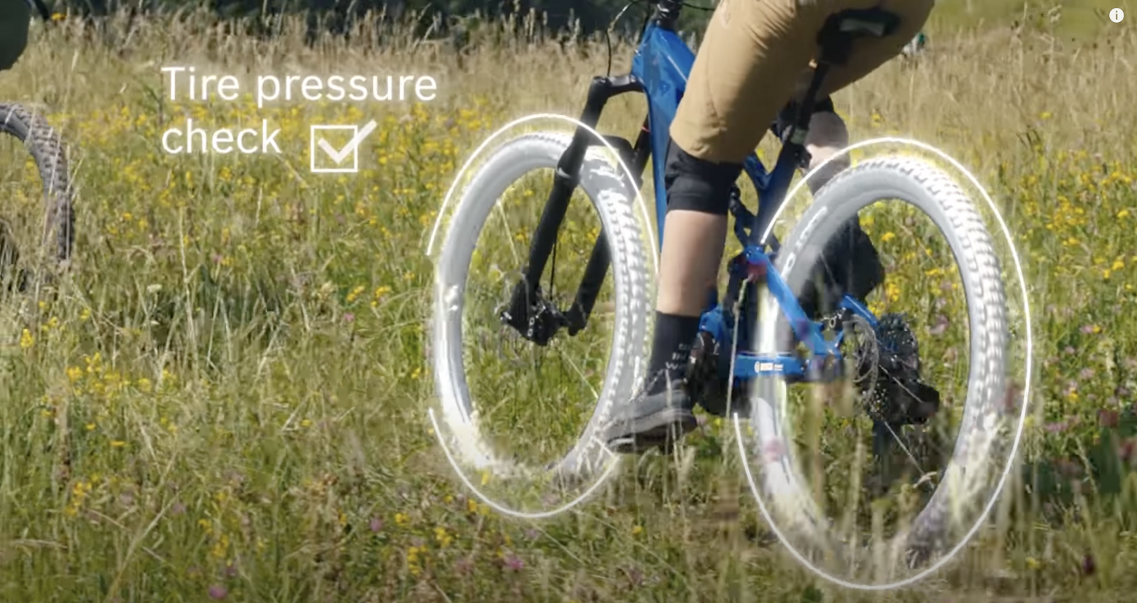

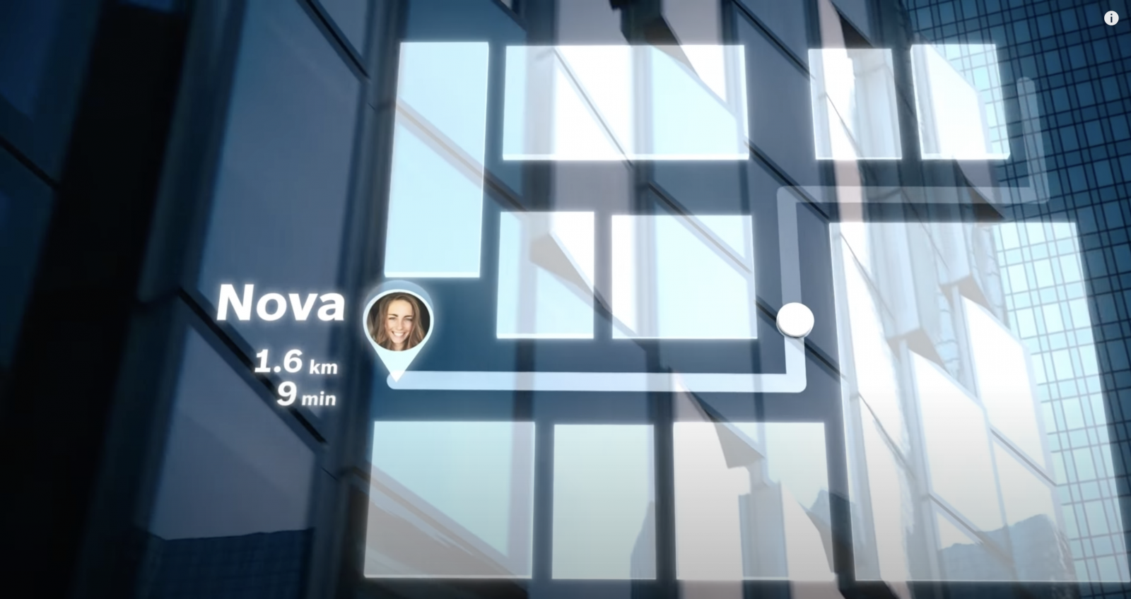

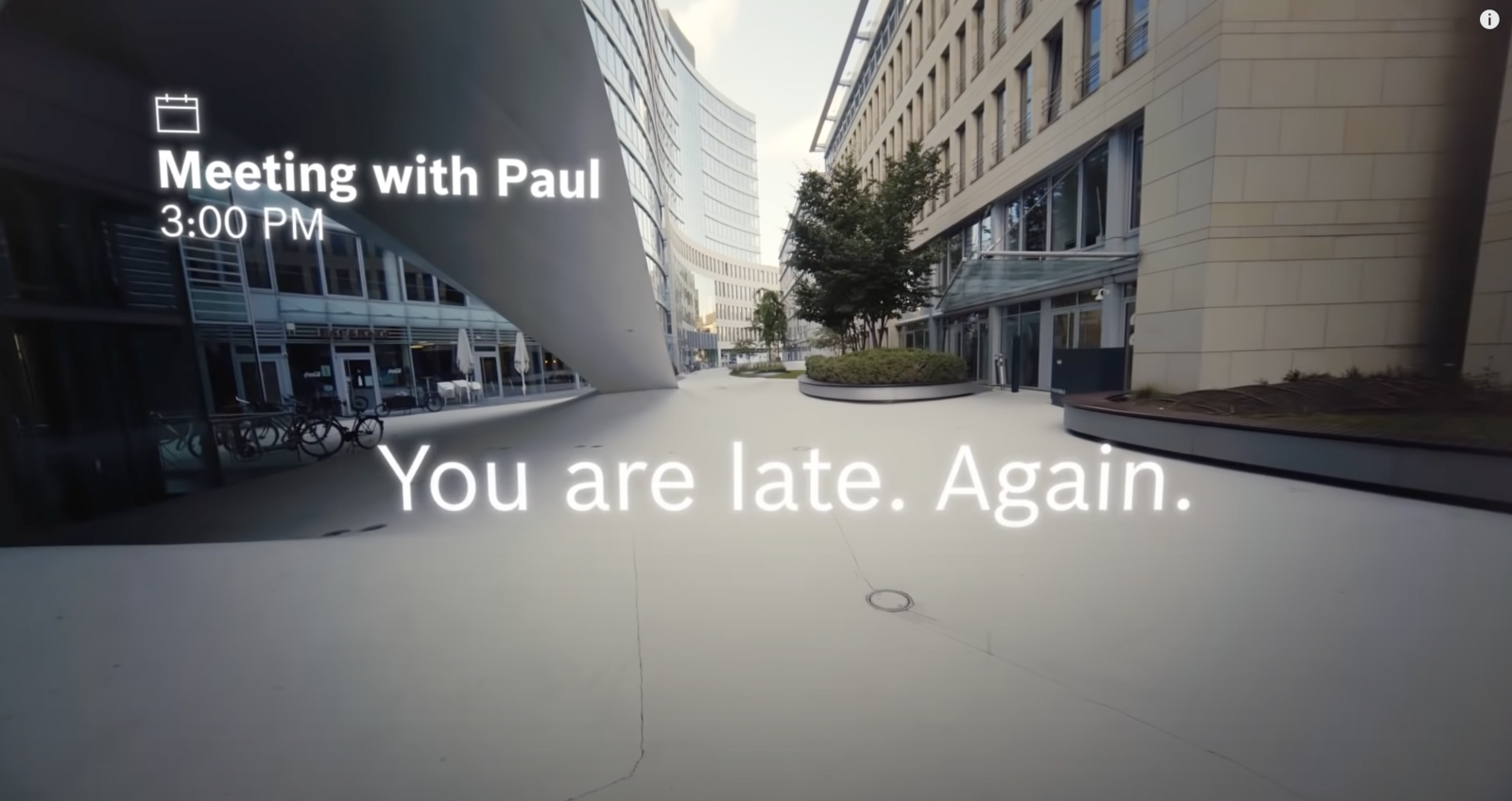

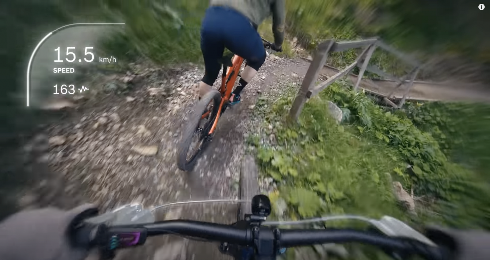

At least Bosch are thinking about these future features too! Here's some screen grabs for Bosch's 'What If?' ebike video...

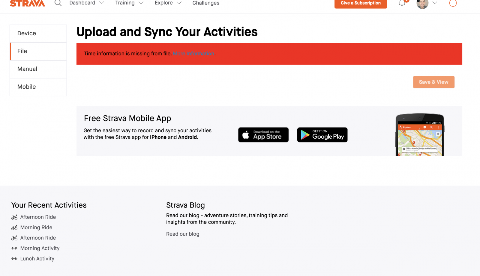

"Can't even export the ride and import the GPX into Strava".
They should began with this, basic things. I don't understand why on earth this isn't possible? It should be.
Agreed. If I try transferring the GPX to my laptop and manually uploading to Strava, it gives an error message. It seems the Flow app is missing some required details in the GPX.
