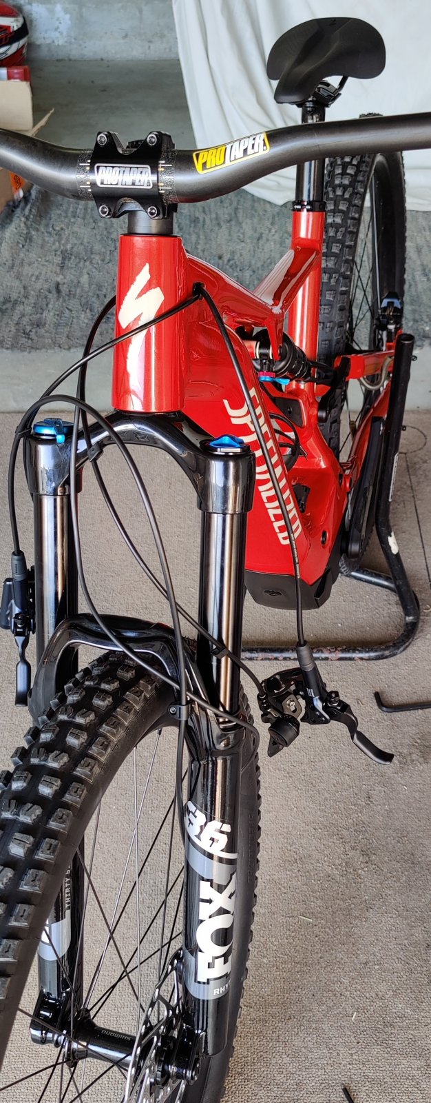

Post #18 shows the red in detail...

After seeing it in person, I wouldn't characterize it as orange, but rather a 'bright' red. If you gravitate to a bright flash color, it might be the one for you, it is beautiful IMO. Here is a youtuber with one. You can see it in video here: James Goodsell

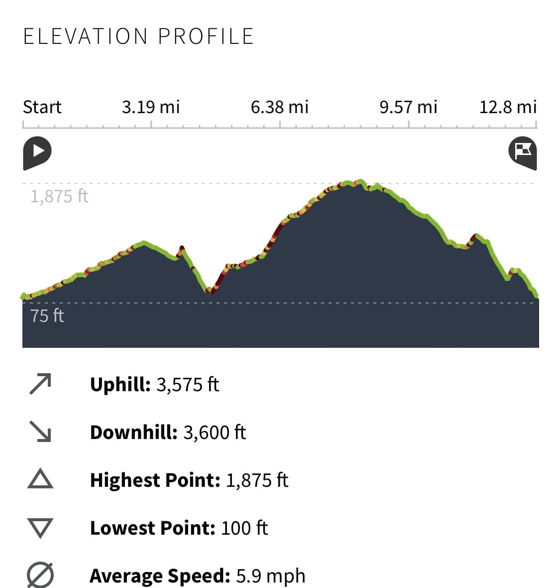

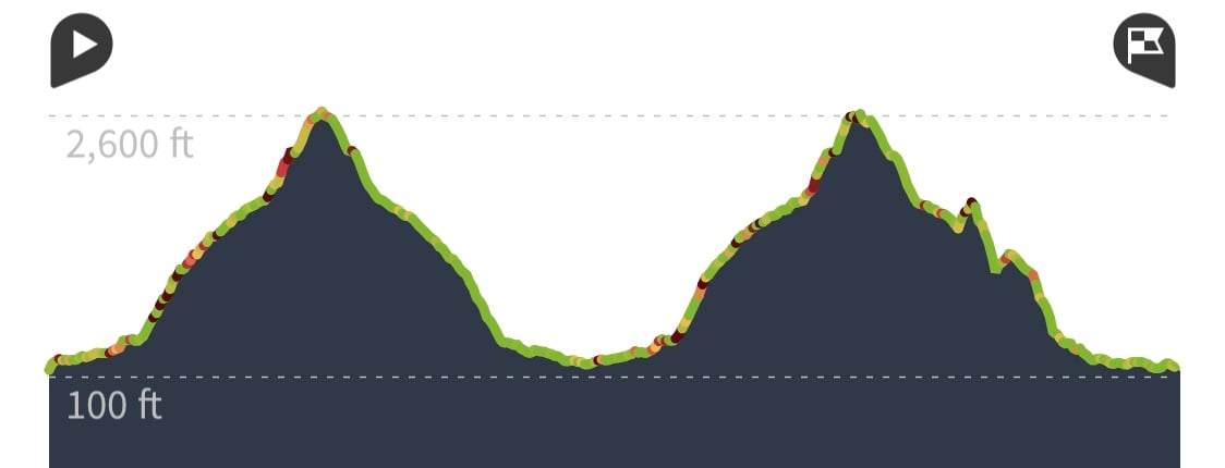

My wife and I received our 2021 Turbo Levo Comps recently. I got the Redwood in a medium and my wife got a small Oak Green. I received my bike about a month before we could get hers.
Before we rode the bikes I changed the tires to Maxxis DHF front and Maxxis Agressor rear. We ride them with about 27 psi. These tires have worked well for us on our other bikes (Spot Mayhem 130). I usually set them at 20 to 25 lbs on the Mayhems.
For my first ride I rode the Comp 31.5 miles with 4300 feet of elevation. A one-word description is Incredible. Since this was a test ride, I used all three modes in all types of terrain. I was less interested in keeping my heart in a training range and/or conserving battery and more interested in seeing what the bike would do. I was riding out of the Central Valley, California in the Sierran foothills. Terrain ranges from flat to 35% gradient inclines with hard pack, loose gravel/sand, rocky washed out areas, sandy stretches, single track and wider 4 wheel drive roads.
There are fast downhill sections, constrained canyons with many berm to berm turns, lots of little jumps, and a few large jumps (what I consider large – not what a good rider would consider large). Note, I am a moderately aggressive rider but not crazy. In my mid-60s I want to have fun, push some limits, but live to ride another day. I only have 3.5 years of experience riding real mountain bikes. Thankfully, my crashes have only been loss of skin and one new helmet.
On flat and downhill runs we generally turn the mode to off unless speeding up for a jump. Lately we are doing 20 mile rides with 2,000 to 3,000 of elevation and we are only using 20-25% of the battery. We rarely use Turbo unless we have exhausted ourselves. Using Eco and some Trail we can generally keep our hearts in a training range for several hours. One thing that we both note is that we get much more of an upper body workout than on our lighter carbon bikes.
We both ride up hills that we just cannot do on our Mayhems. I am sure that better and stronger riders could do them. I have not been able to. The gradients I climbed on the Comp were up to 30% (according to my Garmin) and were rather easily climbed. There is a 35% hill that I have been unable to climb but will keep trying it. It has a lot of loss soil and I always spin out. When riding in non-assisted mode the bike pedals nicely. On flats and downhills it pedals very easily.
When on assisted mode the motor noise is very, very low. You don't even think about it. I jump small jumps (<20 feet horizontal). The bike performed similarly to my Mayhem. However, due to the weight (50.0 lbs vs ~28 lbs), the Comp feels much more planted in many situations. The Mission Control app was great. I changed the default settings to 35-50, 50-70, and 85-100. I did this after watching a guy named Marshall Mullin explain how the settings work at These settings work well but I need to play with other variations. I use the 100% Acceleration Response but 0% Shuttle settings. I will be testing these settings. I will be lowering the Eco setting to 20-50% to see how that works.
The Fox 36 And rear shock were fine. I set them up as per Fox online instructions. They were a little harsh on very rocky trails. However, this should be fixed when I adjust the rebound settings. The dropper post is very good. I like my BikeYoke Revive on my Mayham a little better (it seems smoother and the remote seems more responsive) but the X-fusion Manic seems to work well and I have quickly adjusted to it. The LBS mounted the mode switch such that the dropper remote lever hit the electrical cable when using the remote. This would soon cause a break in the control wire. A 2mm hex adjusted it properly.
The brakes work well. The shifter and drive train were fine and relatively smooth. My Mayhem is a 6 build with SRAM Eagle XX1 but the lower level Shimano SLX components work nicely enough.
The seat is surprisingly very good. I had no discomfort after 31 miles. It seems much better than my WTB seat (Mayhem) which wears on me after 15 to 20 miles.
Overall, we are very pleased with the bikes. It was extremely fun to be able to ride hills that previously were not possible for me and to able to do many more downhills in the same amount of time I usually ride. Additionally, my wife enjoys the rides because she is not playing catch up with me. My wife is a very cautious rider but I have noticed that she is attempting downhills that she would not previously consider. She says that the bike feels much more planted and secure. Which is just what you would expect from a 50 pound bike.
We said we would not consider ebikes until we were in our 70's. However, young people convinced us to try them. It has definitely been a good thing.

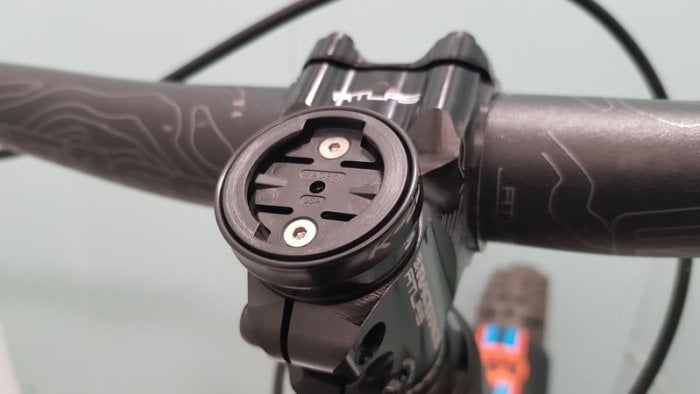

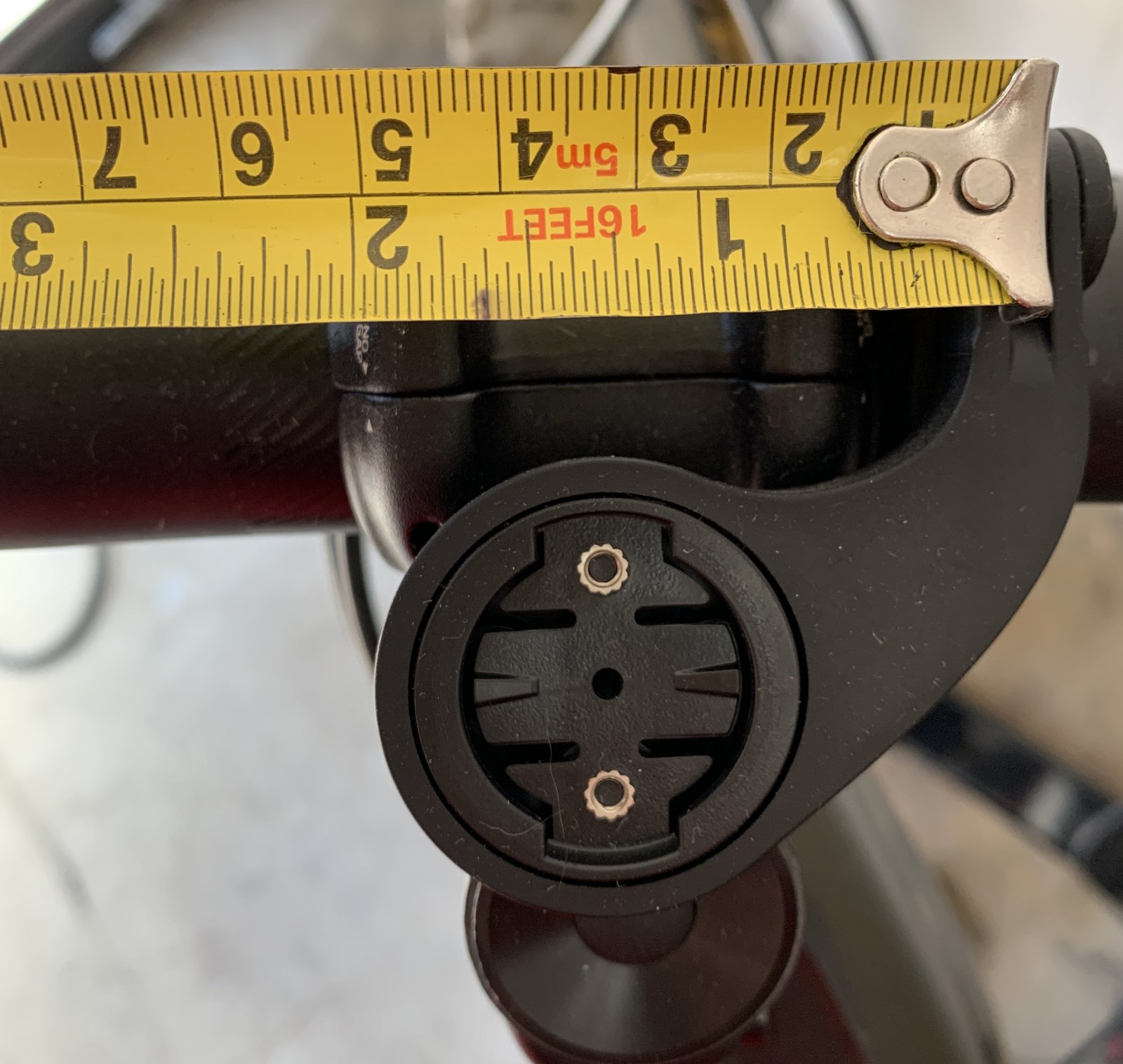

Just picked up my 2021 Sage Comp. This year the handlebars are thicker. The mounts that come with the Turbo Connect Display do not fit next to the stem so you can have the TCD mounted center over the stem like intended. You can put it further down the handlebars, but not ideal. Anyone know if there is a new mount?
I know the TCD also works in Garmin mounts. Does anyone know one of those that might work?

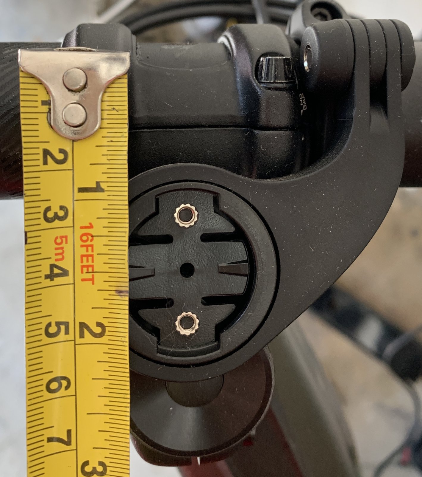

This Garmin 010-12563-02 Edge Mountain Bike Mount works on my 2021 Levo Comp.

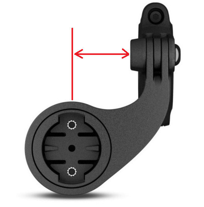

S-works comes with Deity Copperhead 35 stem which has even wider 55mm bar clamp, can you please measure dimension below on your Garmin 010-12563-02 Edge Mountain Bike Mount? Thank you!

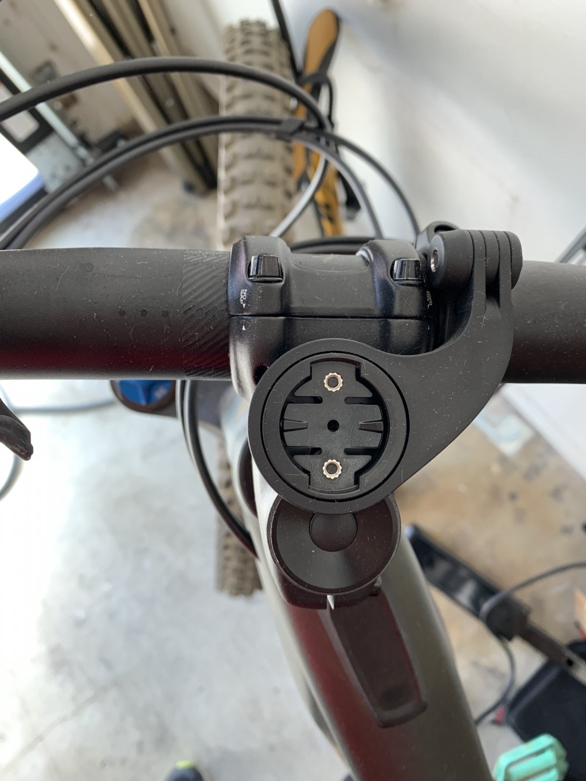

Here it is mounted on 2021 Turbo Levo Comp stock handlebars. The mount comes with rubber padding attached to the mount piece and an extra ring of padding. You won't need the extra padding (for thinner bars).
This stem bar clamp width looks more like ~40-45mm, so I'm now pretty sure this Garmin mount will not fit S-works stem if I want my Garmin device to be on the center of the stem :/
