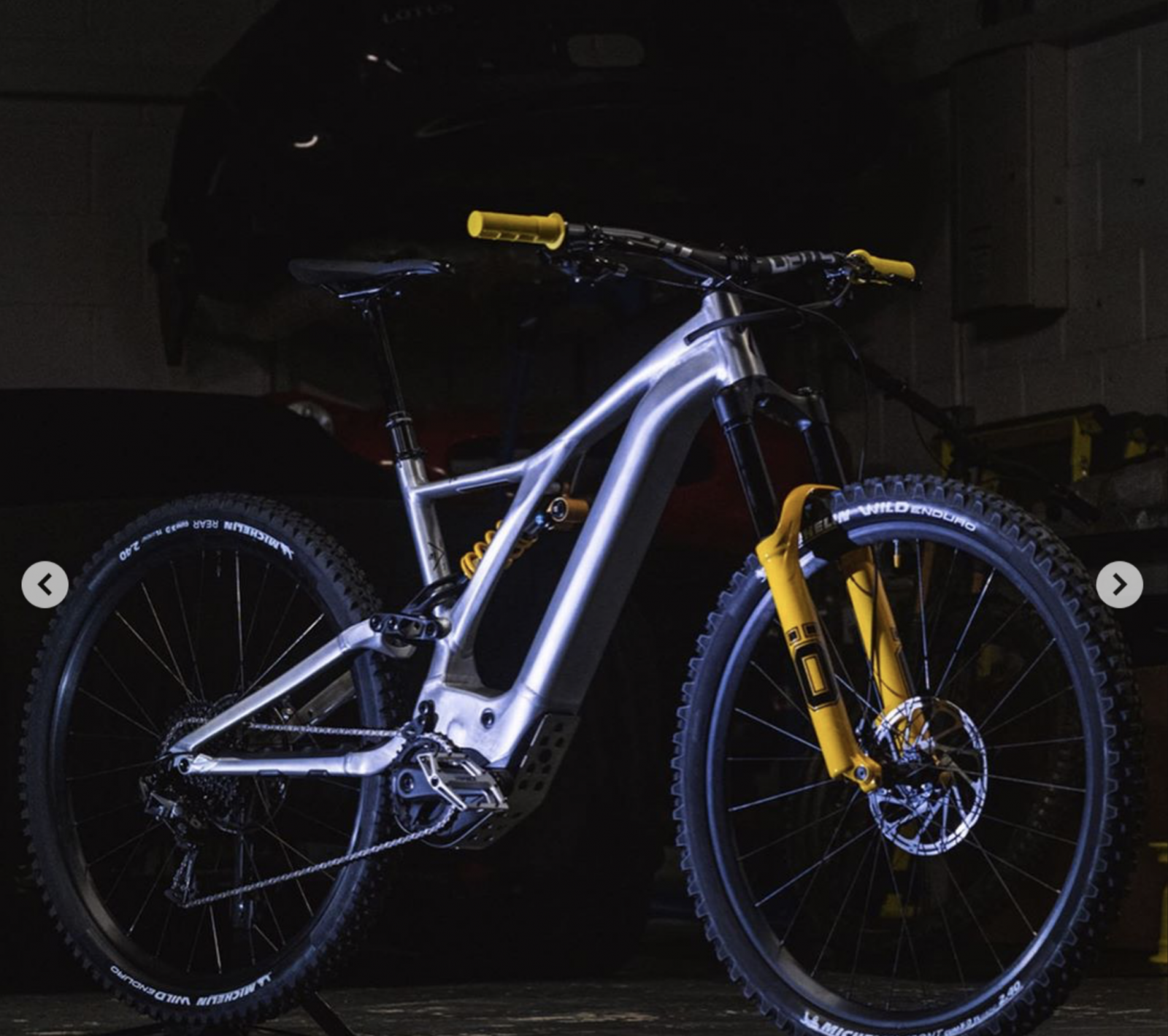

my guess is the paint will shave 120-130g off.
Mainly because somewhere in the 100-120g region has always been the case when I've done it with smaller FS frames

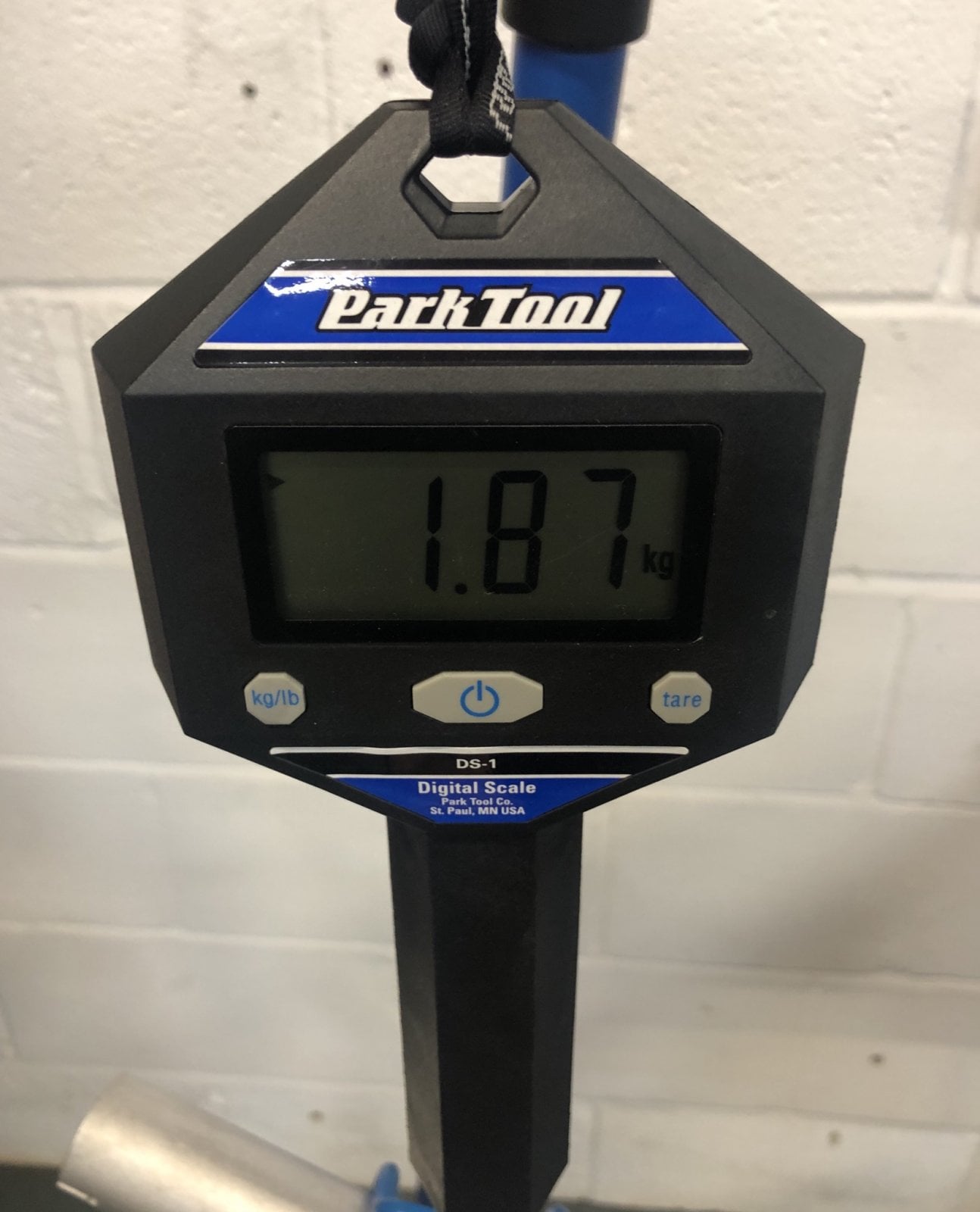

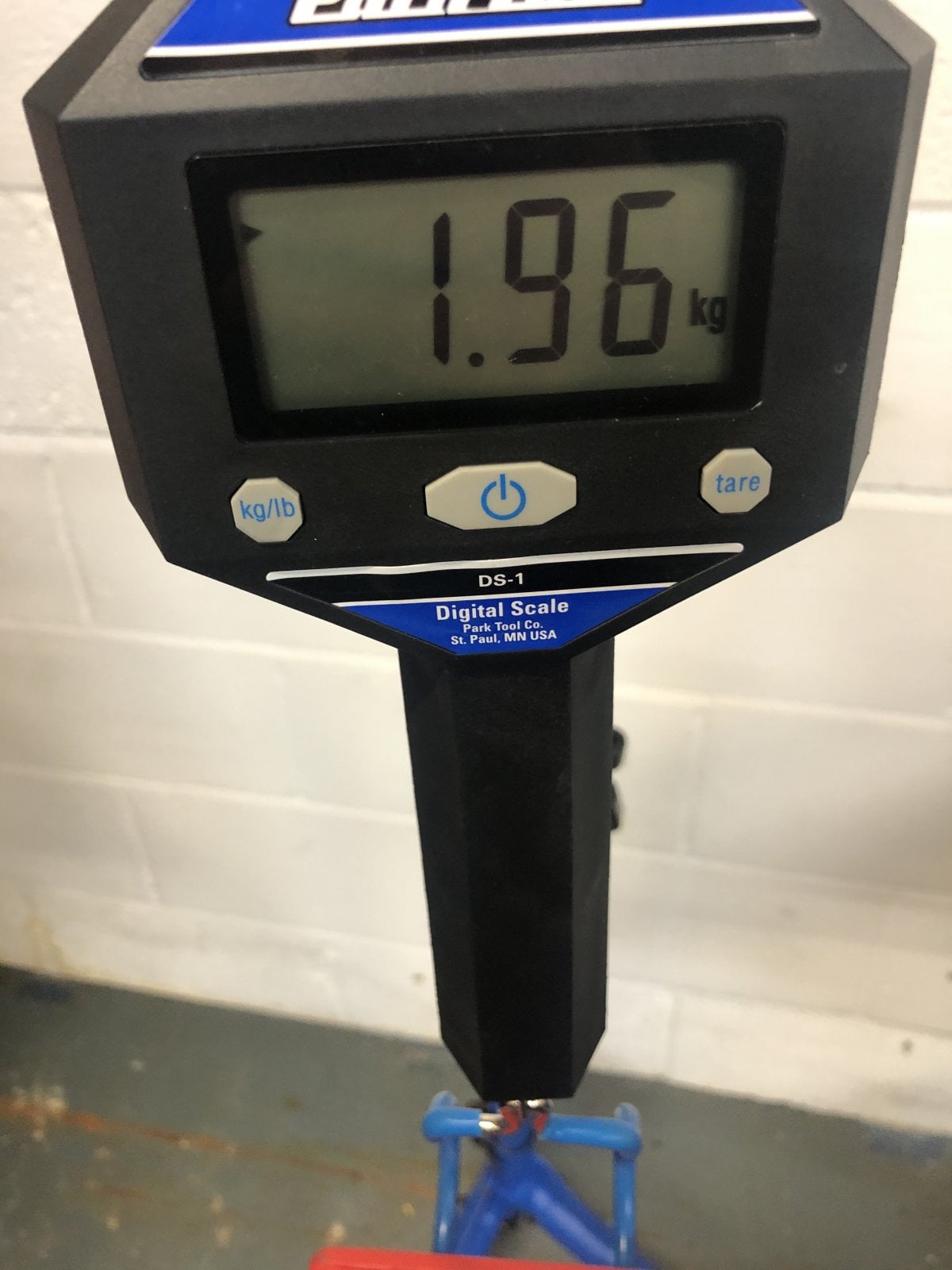

Will get some weights up in the morning, also going to do some comparisons on the stock Sram NX mech/cassette verses the Sram XX1 Eagle I’ll be fitting and stock alloy Roval’s/Carbon Rovals.

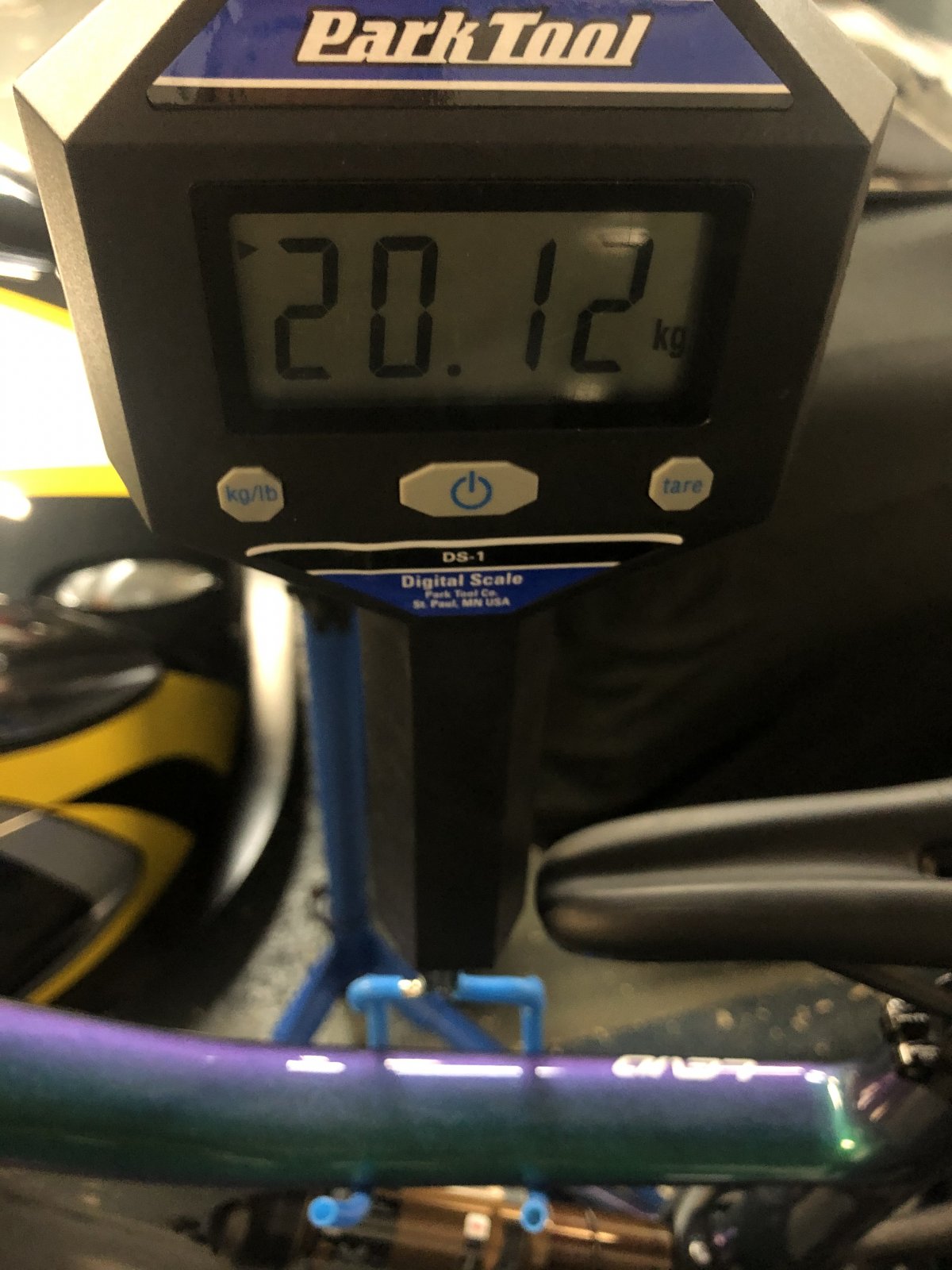

Hope to achieve similar result with the Alloy SL. Compared weight on my stock S-Works Levo(nice factory spec obviously and 700 battery) to my Raw finished Alloy Levo with custom spec (500 battery, frame & dropper only stock items, carbon wheels/bars/cranks etc )

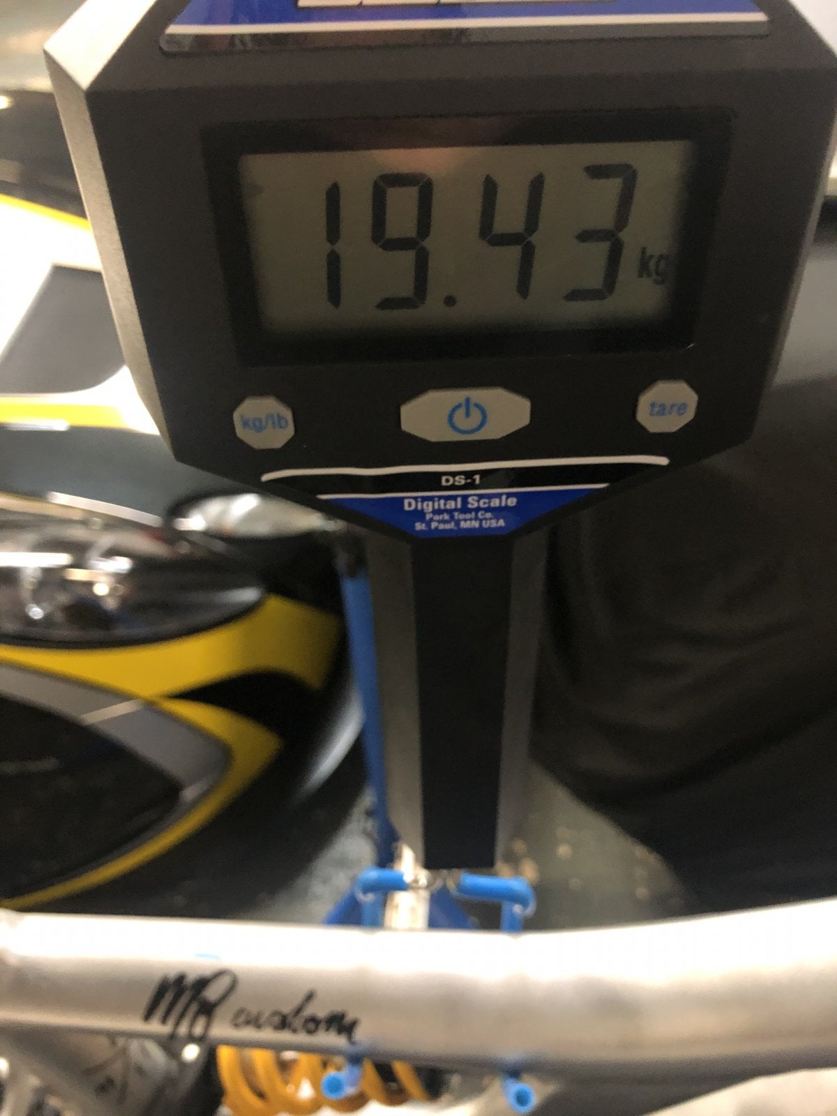

It would require a lot more in this ‘Custom build’ to get this alloy framed Levo under 20kgs. The weight difference between a 700 and 500 is around 700gms. That coil is a heavy lump too. What else was done?
Very sceptical about this ‘weigh in‘ as it does not add up.
More than happy to be proved wrong.
I was surprised too but hard to argue with the scales and picture below of bike on new set of Park Tools scales which I’d hope are accurate??‍♂️ Going to check them against shop ones when have a chance.

Full spec of Alloy Levo below:
2019’ Levo Comp 500wh battery
Ohlins 160 forks
Ohlins rear coil
X fusion dropper w/ Specialized ti rail saddle
Deity 35mm stem
Deity 35mm carbon bars (cut to 770mm)
Deity grips
Sram Code RSc brakes 200/180 rotors & ti bolts
Sram XO 11spd shifter & rear mech
Roval carbon wheelset w/Michelin 2.25 Muds (tubeless)
Shimano XT11spd cassette & chain
Praxis carbon cranks
DMR Brendog Vault pedals

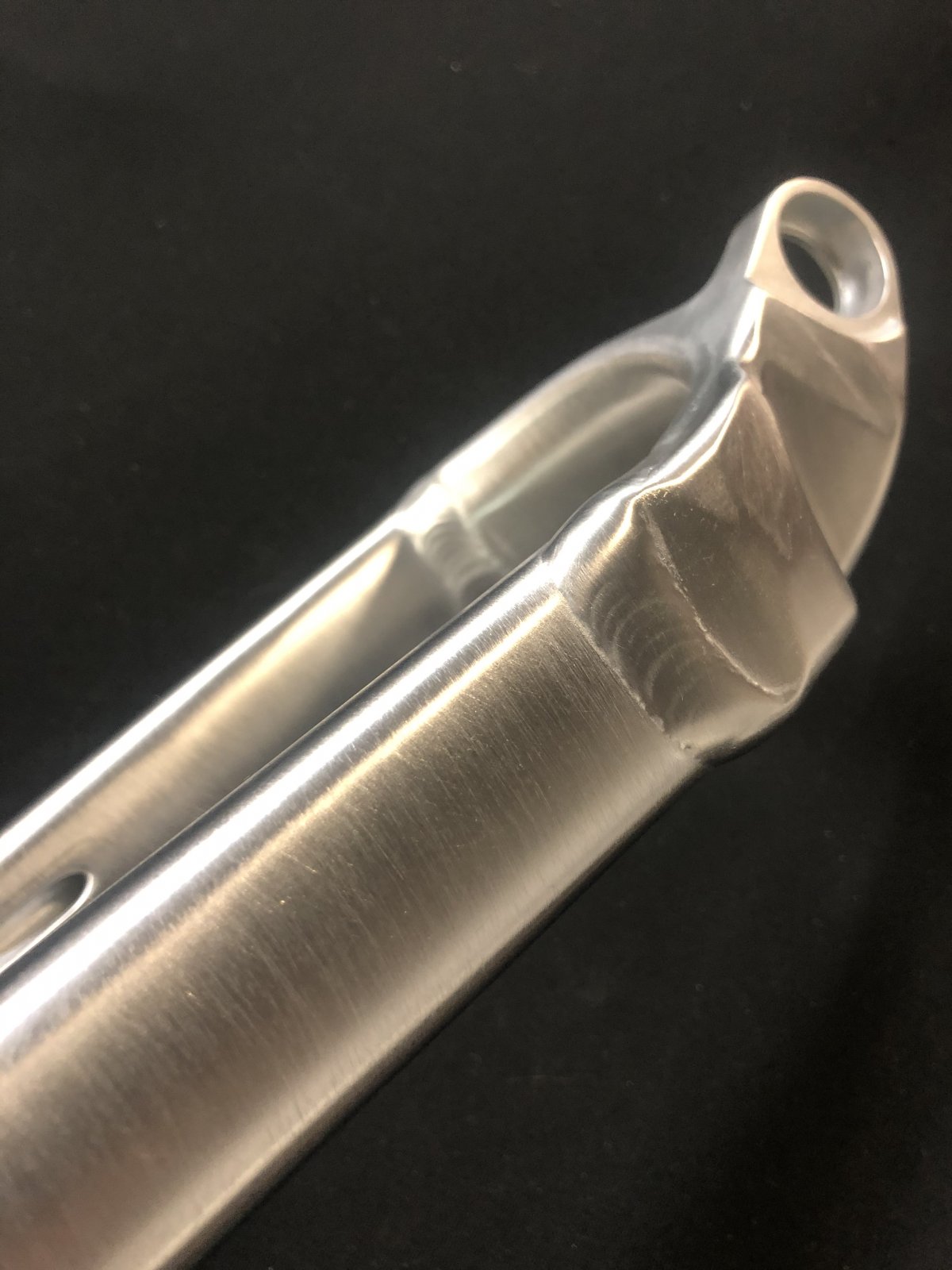

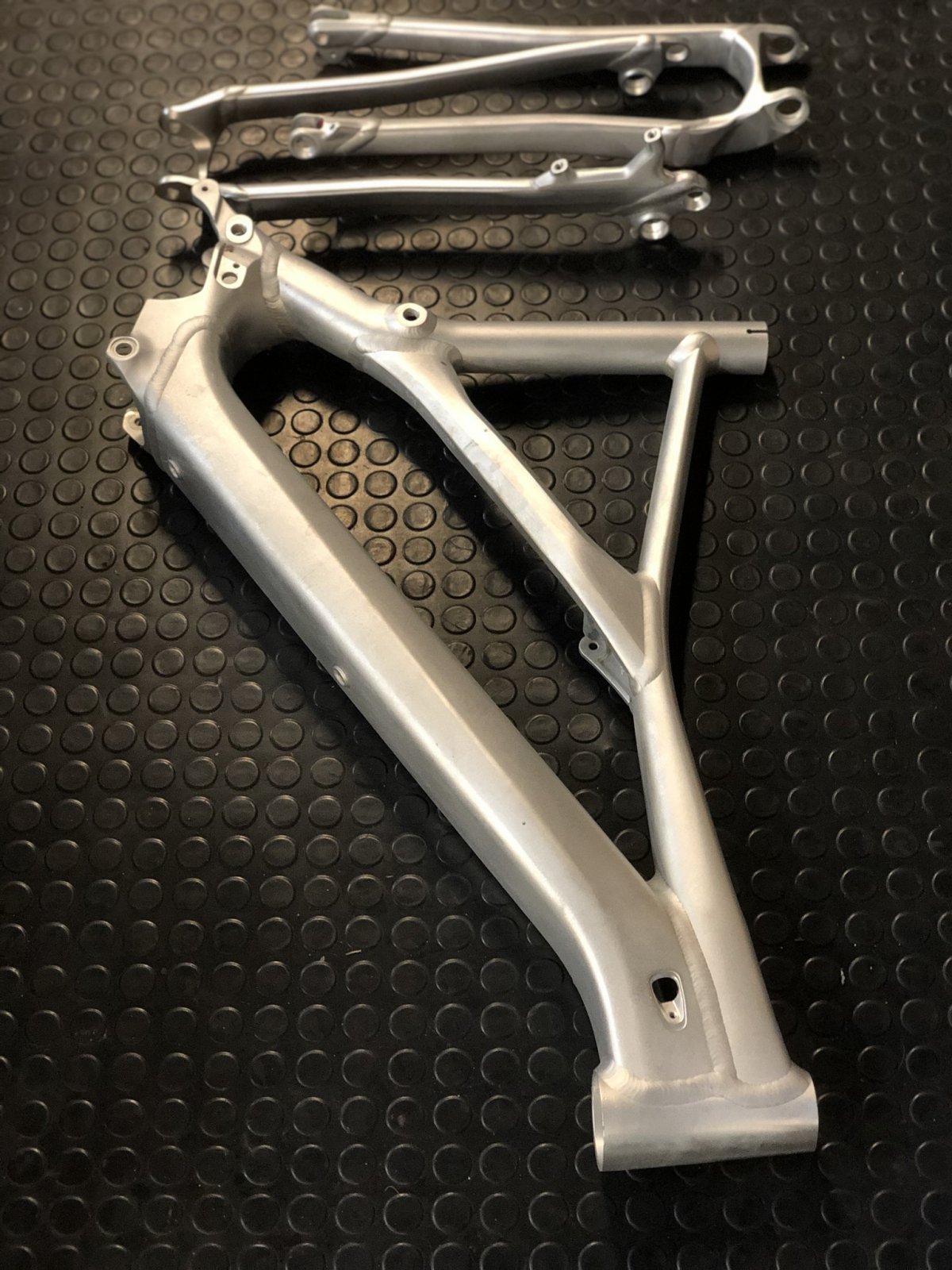

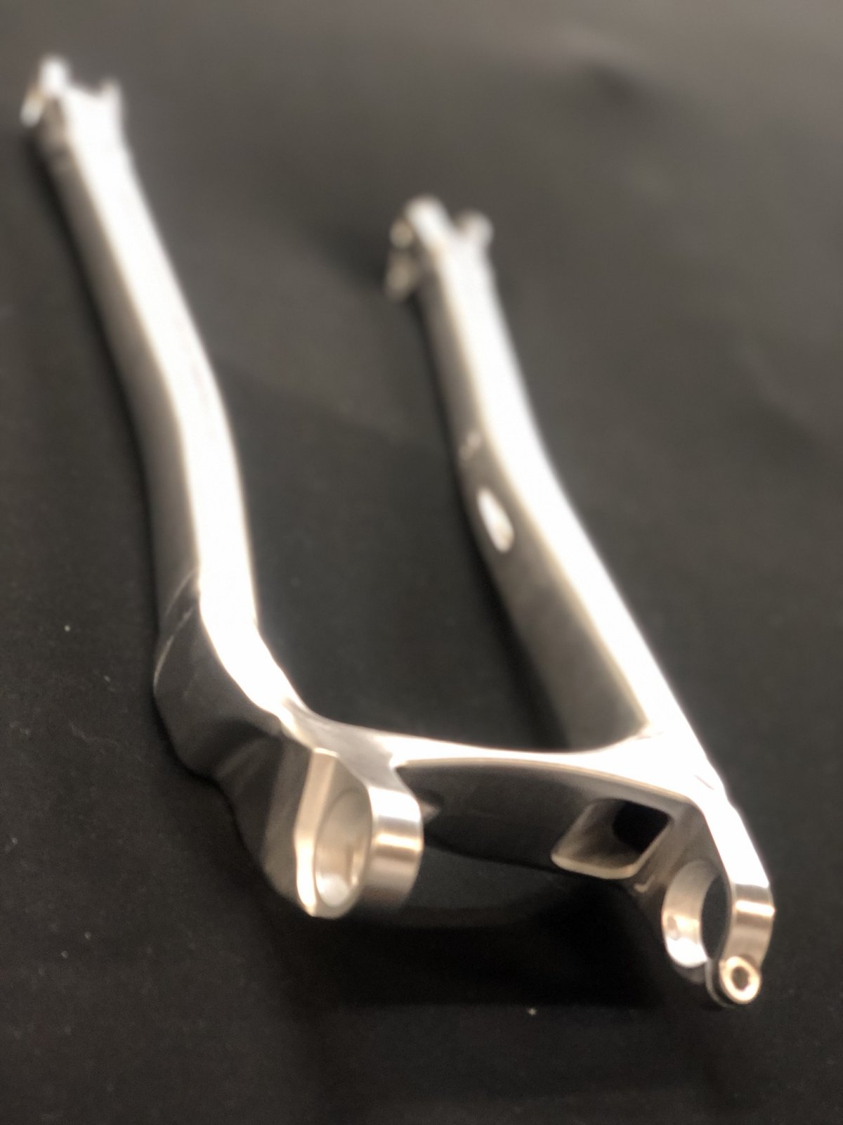

Slow progress but both rear stays near completion. Been doing some detailed weight comparisons so will post up weight of stock stuff verses final build spec.

After you’ve done the brushed finish how do you protect the raw alu?
73Steff
Sep 11, 2018
98
422
Haslemere Surrey
I’m really loving this thread. Thanks for posting so much detail.
Again....patience, will all be explained?
Has to be cleaned to an inch of its life to clear all the sanding debris, then clear coated (I usually use a satin finish) then any decals applied and finished off with an invisiframe kit. My Levo was done in this and has been my winter eeeb, gets a beating and apart from a little heal rub still looks good.
