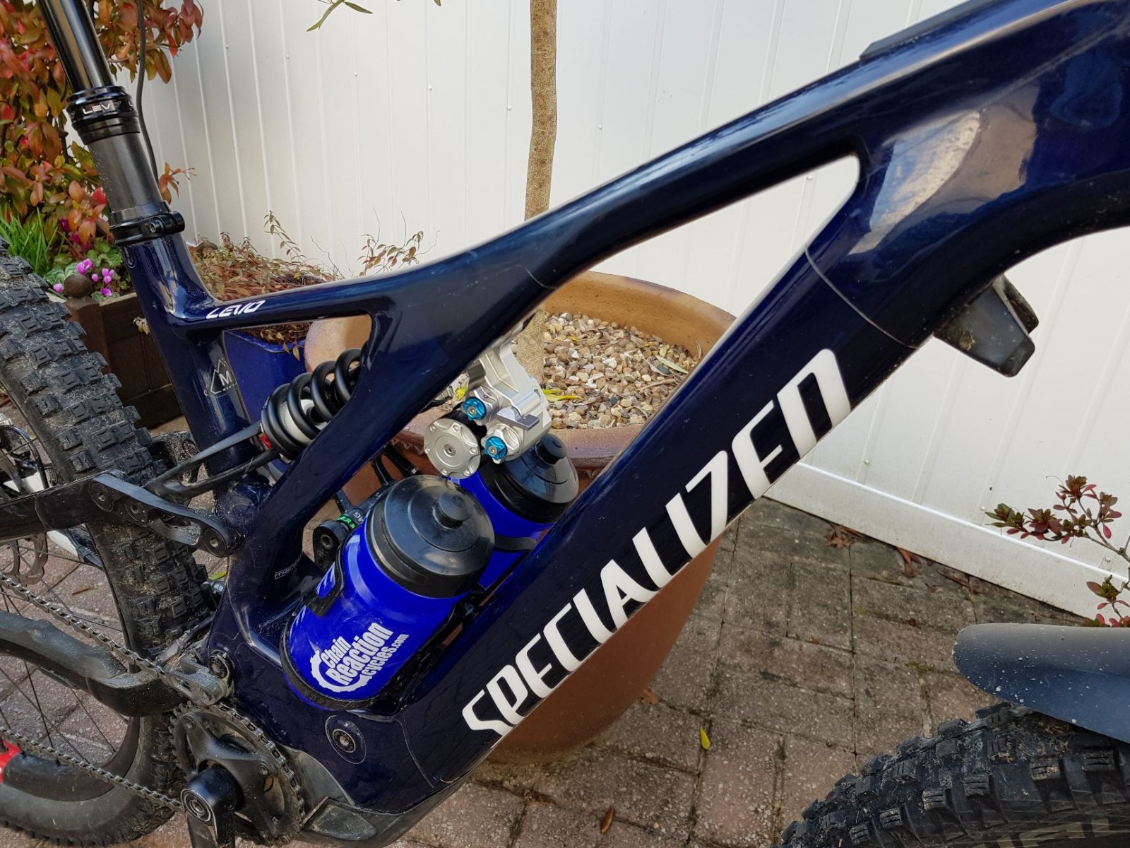

This shock is an ElevenSix from Push?
How did you manage to get one dialed for the Levo?
I think that the Turbo Levo is not in the list of compatible bikes for this shock.
Or did you choose any other bike that shares shock size with the Levo?
Well spotted, and yes it is.
Custom build using my ElevenSix that was on my Nomad 3 carbon. The shock and bike had been sitting gathering dust for the past year and a half while I have been in the eeb zone ?
I had forgotten how good this shock was but it is now even better as it has had some major tweaking carried out and some Fox parts introduced into it.
To quote the tweaker....
Pretty happy with how this came out.
It’s dyno tested and feels brilliant!
PUSH/FOX 210mm x 55mm Frankenshock. Perfect for a Halloween night ride me thinks ?

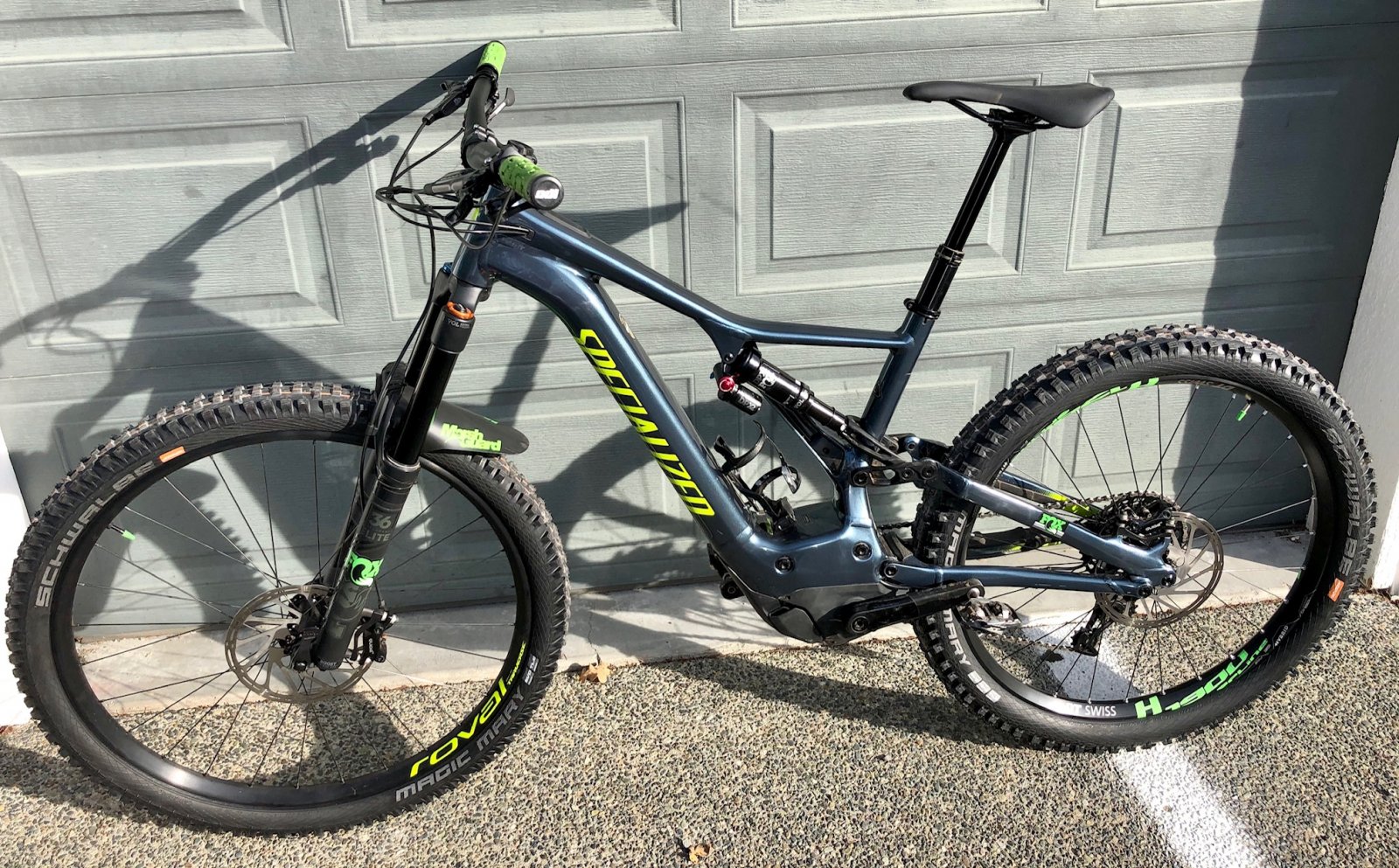

Went full monster truck on my comp.
180mm DVO Onyx SC with black diamond 2.6 tires and cush core. Trying to figure out what shock to run to pair with the Onyx fork. I loved the Topaz on my Enduro. But really want to try a coil setup. The fork will get dropped down to 170 or 160mm as the 180 is way to much.

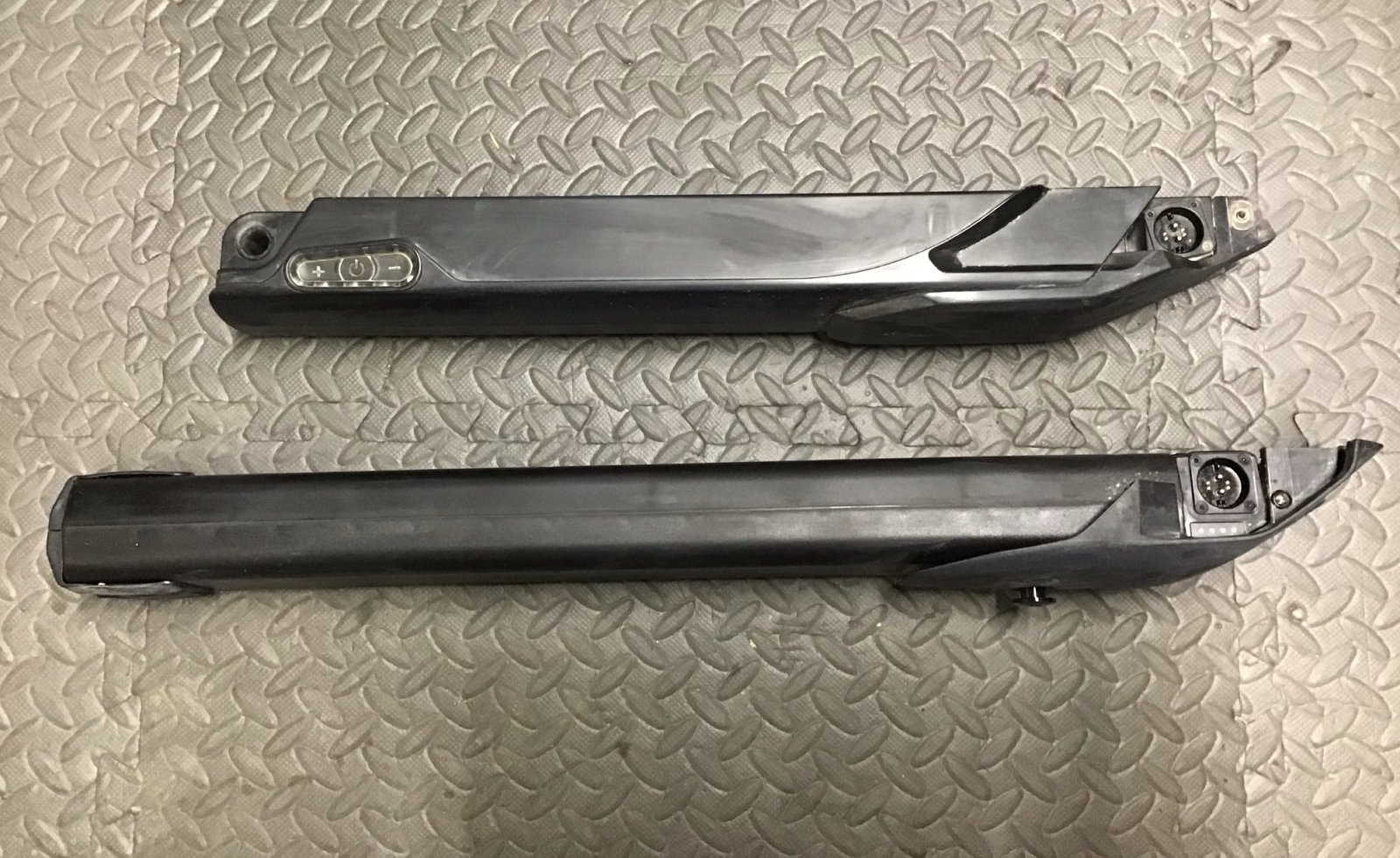

I'm about to buy a levo HT 2019 with a M1 - 400 wh battery. If I want to buy another battery will the 504wh battery fit in it, as I can't seem to find any 400wh original replacements ?

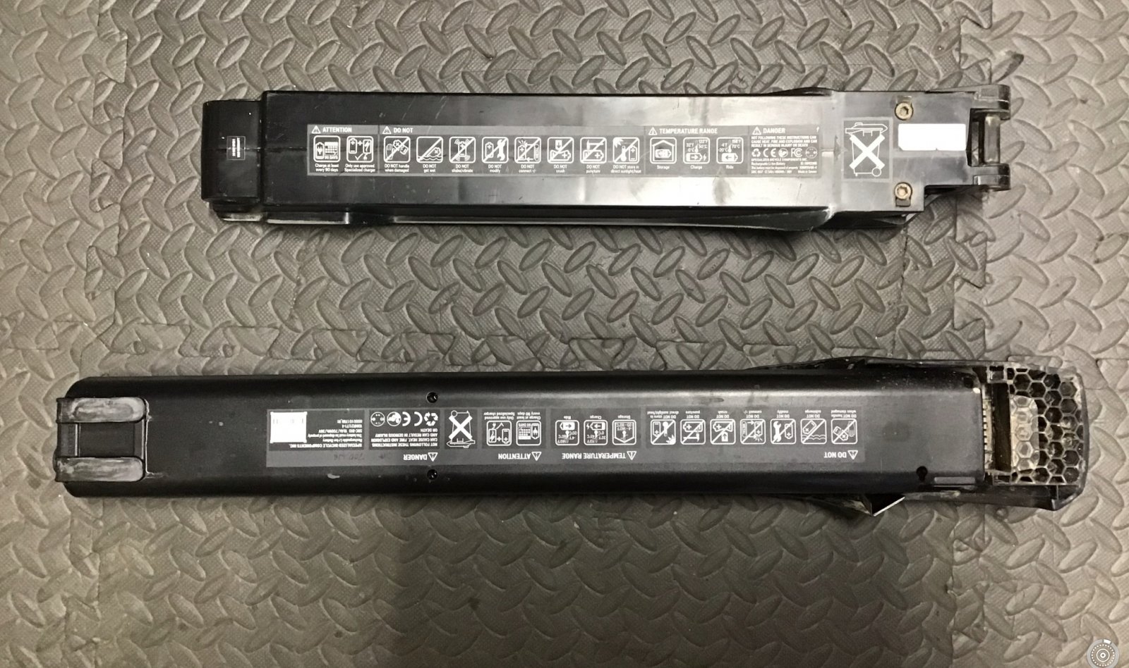

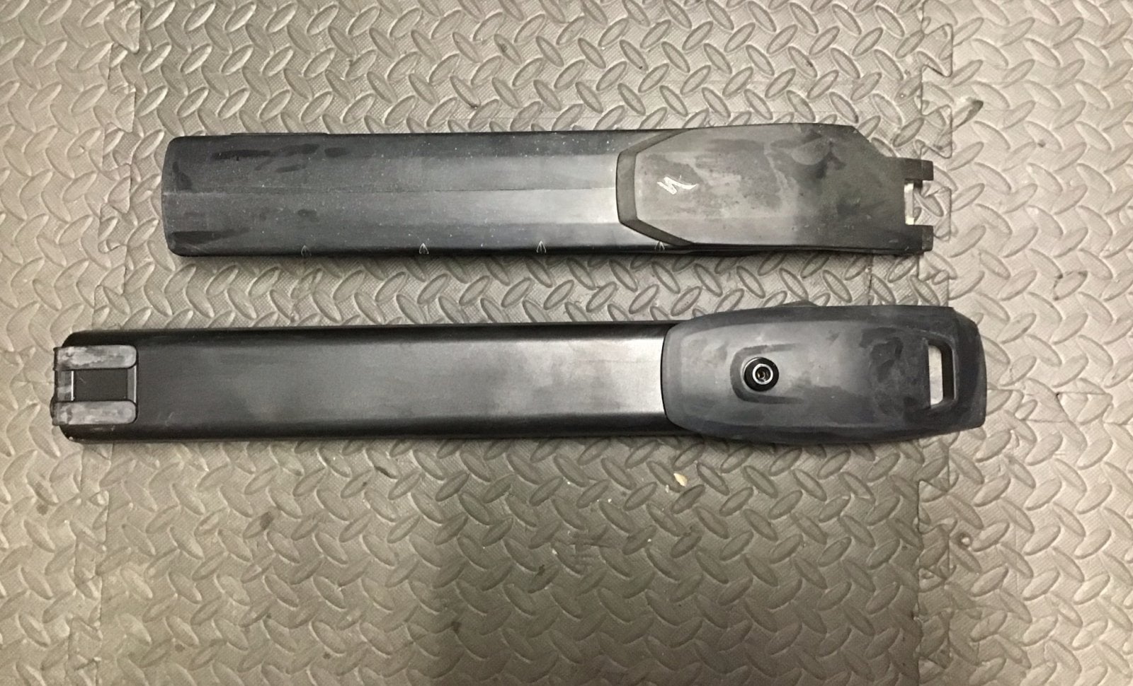

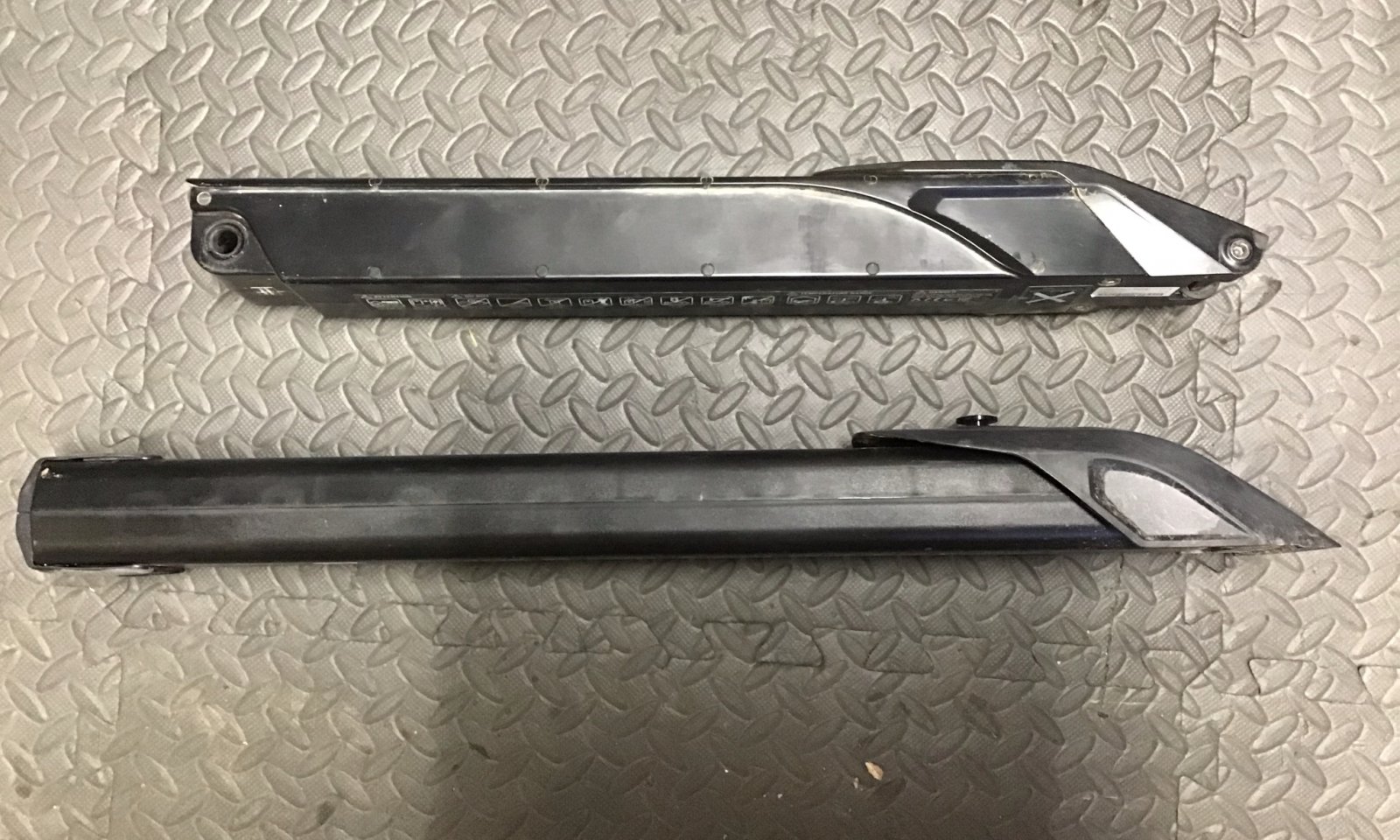

Yes it will fit, but make sure you order the correct battery as it is the 504Wh you require and not the newer 500Wh battery.
You need to purchase the battery in the top of the photo. This will fit 2017, 2018, 2019 Levo HTs, 2016, 2017 and 2018 Levo FSRs and 2018, 2019 Kenevos. The other battery fits the new shaped 2019, 2020 Levo FSRs and the new 2020 Kenevo.

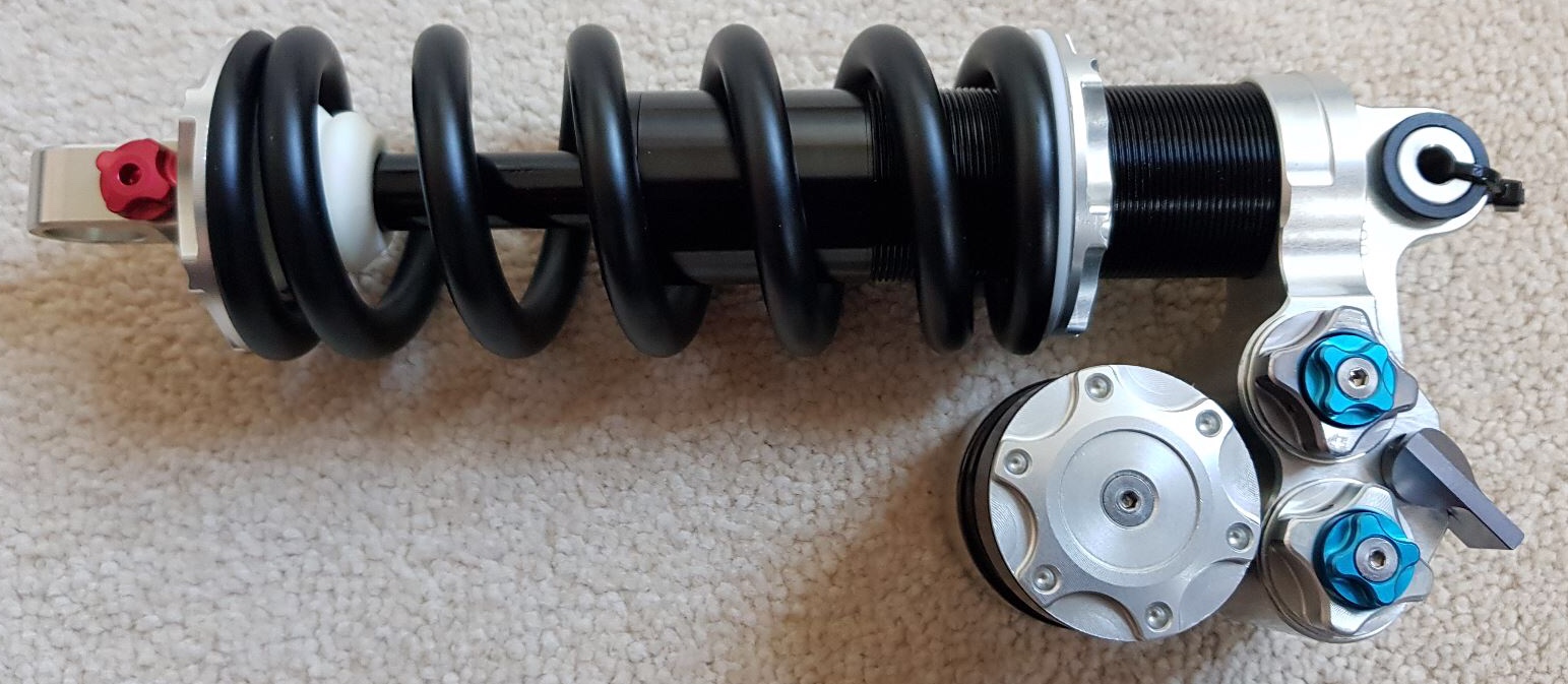

Fitted this the week before Christmas. However....... got a call from TF tuned saying..... Cane Creek have been in touch with them and have said that they do not recommend that you put a DB IL Coil on your 2019 Levo or 2019 Stumpjumper as they are worried the shaft of the shock may snap near the rear eyelet due to the increased leverage force created by the yoke.
So..... I am sending the shock back to TF Tuned who are happy to give me a refund and we are working on 'other' possible options.
It is a real shame as I have been for 3 rides with the new coil shock on and compared to the standard air shock the new coil shock in my opinion is far superior especially on the terrain I ride :cry::cry::cry::cry::cry:

As you may already know, what you read was an old post and Cane Creek have now upgraded the IL coil rear shock shaft so it can cope with the Levo’s high leverage ratio.
When I purchased the ‘non Levo ready’ IL coil shock from TF tuned they adjusted the upper eyelet by I think 45 degrees when they built the shock up for me. Not sure how they did it sorry. But feel free to give them a call to find out.
