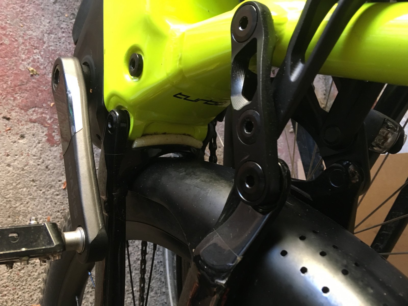

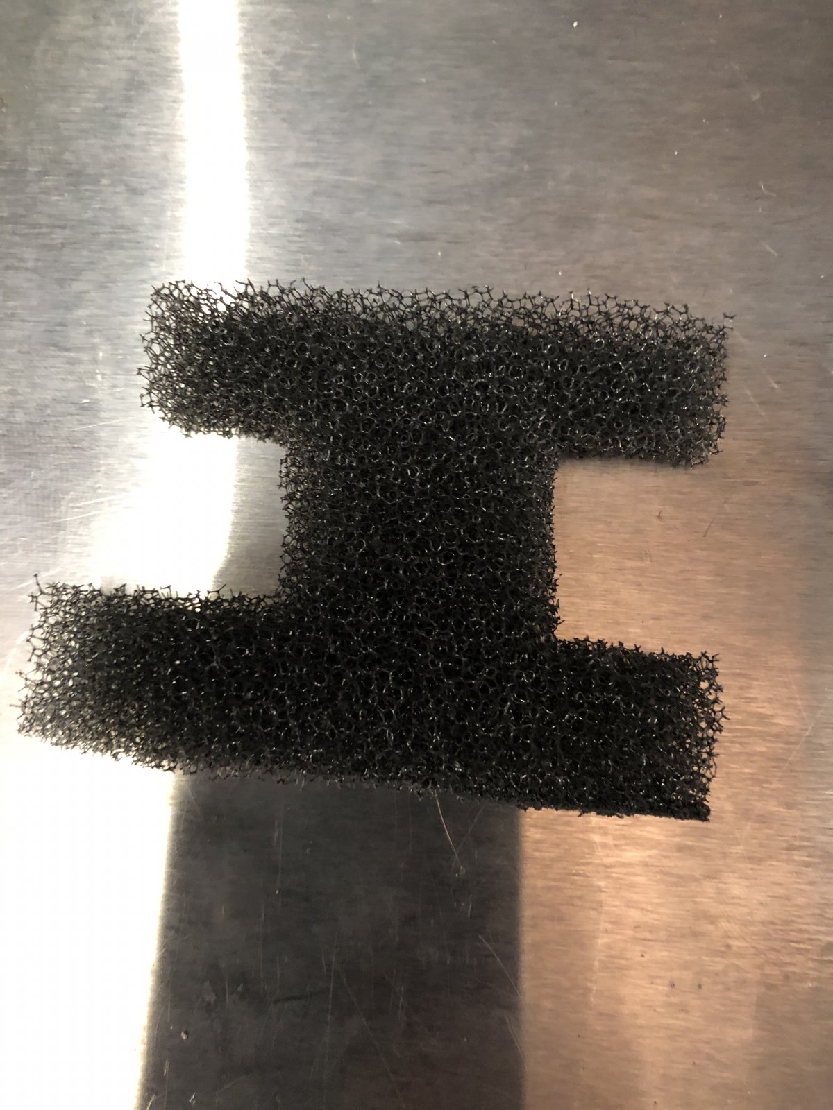

I put a piece of scouring pad sponge in the gap between the swing arm and motor housing and fitted a a front mudhugger as others have, I also filled the motor casing gap with silicon grease.
My first 6 week service with 350 miles found 1 pine needle inside the motor casing, probably as the first few rides had no protection.
Simple precautions and no worries from my perspective

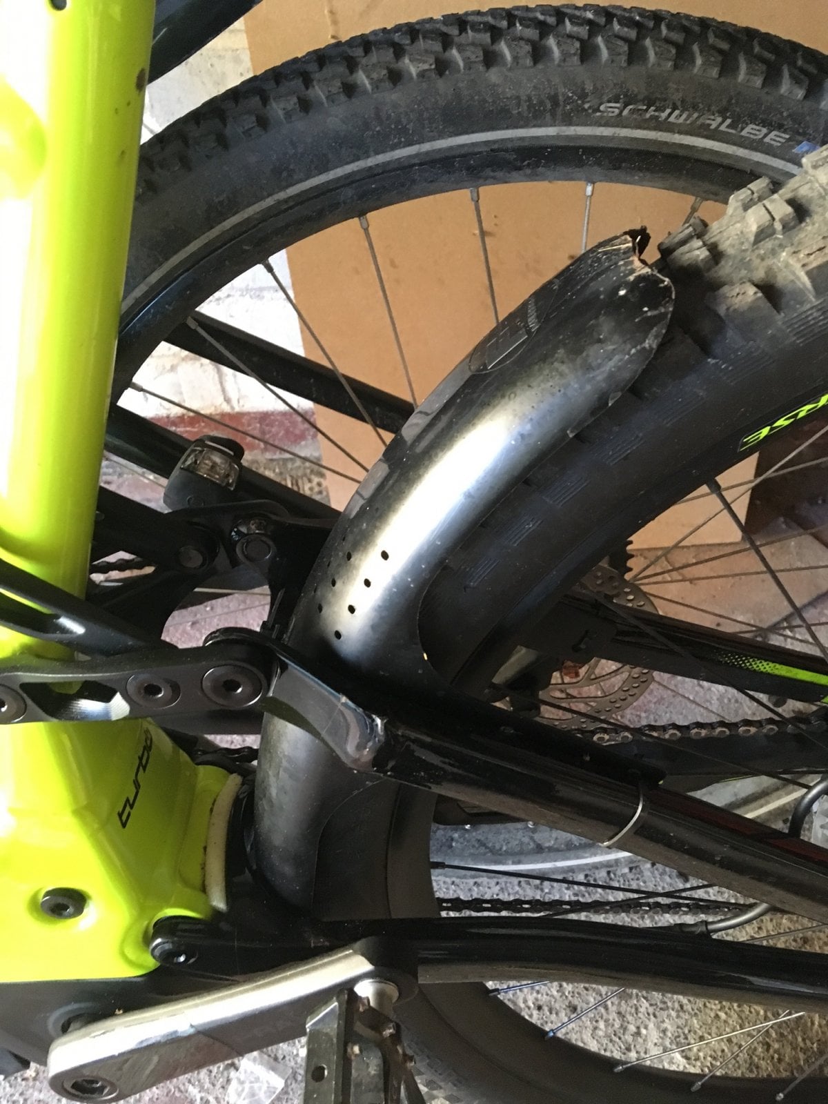

Is the mudhugger on the rear tire? Which one did you get? Just push the sponge in the gap? Did you also put a small sponge over the drain hole that is under the motor on the bottom of the bike also?

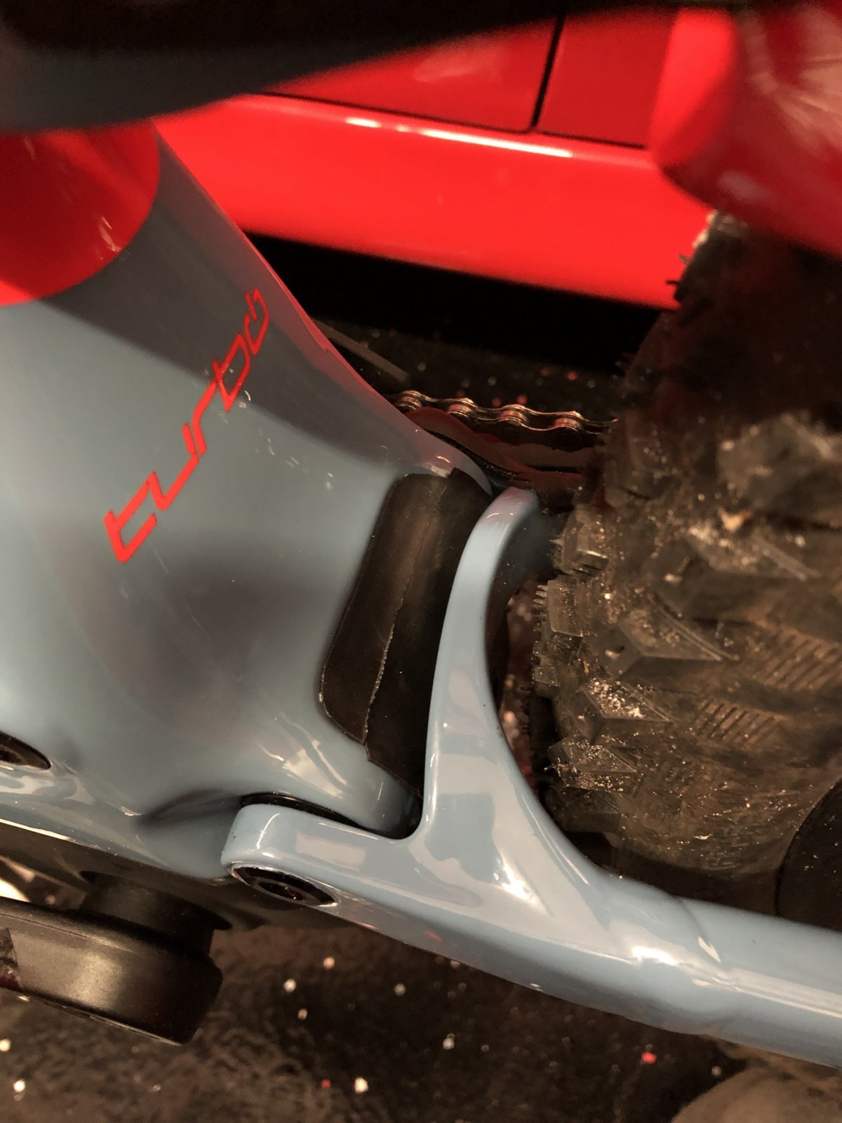

Large front mudhugger fitted to the rear, only a small mod of removing the lip and adding extra holes.
The sponge is jammed into the recess of the the cross member of the rear link adjacent to the tyre. I will add a pic tomorrow.

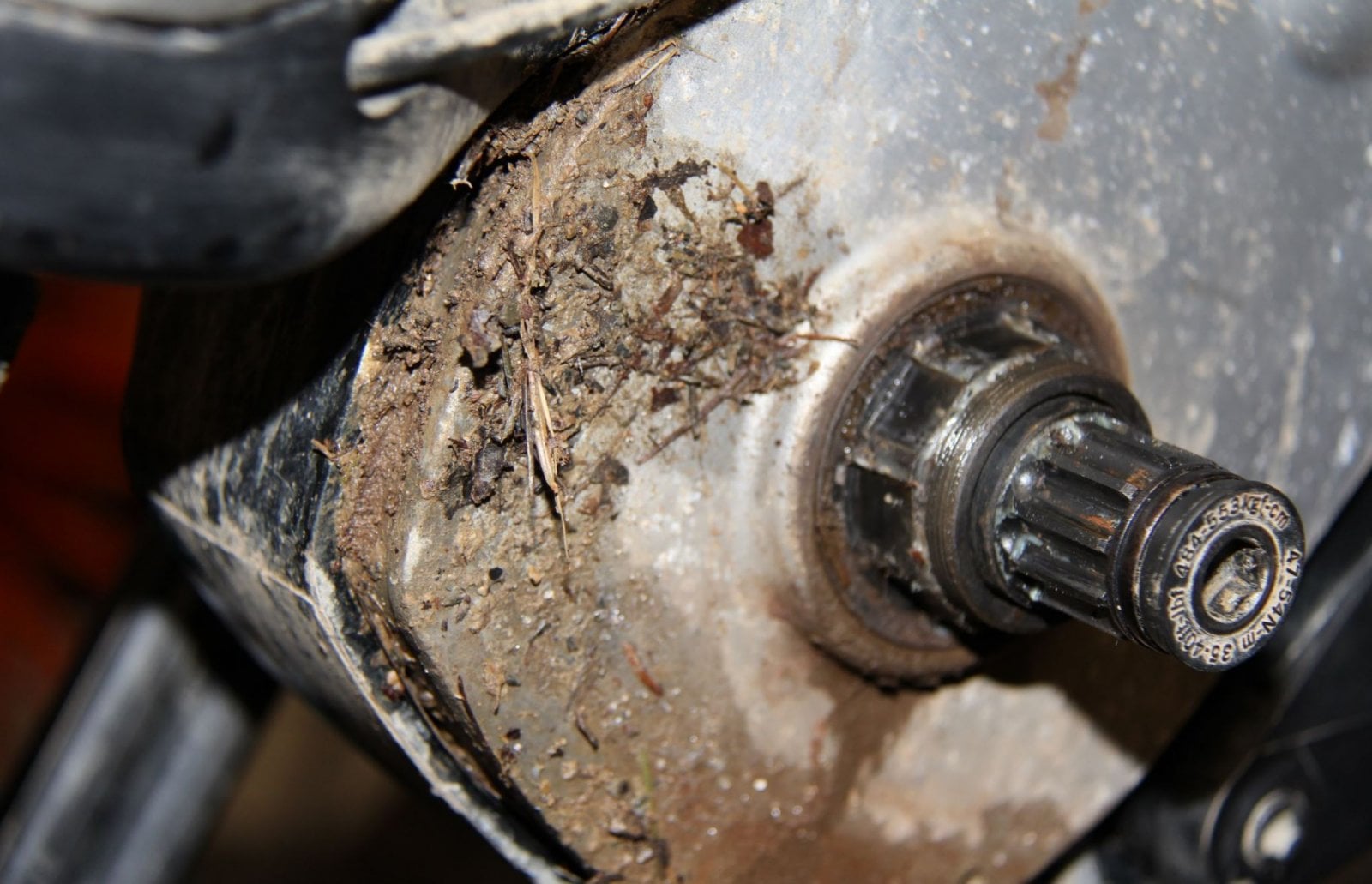

You must have a very clean forest ?

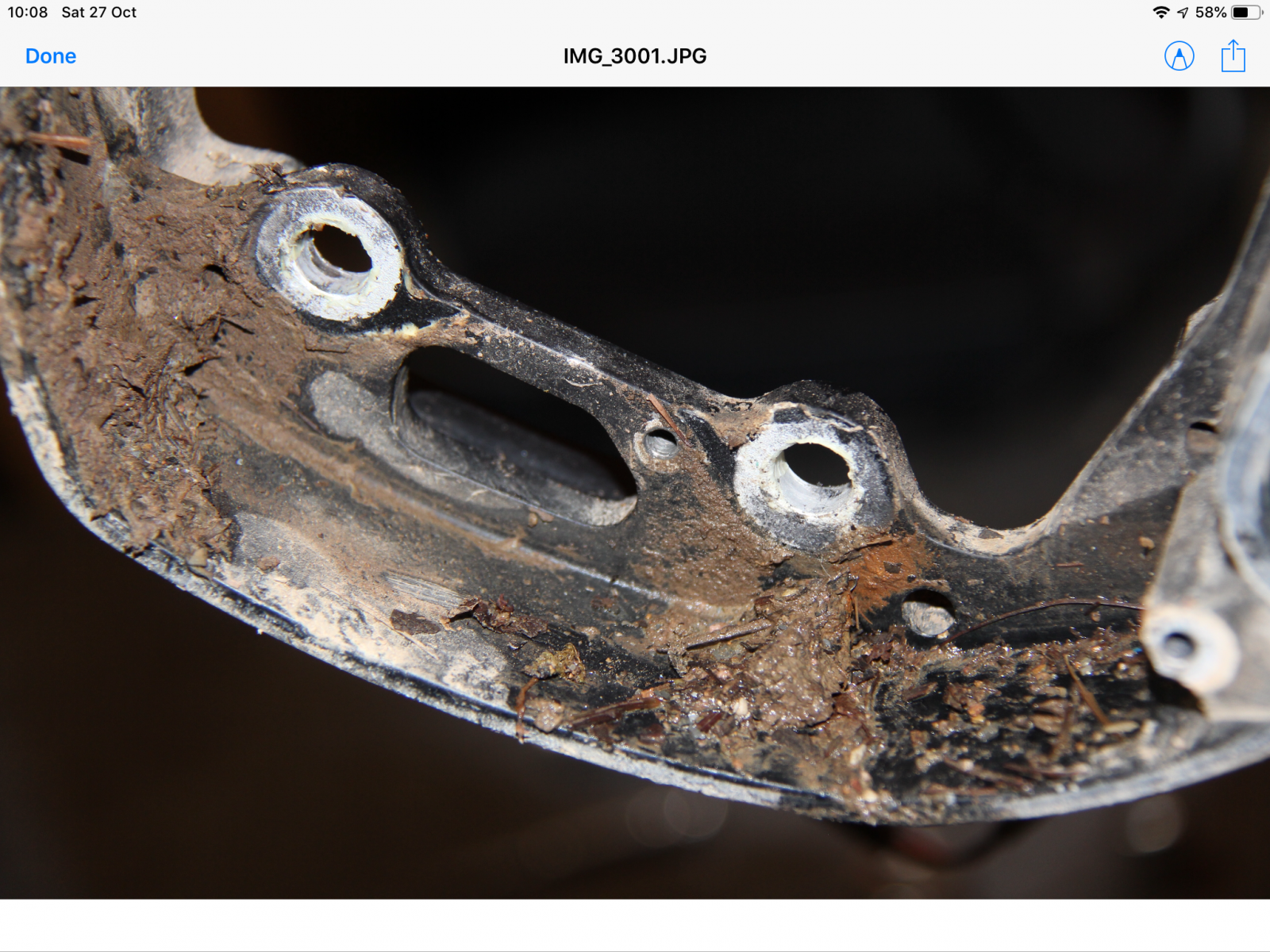

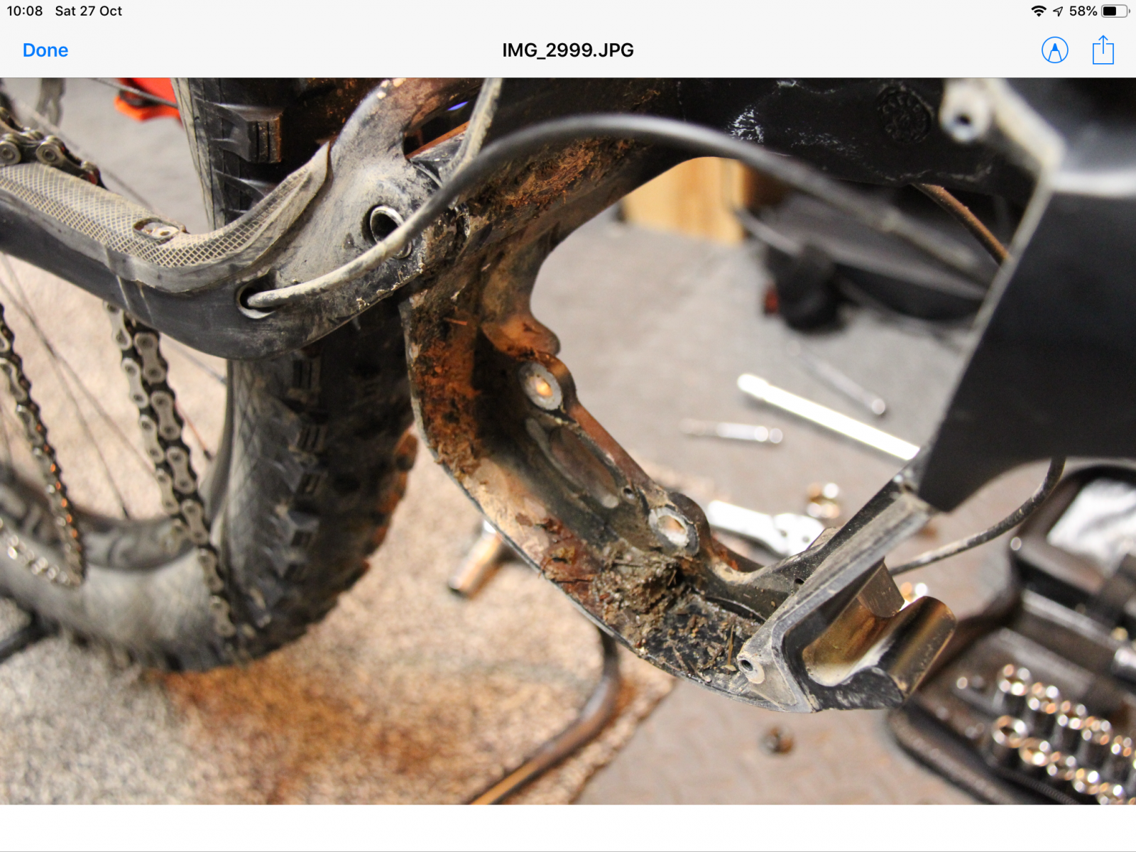

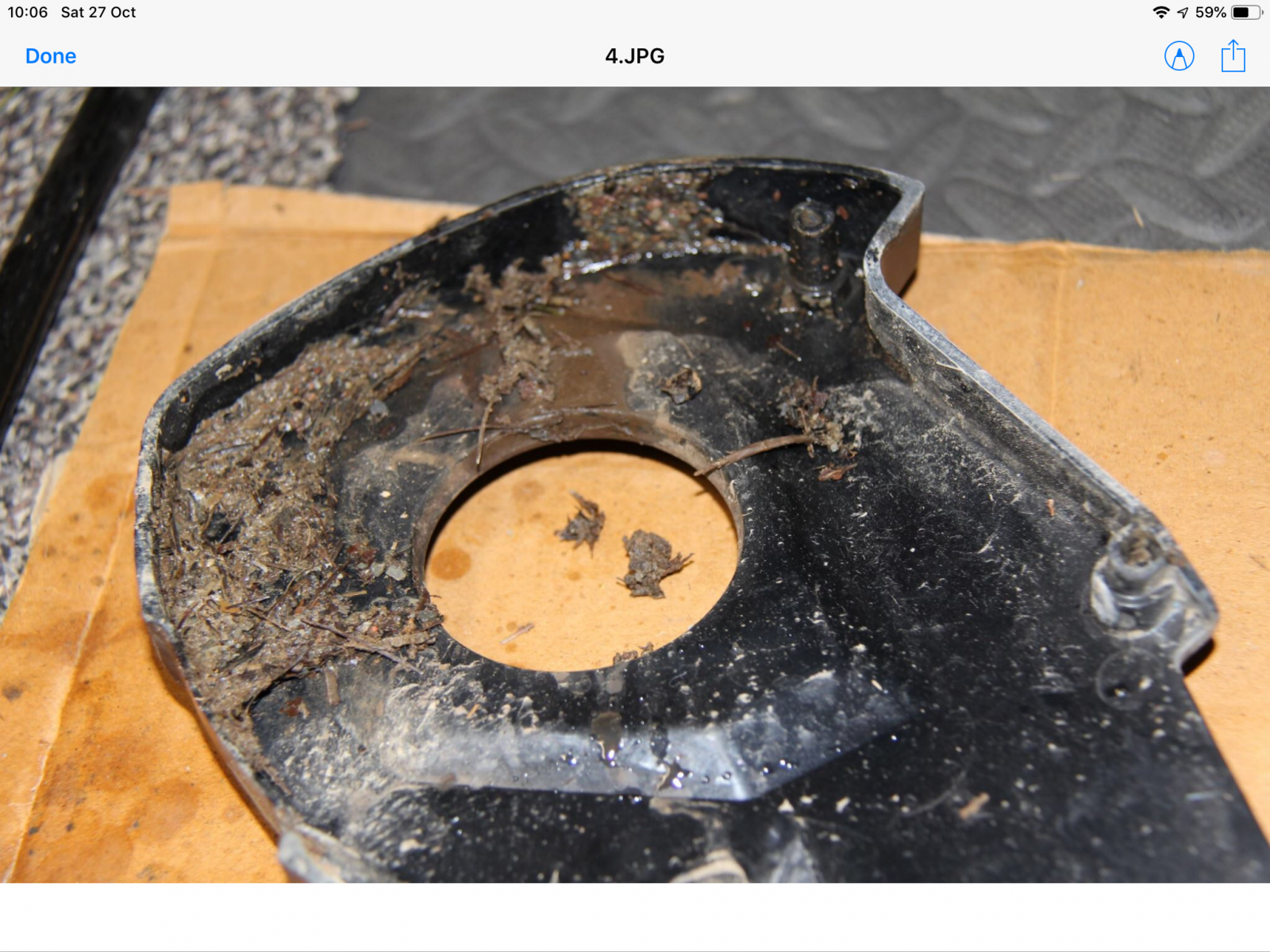

See below, This is 3 months in the Brechfa forest with my pre 2017 Levo before I used the MX foam fix on all the openings/holes. No issues with any ingress these days. The only thing that gets in is filtered muddy water which runs straight out of my sump hole ?
View attachment 7913 View attachment 7914 View attachment 7915 View attachment 7916 View attachment 7917 View attachment 7918 View attachment 7919 View attachment 7921
WoW!
Trust me, our forest is no less muddier/wet/needles than yours - Yours is a Alu frame right?
Mine is a Carbon and all the covers are very very tight on the motor compartment, only place where any type of dirt can get in is via the drain hole at the bottom - Could there be differences between the Alu and Carbon frame?

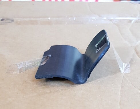

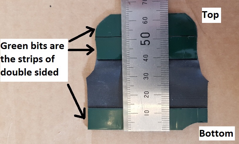

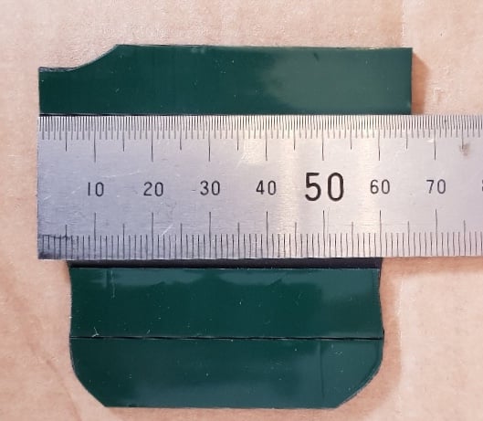

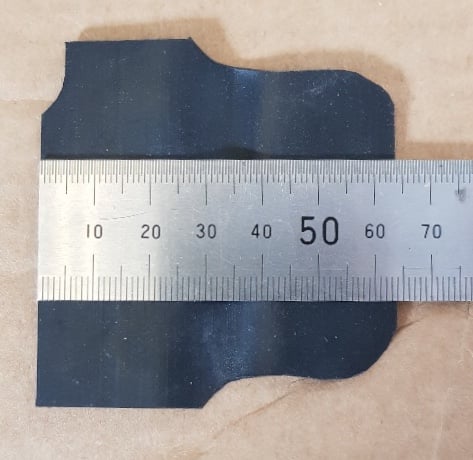

The 2019 Levo may be flawed on the dirt, leaves and mud ingress front but my slightly modified #1009 fix works a treat?.
My specific mod to the #1009 fix was to make the bottom half of the flap 5mm wider on each side which in my testing makes for a much better seal.

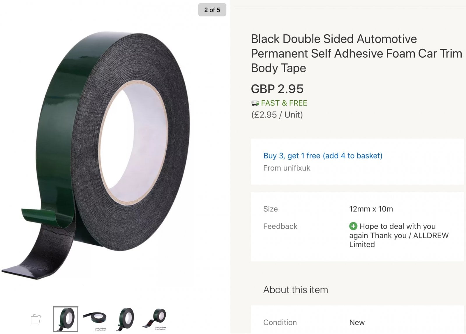

I used an old DH tube for my material. It is around 1.5mm thick. Feel free to use something thinner if you so wish. Make sure you clean the rubber thoroughly with isopropyl alcohol before fitting the double sided tape to it.
Removing the swingarm makes it a lot easier to fit too.
Yes, I know it should have been picked up by the design/testing team...... ?
There will also be some out there that do not have the time or the skill set to do what I have done and will quite rightly expect Specialized or an LBS to do the work which is fair enough because it is a valid issue.
However, ‘it is what it is’ this fix works for me so I am a happy chappy ?
If you get a chance ride a 2019
Compared to the 2017 and 2018 models I can assure you that the 2019 will not disappoint you.
Please note and see the photo below
I cut the DH tube so it had a natural bend in it as it attaches to the frame more securely as the part of the frame you attach it to is also curved. The sellotape is purely for display purposes as I couldn’t get it to sit the way I wanted it to ?

For sure Karsten, they are different, there is a 2cm x 2cm hole at the back which is where all the muck got in. You can sort of guess where the hole is because that is where loads of the dirt ‘build up’ is

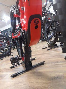

beautiful sticker whee did you get it?How have you removed the with one?
an Italian company produces them, this is their website:
Specialized Turbo Levo FSR 2019 - kit adesivi telaio
they create the graphics as you want.
I'm sorry but I did not understand what it means:
all the stickers cover the original graphics, I can remove them whenever I want. the bigger one also protects the frame

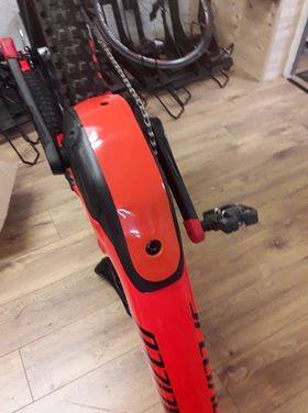

Is there an update on a similar solution regarding the big hole directly into the motor compartment on the 2019 Turbo Levo HT? Riding conditions are deteriorating in my area and the bike is basically covered in mud/debris even after a shorter ride. I have covered the hole with gaffa tape for now but by no means an elegant solution. Another question, why is the drain hole only a 8 mm round hole when you have this 10 times bigger hole at the top? You don't have to be a rocket scientist to realize what is happening if you are watering down your bike after a dirty ride and you point the water hose in the area just in front of the rear wheel where the most dirt collect. If you are not extremely careful where you point the hose, you can simply fill the motor area with water/debris very quickly as the inlet is 10 times bigger than the outlet. Flushing down dirt will even likely plug the small 8 mm drain hole and amplify the risk of flooding the motor.
A few more pics of the big hole into the motor:

Have seen some cut the “front” of the mudhugger fr off just about the logo and insert that down rather the way you have done it (there is a vid on you tube showing it)
Did your way fit ok and does it just protect the bike or you also?
Any further drilling of the mudguard required or clogging issues?

Nothing in drain hole, potential to retain water.
The sponge is just pushed in.
View attachment 7964 View attachment 7964 View attachment 7965
Thanks for the post
It looks tight between the guard and tyre, I’ve had no issues.
Added a couple of holes and removed the lip by filing it flush to the id. No shortening required.

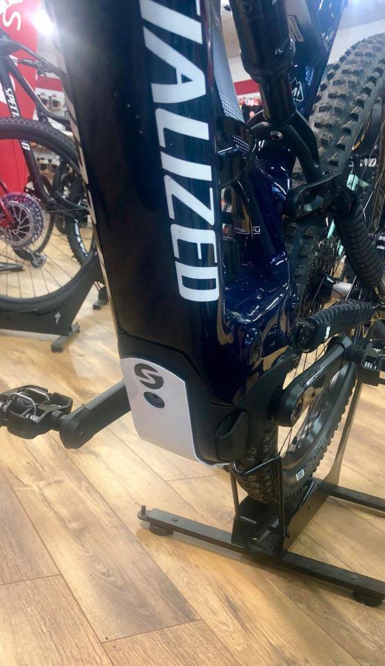

These look great ? Which one is yours? Type 1, 2 or 3?
Can you possibly do some close up photos and post them please?

After only 60 miles of riding in mixed conditions, I had a ton of sand and pine needles in my engine cover. I just did the sponge mod per specialized and added a flap above the gap using an old tube secured with 3m double sided automotive tape. I left the drain hole open. I used foam from a shop vac filter sleeve. Kind of ridiculous to have to do this on an $8k bike!
We’ll see how well it works.
