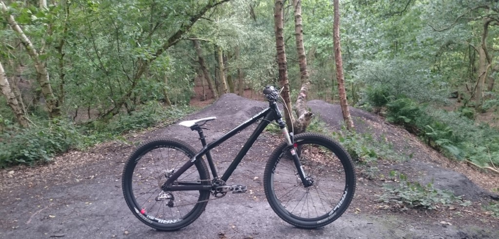

Haha...
Just for you
250mm dropper FTW ;)

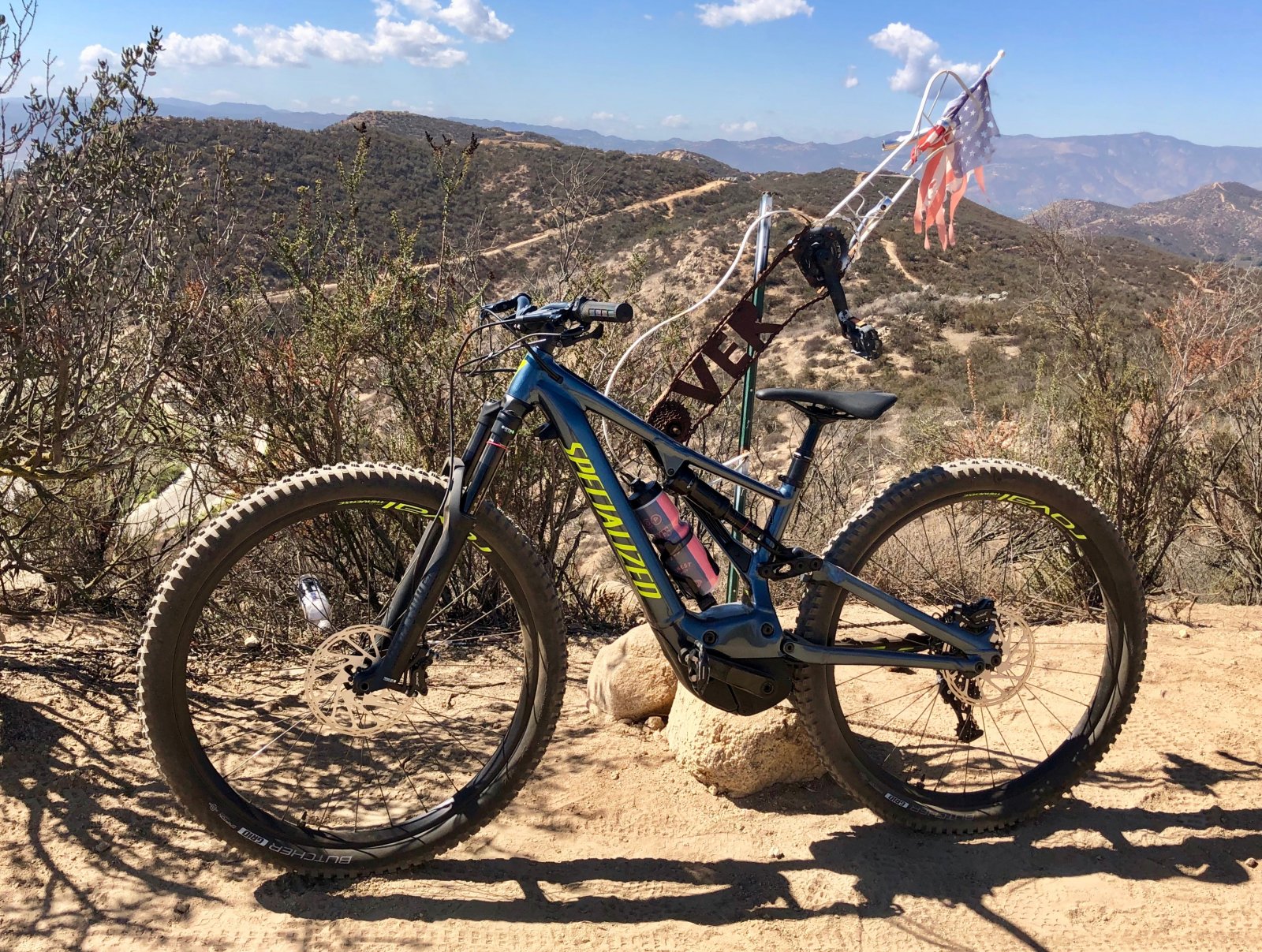

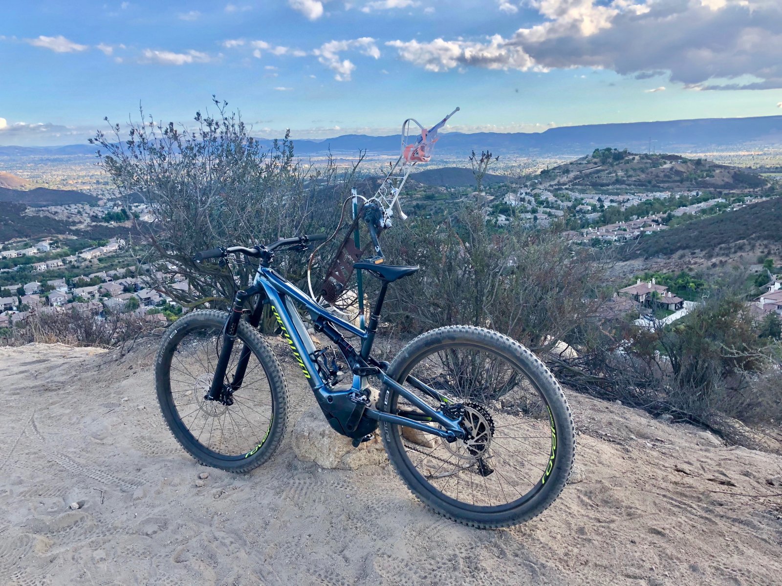

Saddle up...
Saddle down...
Btw, after a few rides, I think the Rockshox Revelation fork probably isn't cutting it as I initially thought..any recommendations?..or any adjustments I should be making. I had my LBS set the sag (as I am clueless on how to set it) based on my weight and height. But I feel like I'm bottoming out after jumps or drops. That red rubber band on the fork are pushed all the way up after my rides. Thanks.

How much better does your bike look with the saddle down!!! :)
Seriously though, your forks have marks on the stanchion in % of sag.
You set your air pressure so that when you are standing on the bike in a balanced riding position, those legends line up with the lip of the dust wiper (you need a friend/partner/servant to help with this). If you do mostly DH, you want it set somewhere between 30-35%, for a more trail riding setup, go for around 25-28%, it says it clearly on the fork leg, you can't go wrong, that's the first step.
Now if your using too much travel, which is easy to do with the Debonair spring due to the positive/negative air chamber size ratio, add volume spacers.
You should have three volume spacers that came with your fork/bike, i'm positive you'll sort it with just that, but if it's still not supporting you enough with all three spacers installed, increase compression damping a bit at a time, that's all there is to it.
It's all about experimentation, and don't be afraid to have a go because the only mechanical thing you need to do is let the air out, remove the spring side top cap, put a spacer or spacers in, replace the top cap and pump it up again, which if you have the right tool and a shock pump, is literally a two minute job.
You definitely do not need to change your fork, unless you need more/less travel, stiffness, looks or any other attribute a different fork can provide, the spring and damper tech in the Revelations is as good as you'll get on anything else.
Stick with it and have a play, if you get stuck we're all here to help :)
