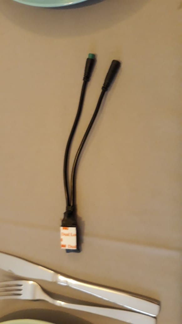

Instructions posted for reference ?
  • Levociraptor - Install .pdf

No need for a fix, It does work as advertised. There was just a common misunderstanding of how it works with BLEvo. BLEvo will Display the correct speed in the app if u set the right multiplier example at levociraptor stetting 3 u use multiplier 1,5. Do not forget to put in your real wheel circumference ex. For 27,5 2220mm. The mileage recorded in the engine how ever will be false ie lower because it the engine thinks you have. 1300mm wheel (that’s the whole point of levociraptor)

Which Speedo are you using ? The specialized one ? Paolo from BLEvo has answered this already if u make the effort of looking back a few pages. All speedos getting information from the TCU (so from the specialized hardware inside the the bike) will NOT display the right speed. I think you don’t understand this. the right speed is only displayed in BLEvo with the multiplier setting. And why are you not able to set the right 29er diameter in BLEvo ???? That works without a problem.
