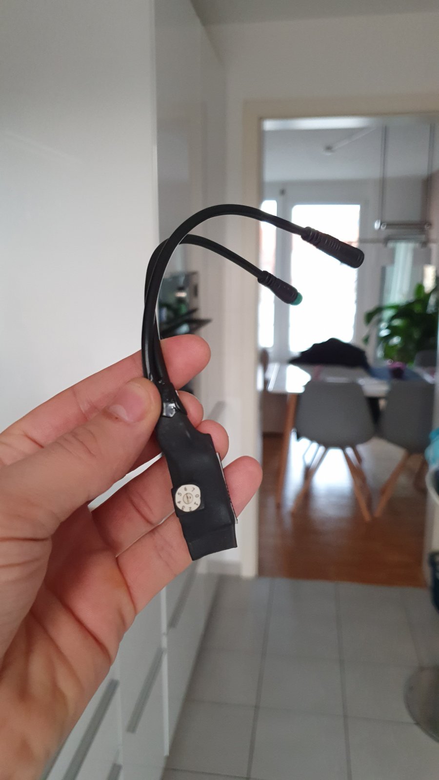

BTW, as a future improvement, wouldn't it be nice to be able to control the dial via bluetooth, or at least being able to by pass the hack remotely. This would allow us to use the TL in restricted mode most of the time and activate the levociraptor only when we need that extra bit of speed.
BruDahl
Nov 14, 2019
should be 4-10 days
Just arrived! ?
Will test it later this day

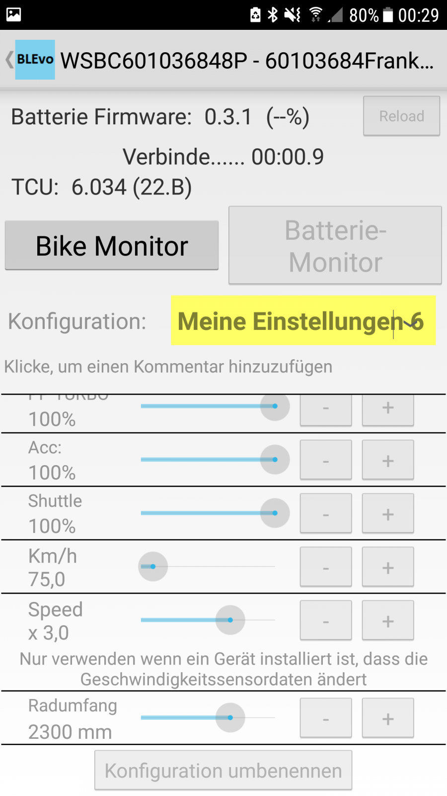

Maybe you can help.I follow the instruction guideline, but no reaction.Raptor Position 6, wheel diameter 29 " with 2300.Attached s screenshot .After instalation 2 times on off. Thanks for your support and a happy Monday.?
Please follow removal procedure and retry. Often setting to 3 on dial on 1st install will meet with success.
As far as I can see - I cannot see any problem on that screenshot.
You have told BlEvo that you use a speedunlock system which is set to fake-factor 3. BLEvo tells you that the speed limit now will be 3 x 25 km/h = 75 km/h.
The real wheelcircumfence is (and will stay) 2300 mm. BLEvo needs to know the real circumfence for recalculating real speed and distance.
The only thing you have to do now is to try out if you have motor support up to 75 km/h - good luck with pedalling! ;)
@BLEvo specialists: please tell me if I‘m wrong.
Perfect answer. Thanks a lot..

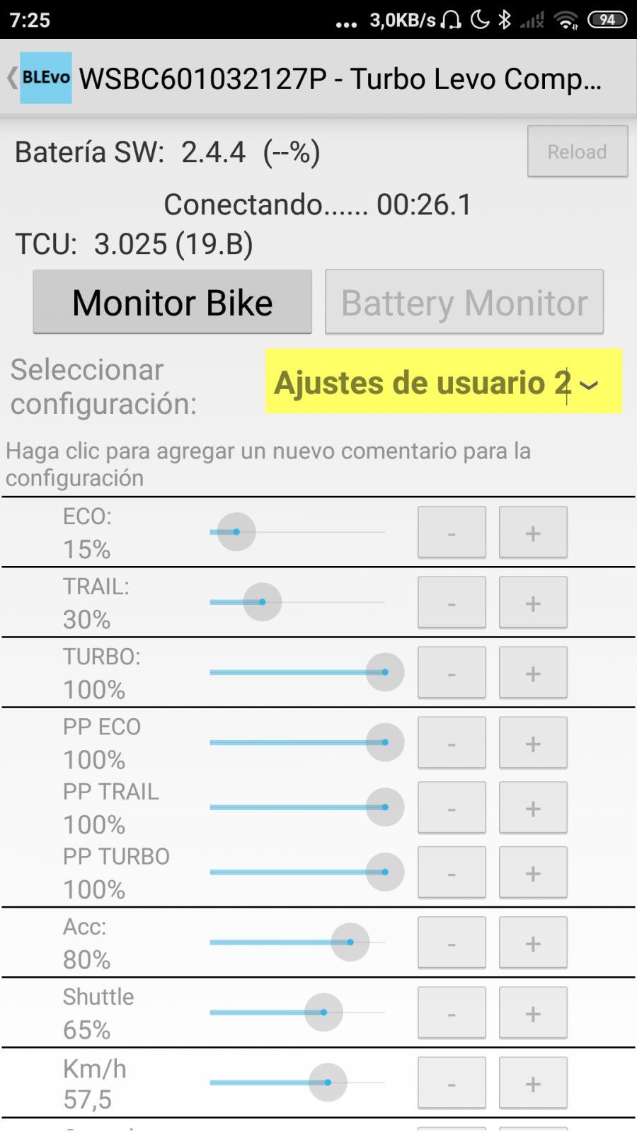

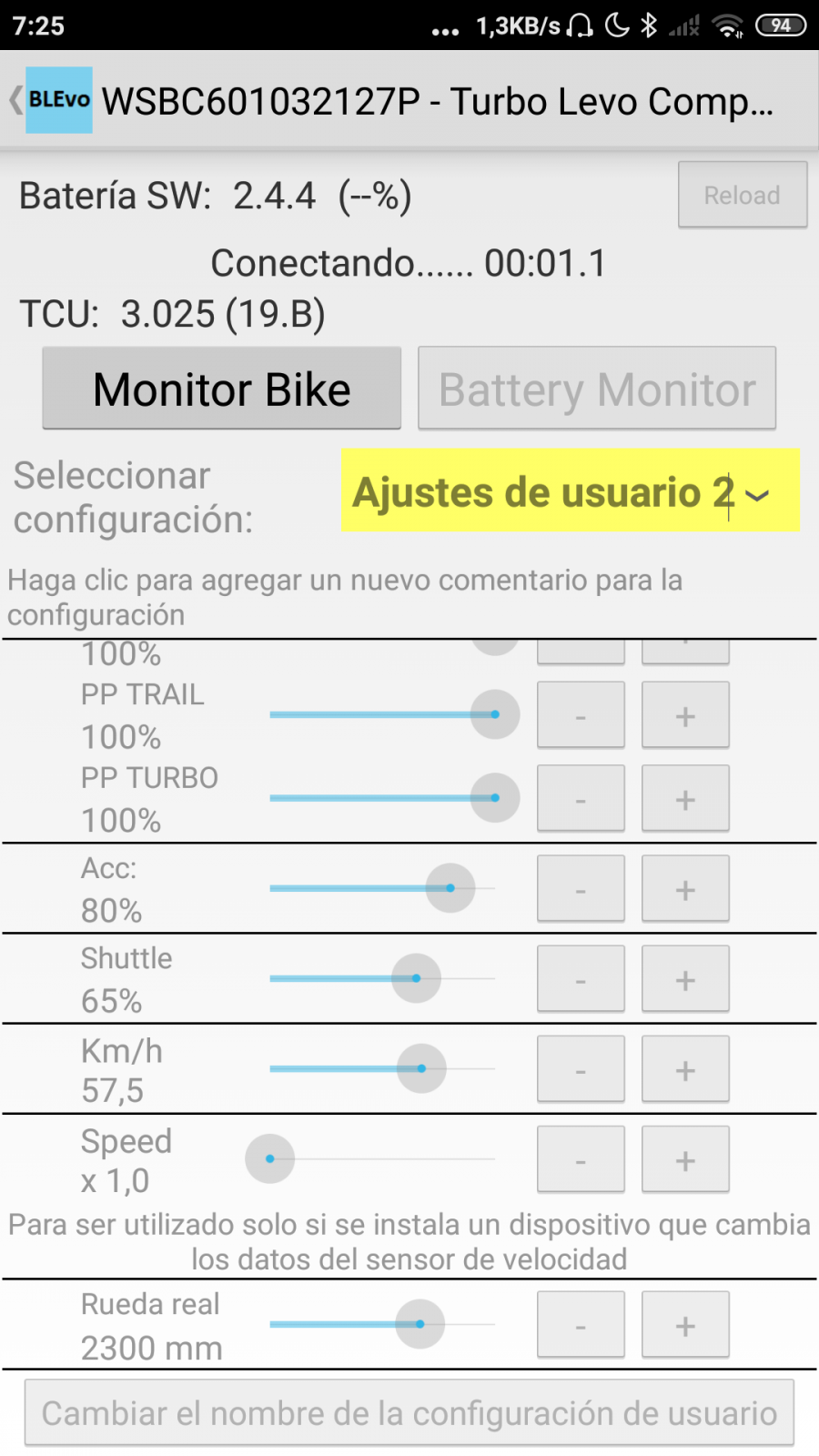

I have received mine. What a difference it makes !, going to the trails on paved roads at 30-35 km/h instead of 26 makes all the difference.
I set the selector at 4, and strangely, the only way to get the correct speed reading in Blevo is setting the Speed X1. The wheel size is configures with the real value (2300). Does it make any sense?
Very strange.. could you post the bike setup configuration?

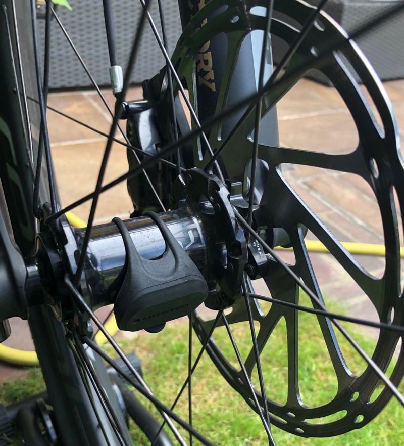

You also can spend a 40 bugs and get a Garmin hub-speed-sensor und you will get precise speed readings and recordings (and you can use „autopause“).
levociraptor installed on my Comp 2020 ! wonderful!...
I have a garmin 530 ... I don't want to disable the ebike sensors (I want to see the battery level!) without fake channel ... if I install a garmin sensor .. is the speed displayed correctly? or does the 530 take the data from the ebike sensor?

You are right.. The TCU version 3.025 doesn't correct the wheel size, so you need to keep the Speed Multiplier to x1. If you will update the TCU firmware, you will configure also the Speed Multiplier.
Thank you. Any know advantages of updating the firmware or should I leave it as it is?
