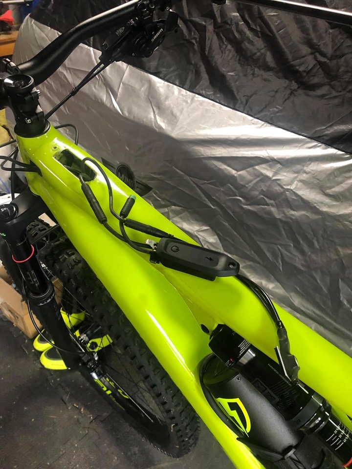

Hi,
So it will work on my Turbo Levo Comp 2020??
How difficult is the installation?
How could it be (de-) activated?
Can't really help you with that one, but other (2020) Levo owners are saying yes
10 minutes (if you take your time) it's a pretty foolproof installation. Comes with a PDF (also posted on this thread somewhere) that's clear and easy to read.
Remove the TCU, turn the dial back to the default setting for your wheel size, re-initialise, job done. Again a 10-minute job.

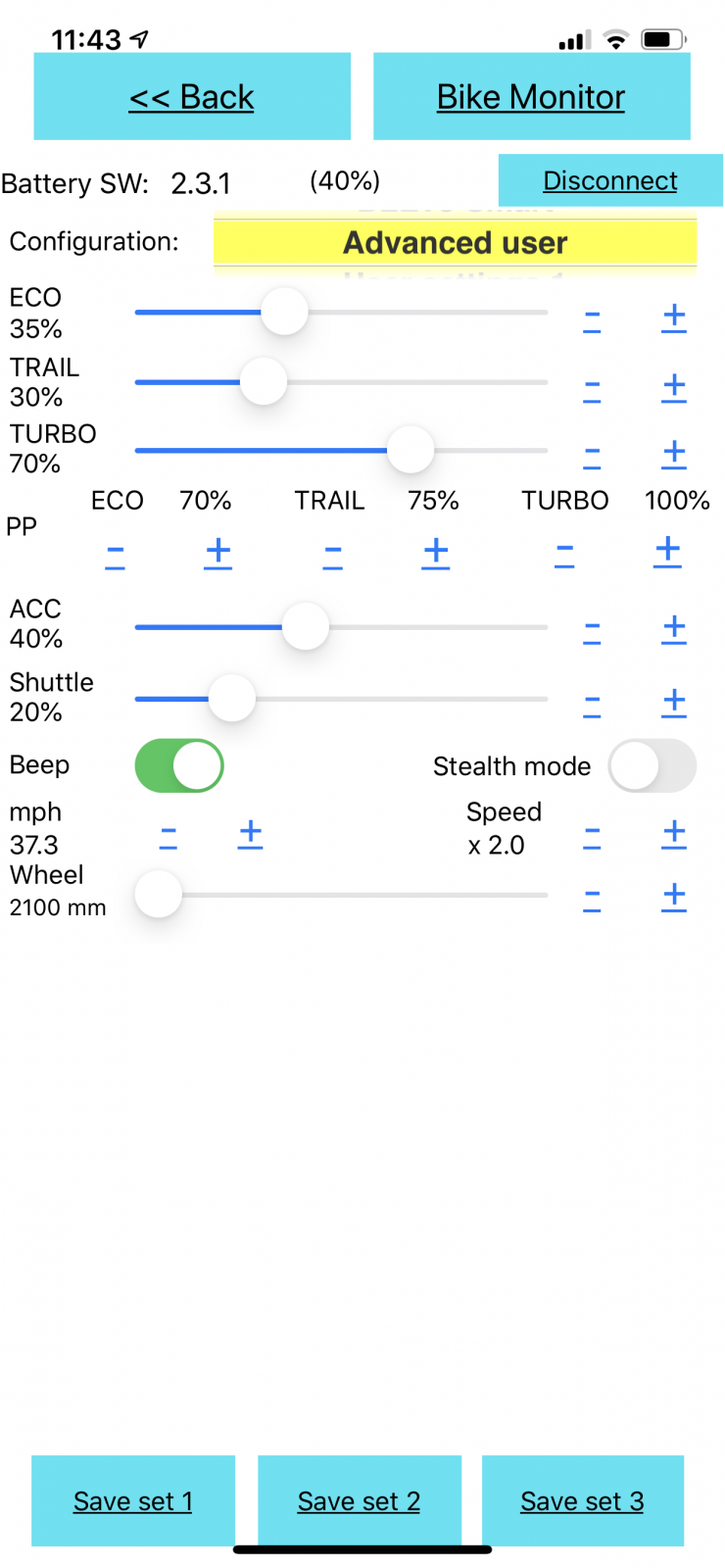

I have mine set on 4 it’s very good but I cannot adjust to correct speedo reading can any one help please. I have the turbo levo speedo.
Have you followed the chart within instructions regarding speed multiplier within BLEvo app.
jeeter333
Jun 18, 2019
usa
You have set the multiplier to x2 then adjust your wheel size below the multiplier to your specification.
So he would set his Levocoraptor dial to 4, his multiplier to x2, and adjust rear wheel circumference to actual? That would take him up to 36mph assist?
For 27mph assist would it be dial to 3, multiplier to x1.5, and rear wheel circumference to actual?
Thank You for your patience.
Snatch
Aug 18, 2019
38
9
Warwickshire
I cannot drop the wheel size to 2000 the lowest setting is 21000 ?
