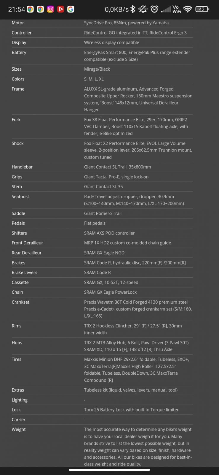

Giant Reign E+… 2022, 2023 & 2024 models are essentially the same bikes. Subtle exceptions are on components and battery that went from 625Wh to 800Wh, everything else pretty much unchanged (frame, geometry, motor…)
Great bike! 👍
