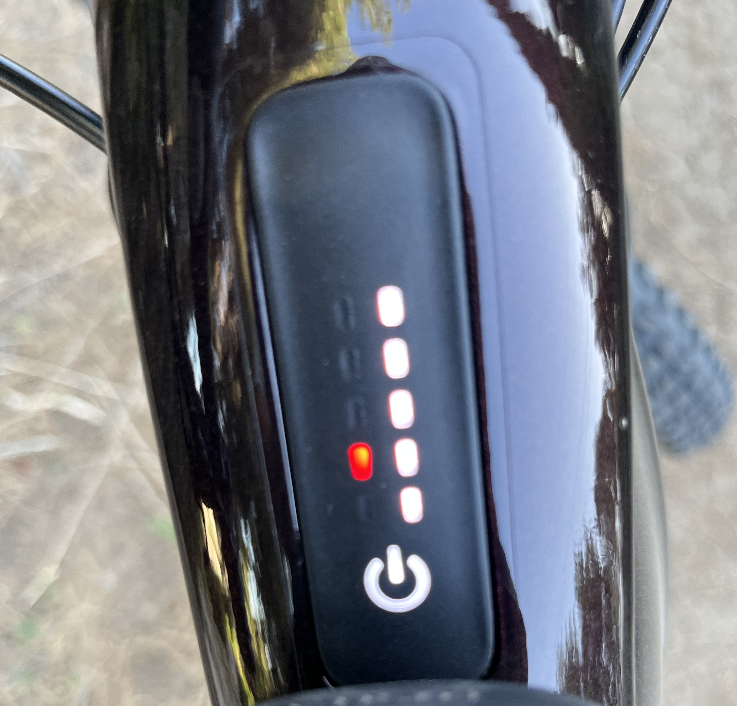

Not sure what is going on, but this morning I had the L2 led, second LED from the bottom on ride control flash red. This happened on a climb and after a long descent. Temperature outside was around 80F. I would power off the bike and power it back and continue. This occurred 3 times. Anyone else experience this issue? Hoping its not a sign of a bigger problem. I have approximately 500 miles and have not had any flashing red LED until today.
From what I read in other threads the L5 led flashing red indicates an overheating issue, which I initially thought was the issue while riding.
System check through the ride control app returns with all green check marks, no issues.

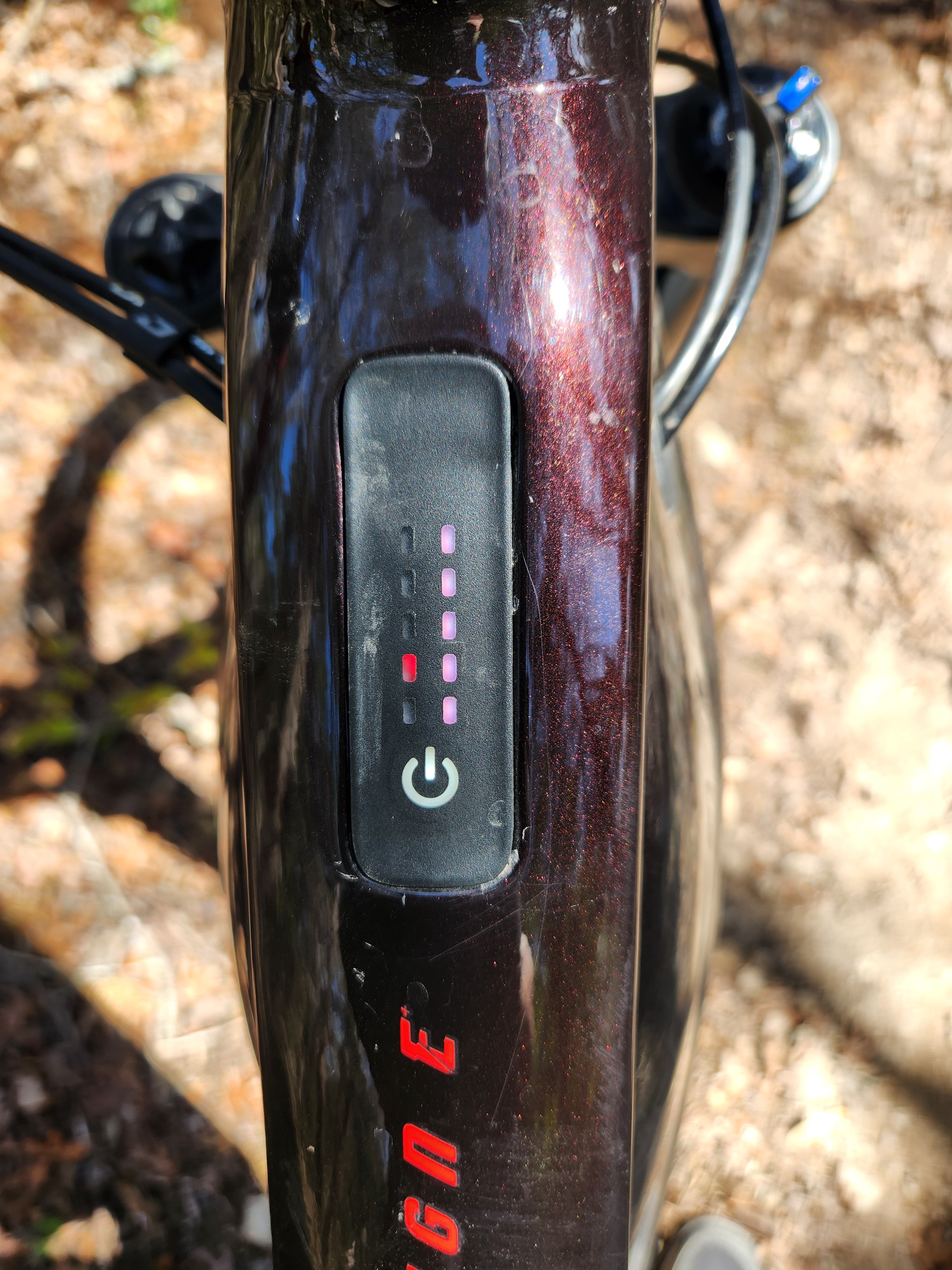

2023 Reign E, happened 2 weeks ago in middle of a ride firs the first time. Spent 15 minutes turning on and off. went away and hasn't come back.

My '23 reign e+ did it 3 times today in about a 15-20 min period, then rode another 2.5 hrs without issue. Mine did something though that may be different.
The first time it shut the support off, the L2 was flashing red along with all of right side leds flashing white until the bike was powered off.
The second time it shut the support off, the L1 flashed red along with all of the right leds flashing white until powered off.
The third time it shut the support off only the right side leds flashed white until powered off.
Then I rode some real aggressive gnarly trail for the next 2.5 hrs, which was amazing, but I was concerned it was gonna shut down completely.

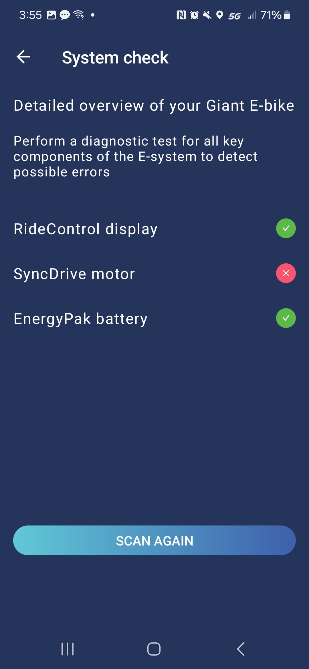

Less than 30 mins into a ride this past Tuesday my bike cut out and would NOT reset after powering off. I attempted to power it off and on at least 15 times, 3-4 times it would clear until I put any pressure on the pedals and then go into r2 fault.
The other times as soon as it powered on it went into the r2 fault. I pushed, pedaled and hiked my 60lb behemoth back to the car. It actually reset on power up at the car so I pedaled around the block and it once again went into the r2 fault about half way. I connected my phone app and ran the diagnostics which indicated that the motor failed the test. I loaded it onto the rack, called the bike shop and drove home.
The next day I took it to the shop and they hooked it up to their dongle to read it off the computer but the technician didn't know what he was doing and it ended up being a fruitless endeavor. He did contact Giant and they gave him some better instructions on how to use the software. So the following day, Thursday, I brought it back to the bike shop but this time I peddled it furiously for about 20 minutes until it went into fault mode, and then it again went into continuous r2 fault mode so I was able to laboriously pedal it back to the shop while still in r2 fault mode and they were able to hook up their dongle, read off the computer and generate a report.
The report indicated that it had gone into the fault 31 times, and that it was experiencing motor failure, which corresponded with what my app had told me 2 days prior.
Friday I was informed that a R/A had been generated, and a replacement motor had already shipped and should be at the shop this coming Monday or Tuesday and installed by Thursday.
Another thing I would like to add is that it seems that my motor makes an additional noise after it is warmed up just prior to going into the R2 fault. It makes the normal electric motor noise but at times, as the motor is disengaging when I stop pedaling, there's an additional chafing sound that comes out of the motor. Not a grinding noise, but maybe like the noise it would make before it started grinding. Chafing is about the best word I can come up with to describe it.
479 miles on the bike.
