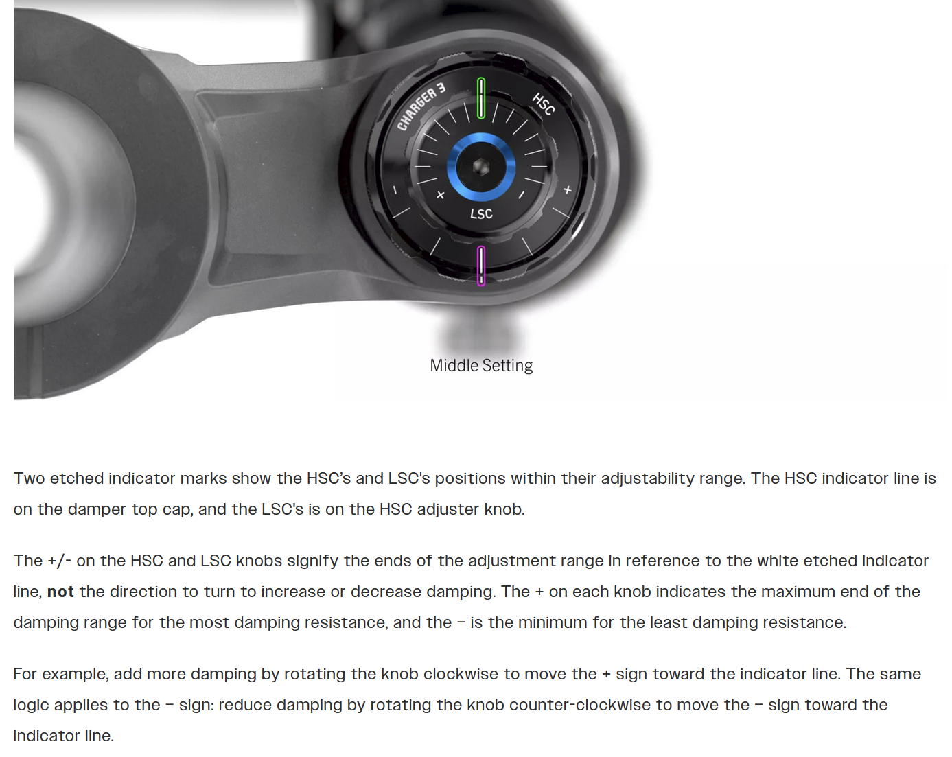

LSC clockwise for less? Don't think that's the case? Below snip is taken from here: Charger 3 Setup - SRAM
Anticlockwise gives less damping on both LSC and HSC:
Before i say what I’ve done i must state i have only been mountain biking since December and still learning the basics ha.
ok so i was re-reading this thread and looked at the above post ,which i had dismissed tbh as the looked to make common since to me , turn the dial all the way towards to - for off .
How wrong that was lol , i had not noticed the little mark on the top of the forks which the dials should line up with to indicate the completion level .
so i had hsc and lsc on full all the time when setting sag and testing on the road,its no wonder i needed 20 psi less than stated lol.
anyways im back to 99 psi with 30% sag and it feels so plush .
what a nooob
