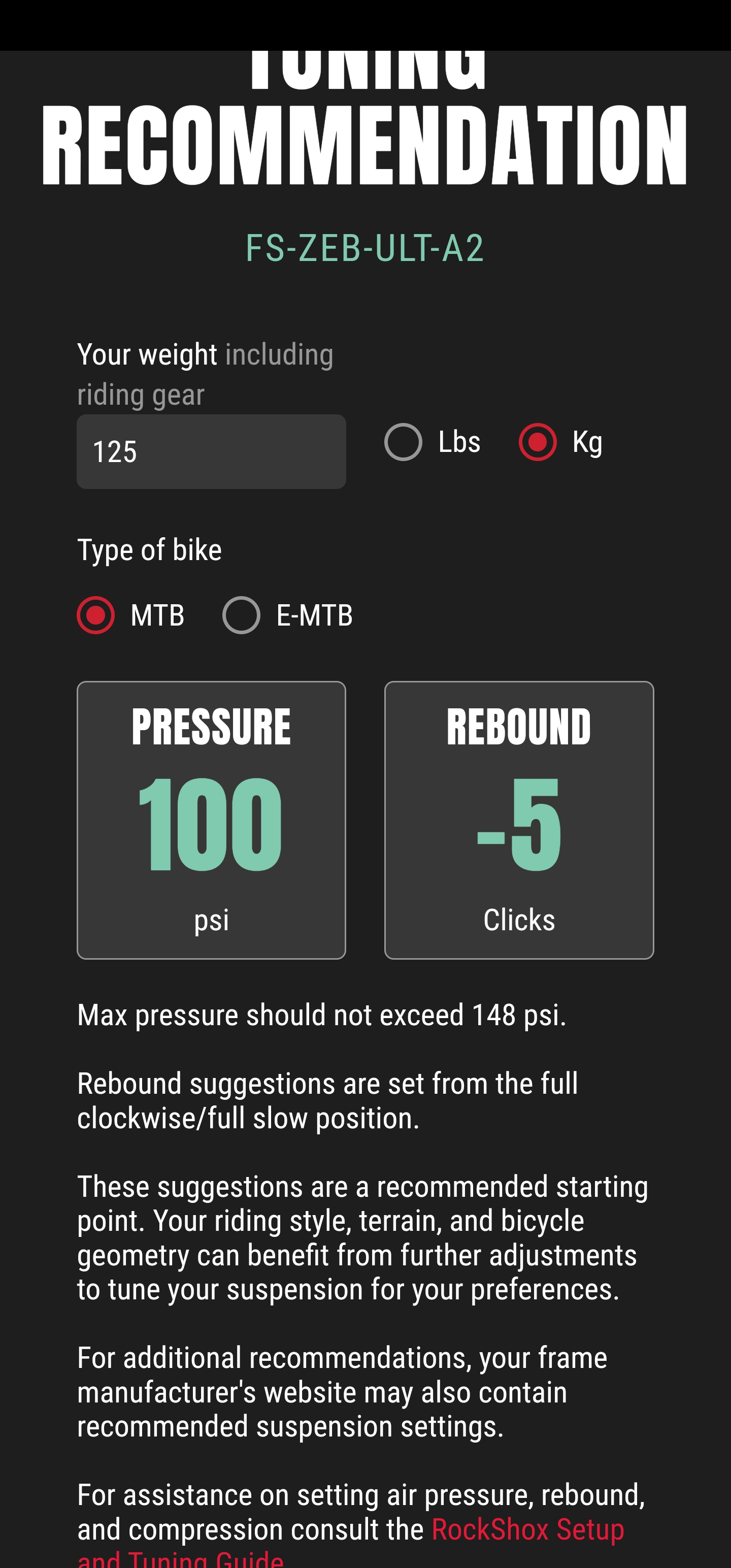

I just upgraded my forks at the weekend to 2023 Zeb Ultimate 170mm
I used the trailhead app to get my recommened psi (120kg -99psi)
Worh refund on -6 as recommended also by the app and hs and ls compression open , the ride was harsh, really hard and unfor giving .
