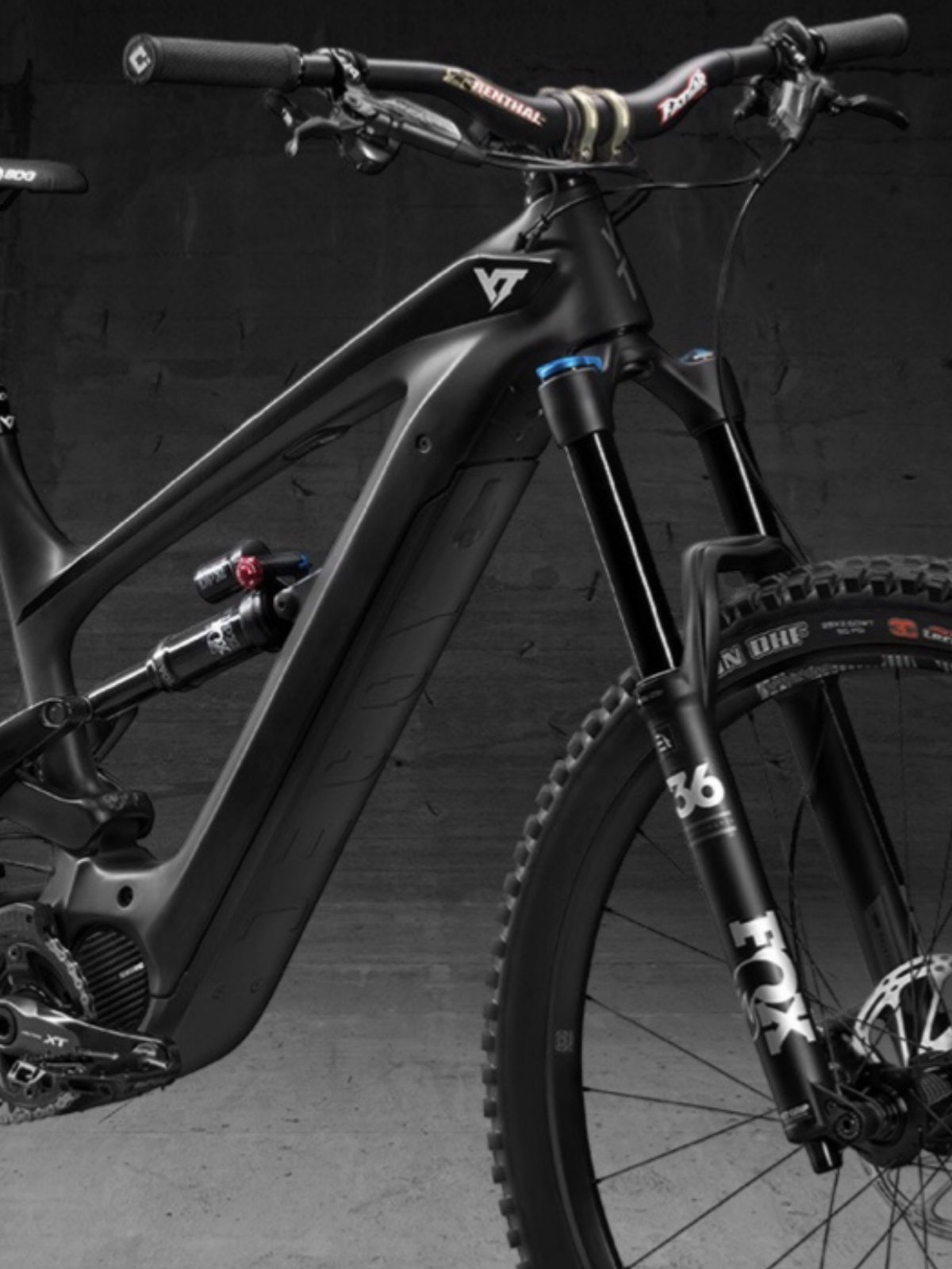

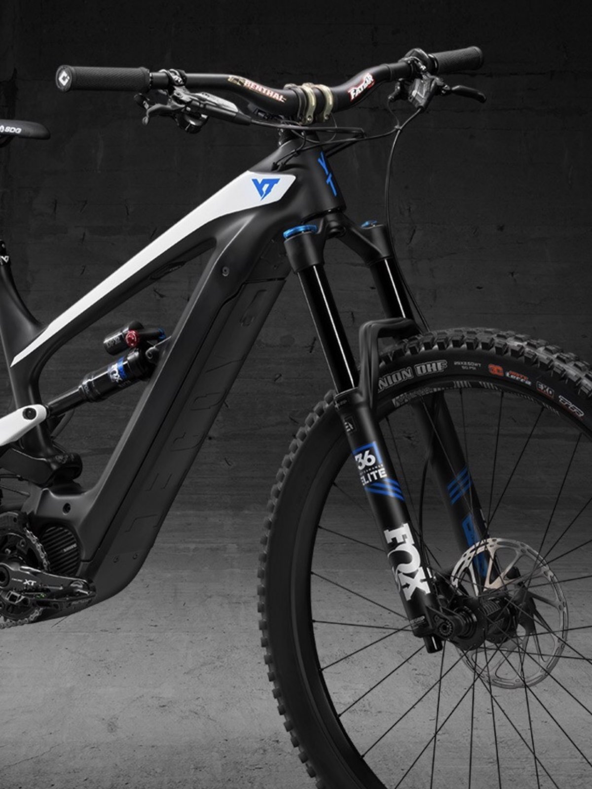

Does anybody know what the deal is with the ebike fox 36 performance elite having the grip damper? I though the elite version was a black factory fork?

Yea I mentioned this earlier in the thread. It looks like that's just a performance fork with an Elite sticker. Its one of the main reasons I'm put off by the pro model. Elite should come with a Fit4 or Grip2 damper for 2019. Or a Fit4 or RC2 if its an 2018...
Unless the 'E' version is different again...

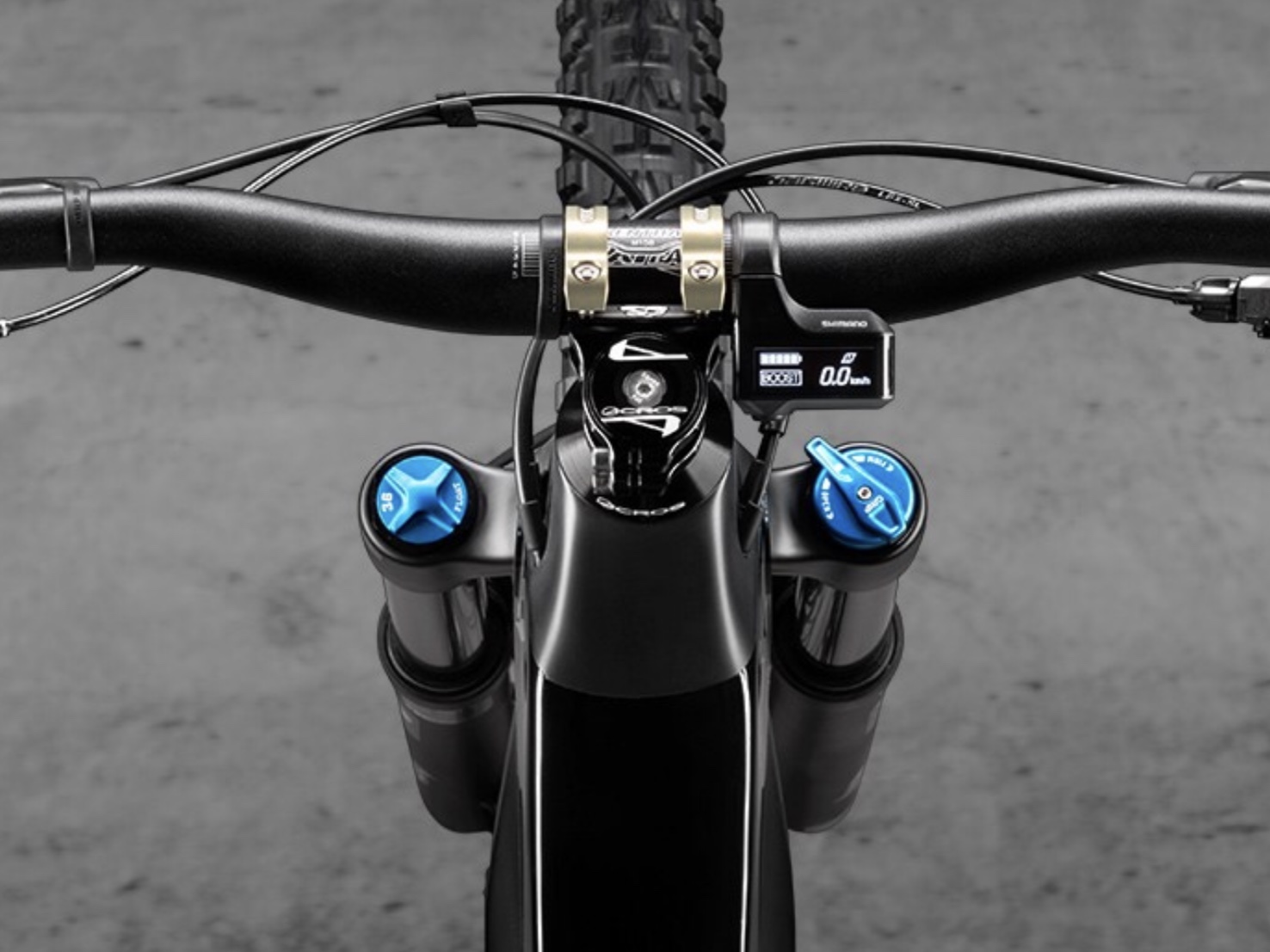

I feel the di2 is a serious drawback on the YT.
From experience with my normal Mtb the shimano electric on Mtb has been a disaster ( road no problems)
The battery just doesn’t like water very much.If you are in a wet climate don’t expect it to last more than a month or 2 and warranty from shimano on that has been terrible.
YT should ditch the electronics
The Di2 power comes from the main bike battery. In testing YT blasted the battery with a pressure washer on full power with no water ingress.

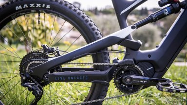

Firstly, let me clear this up. The YT Decoy goes straight into the top few ebikes that you can buy right now. Looks? Stunning. Performance? Outstanding. But what makes this bike stand out from the huge amount of ebikes that have recently been released? Read on to find out exactly why I love this bike.
The all new YT Decoy. One of the most ambitious projects that the YT Industries team have released to date. I was invited to the launch of the bike in the south of France and spent a few days learning about the bike and riding it in the beautiful French mountains. So lets take a deeper look into the bike, the technology and design then take a look at how the bike performs.
YT Decoy Development
YT could have released an electric mountain bike a year ago. Easy. Just buy a motor and battery package from Shimano. Make some modifications to an existing frame (Capra / Jeffsy), bolt on the motor, pop the battery on the front triangle and ship it to the consumer. Job done, YT have...
Continue reading...
You mentioned it but No one replied. Several of the decoy articles mention that it’s the same as a factory level fork, but judging by YTs photos they’re wrong. That’s very disappointing.
Fox’s website makes no mention of a “36 Performance Elite E” fork.

Ok so i’ve been in touch with YT.
When asking the level of suspension on the pro level, they came back and said it was elite with a grip2 damper. On questioning this (as photo shows grip not grip2) they reconfirmed:
Michael Lifka (YT Industries)
Apr 2, 17:39 CEST
Hello Richard,
I'm definitely sure the fork has Grip2.
The photos may differ because sometimes we may not have all original components in stock at the time the photos are taken.
Beste Grüße / Best regards / Cordialement
Michael Lifka

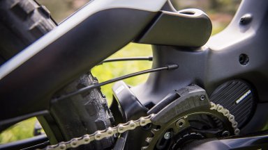

Having not owned an eBike, how would you go about cleaning the crap that will inevitably get between the frame and the motor?
9,190
It depends on the model of bike, and how the motor is mounted. On some bikes its not an issue, on others you would usually drop or partially drop the motor, on others you can use a brush/airhose to get in there.
