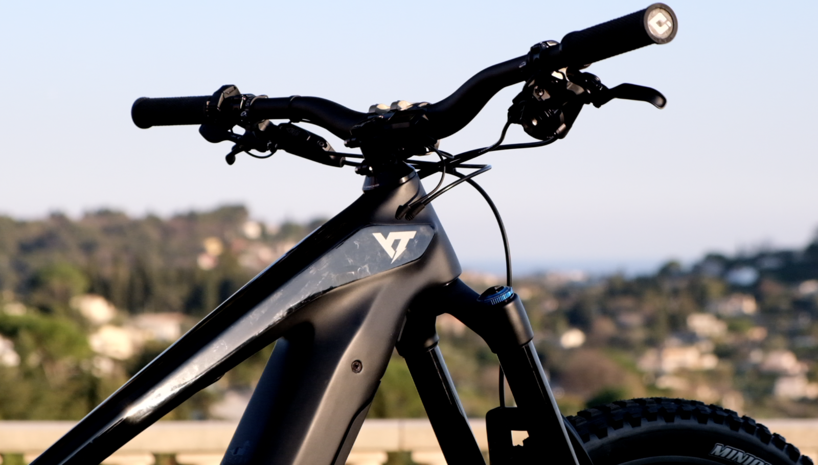

Just been looking at some of my footage. This is the Pro and it looks like the Grip 2...
Rob Rides EMTB
Administrator
Staff member
Jan 14, 2018
6,284
13,809
Surrey, UK
You nailed it, nice find! So it looks like the launch pics are Grip and customer/demo bikes run the lovely Grip 2. Good times - cheers Rob
Good times indeed! The Pro seems like the best bang for buck, great suspension on that bike...
