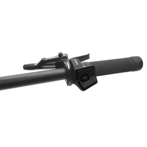

For anyone with experience, is di2 shifting worth the cost? Does it help reduce drivetrain wear? Is the shifter position change more or less ergonomic?
I have Di2 & I don't see the point, I have never had a problem with normal shifters but I'm now scared I'm going to rip out the thin cable on a branch or something, can't say I notice any benefit over regular XT either. Shimano do a couple of shifter options, a standard thumb shifter which is pretty much the same as the non Di & one with buttons which I have never used so can't comment.
9,190
I like the use of the e7000 DI2 controller from an innovation point of view as seems few brands are willing to look at using alternatives to the standard controller, but personally if I wanted to look at a "button" option I would go for the SW-E6010R option which sits in a far more ergonomic position, yet also maintains the minimal look
SW-E6010-R
