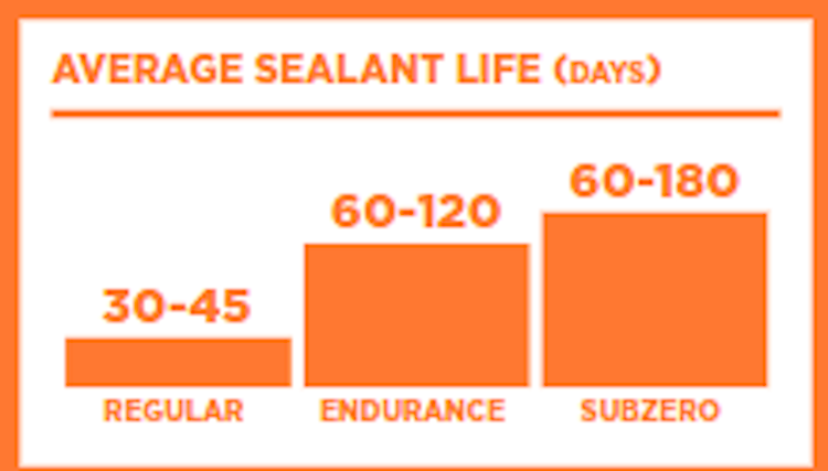

From the Orange sealant site:
Stan's
If you are using our standard Stan’s Tire Sealant, top off your sealant every 2-7 months through your valve stem
In real life, I've found that the sealant lasts much longer than this graph shows, maybe something to do with 'Selling more product' I think, or is that just my old cynical self :LOL:

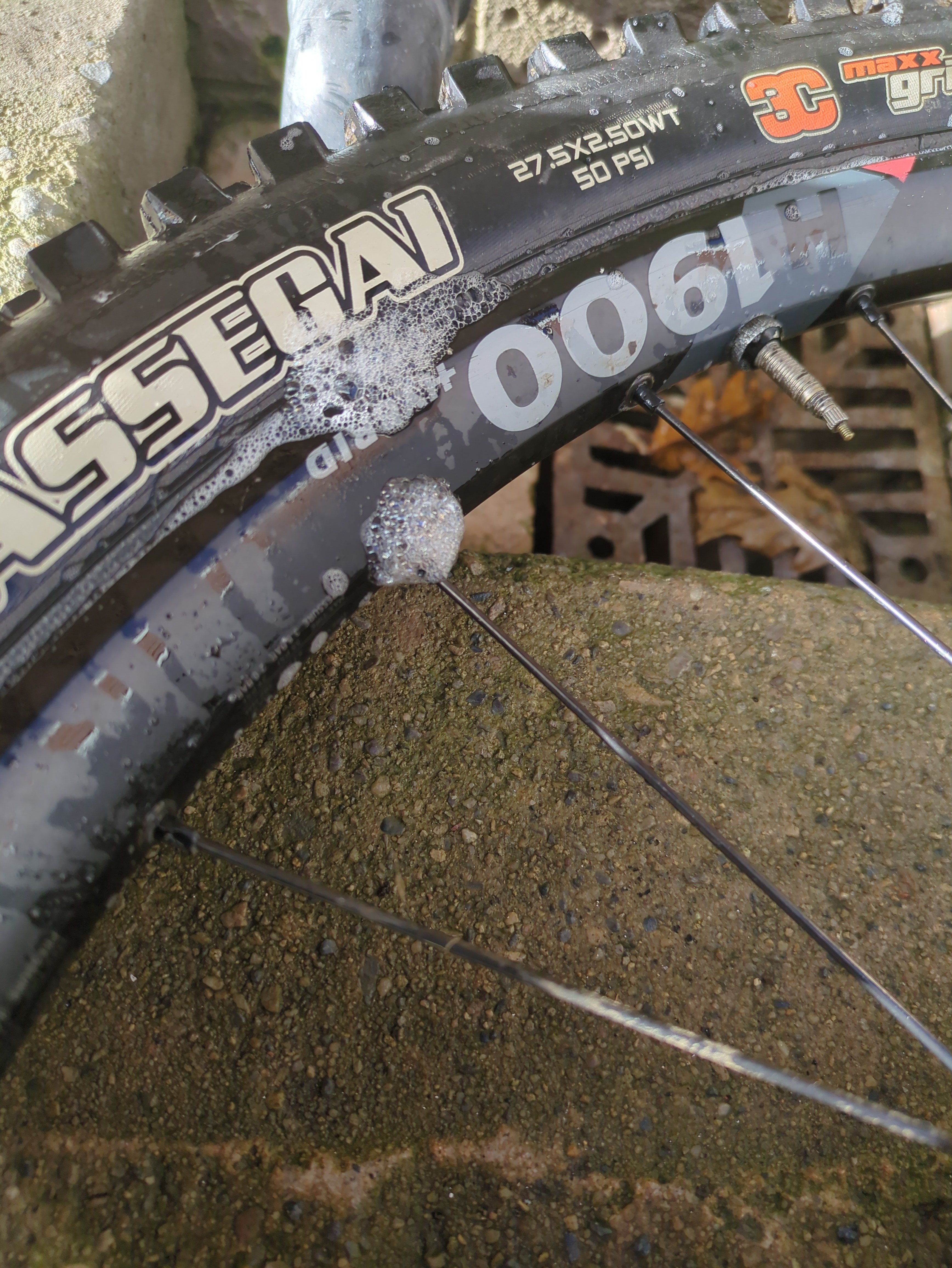

I made the mistake of not laying the wheels flat when sealing new tires.
I put on some new Michelins with 100ml of sealant and kept losing 5psi/day. After a month I finally dipped them in a tub of water to see where it was leaking. There were many air streams from the sidewalls. They were very faint, looked more like spider webs. After a few rounds of laying the wheels horizontal they are all sealed up and I only air up about once a month now.
