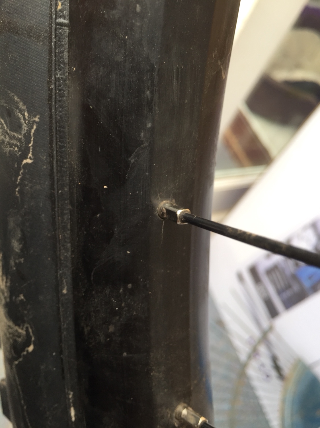

I changed my front tyre last week and it seemed to go well, however it was just killing me into a false sense of security. I went to check tyre pressures today, ready for Malvern tomorrow, and the tyre was flatter than an anorexic supermodel. All I did when I changed the tyre was that; change a tyre. It was already set up tubeless. Closer inspection revealed that it was leaking from the valve. So I tightened it up. Now it’s leaking from the spokes! What the fudge is going on? I did don’t disturb the valve or tape when I changed the tyre.

There’s nowhere local to get tape.
Anyway, my day just got a whole lot worse...
That’s the leaking spoke, complete with what looks to be a hairline crack.

That's warrantyable.
Asuming the bike is less than a year old and they're the OEM wheels and not tweaked/tightened by yourself.
What rim is it?
Mavics used to do that a lot, Yours is due to the Aluminium being overly brittle and having no eyelets to spread the load.

It's a SunRigle Duroc 40. OEM wheel, not touched by my fair hands; I don't mess with wheels.
I've emailed the supplying dealer and Trek.

Many Sunringle rims definitley used to be some of the stiffest (which can also mean brittle) made.
I've no experience of the Duroc series rims though. Just inferno, MTX, Single/doublewide MAG series and ryno lites.
Rim material stiffness (and softness) is a big deal when riding DH and I'm a total geek for that sort of thing. Eg. a softer rim will dent easier but allow you not to puncture when it pinches. While it won't be as strong. it's a compromise. When racing DH rims are considered by many (me included) as disposible items.
