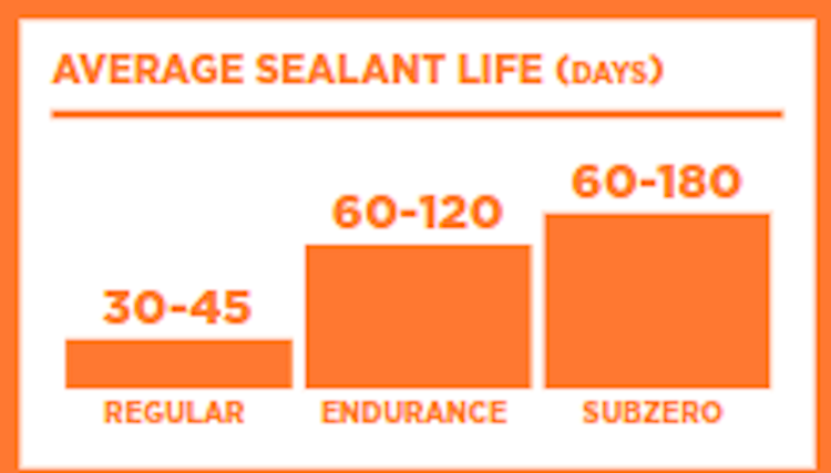

From the Orange sealant site:
Stan's
If you are using our standard Stan’s Tire Sealant, top off your sealant every 2-7 months through your valve stem
