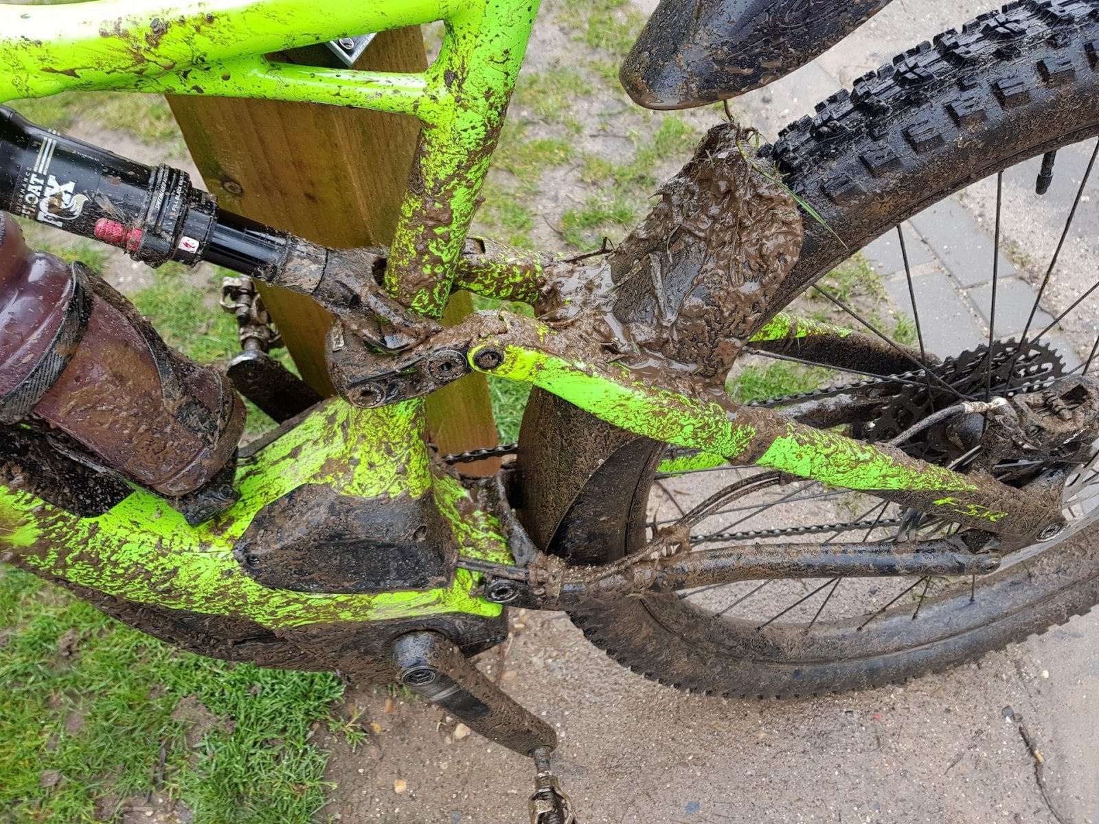

Haven't had to clean anything...that new mudguard did the job!
Actually just a wet cloth so far with no rain to speak of here it's all dust.
