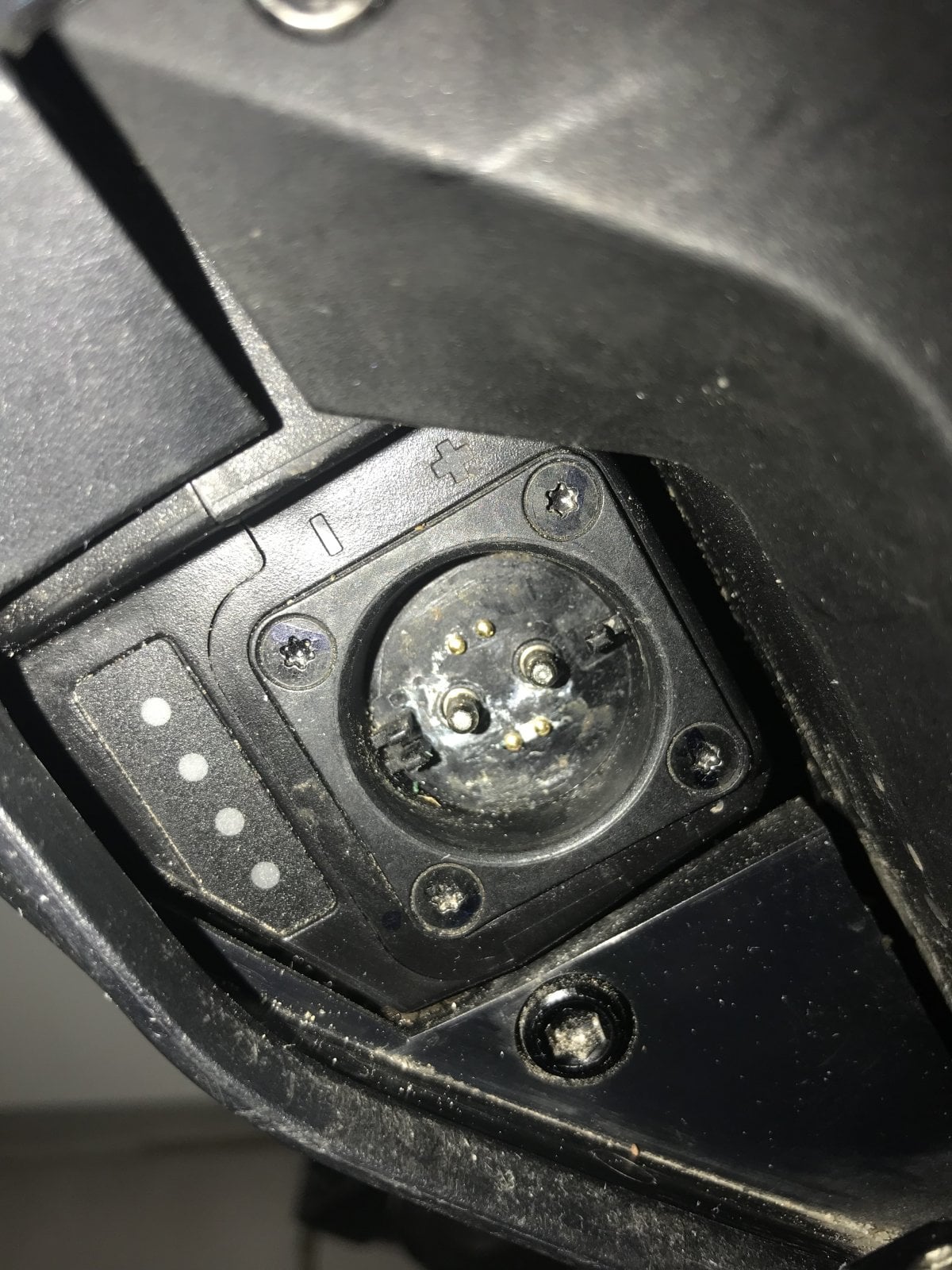

Hi dudes. How you clean or how I am supposed to clean Battery Connector? Any WD40 or CRC product I can use on the connector?
Today I noticed I had trouble turning on the bike and I am 120% sure it was because the connector was not clean. Removed it couple of times and knocked on it started working. When it started working again worked perfectly for rest of the ride.
Maybe even noticed some typical battery "corrosion".
-K
Any electric contact cleaner spray

Pre cleaning picture. @Mcharza electric contanct cleaner made wonders! No post picture though, good as new!
