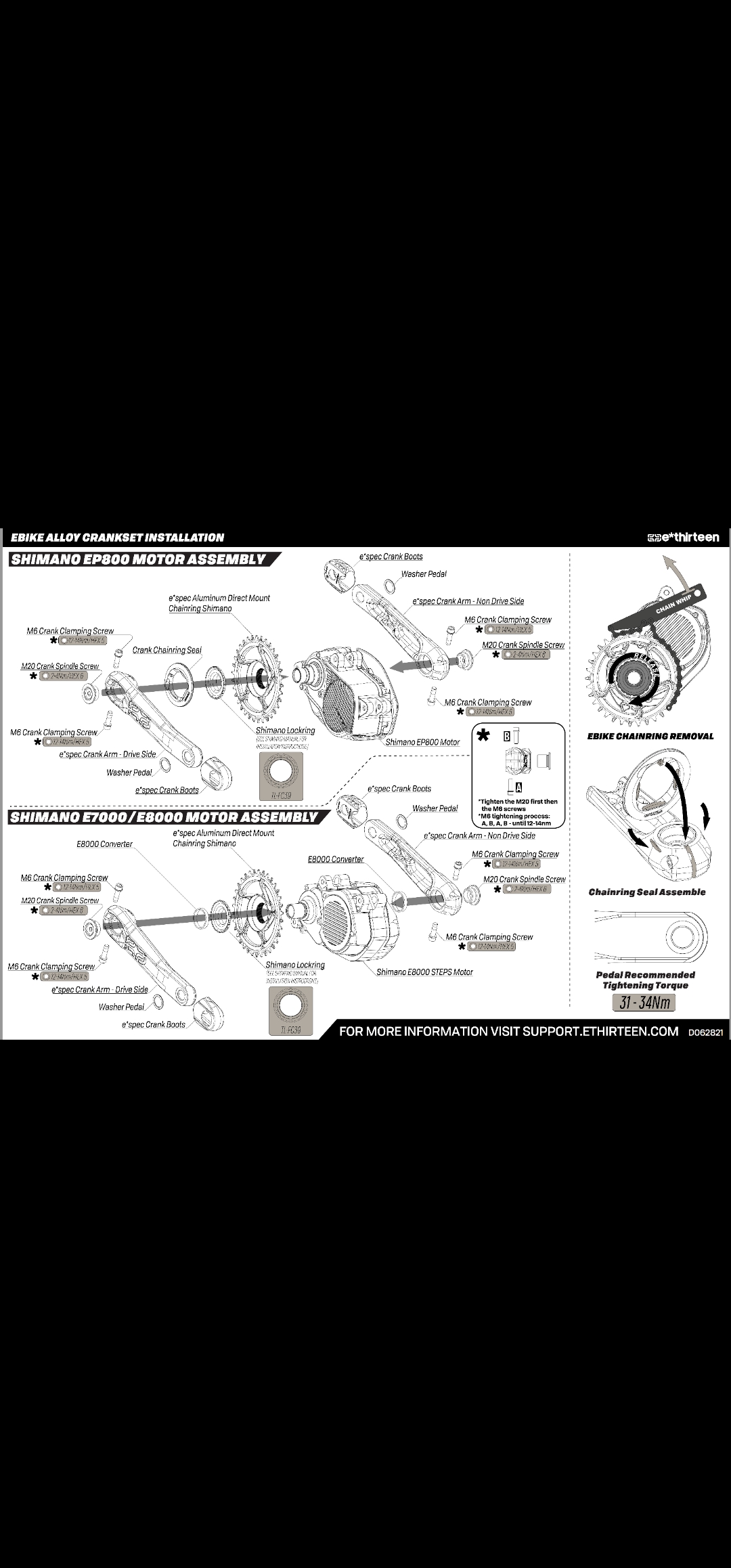

There are soo many threads on this! I called out E-13 asking if cranks were same on E8000 & EP8, they use same cranks the difference is you need to use their rubber seal on the EP8. Shimano make two difference cranks, E8000 cranks Will Not fit EP8!
If using E-13 you DO need to use the rubber seal this is documented by E-13
The Shimano crank you do not use the rubber seal.

Is your motor an E8000 or EP8 as E13 cranks are different
Singletrackmind
Sep 17, 2020
468
424
San Diego, CA
I have the E8000 motor and believe the cranks are the same for both. You will need a little spacer (E8000 CONVERTER in the schematic) for the E8000 motor. Check out a company called 5Dev. They are making some awesome but pricy after market cranks for emtbs.
