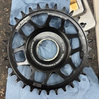

Just fitting my different brakes to my new M10 and noticed the chainring seemed super heavy and it seems to be magnetic - whereas the one on the old 21 M10 definitely wasn't. It's the same shape as the alu ones on e13 site, but doesn't have the machining.
Conclusion has to be that the new bikes are fitted with steel chainrings. Good for longevity, not so much for weight - 222g. seems strange that they've done this on a bike where they're chasing grams
E13 doesn't seem to have any steel rings listed on their site
The old style alu ring is listed at 137g, the new style 115g (perhaps lockring weight included in one but not the other.

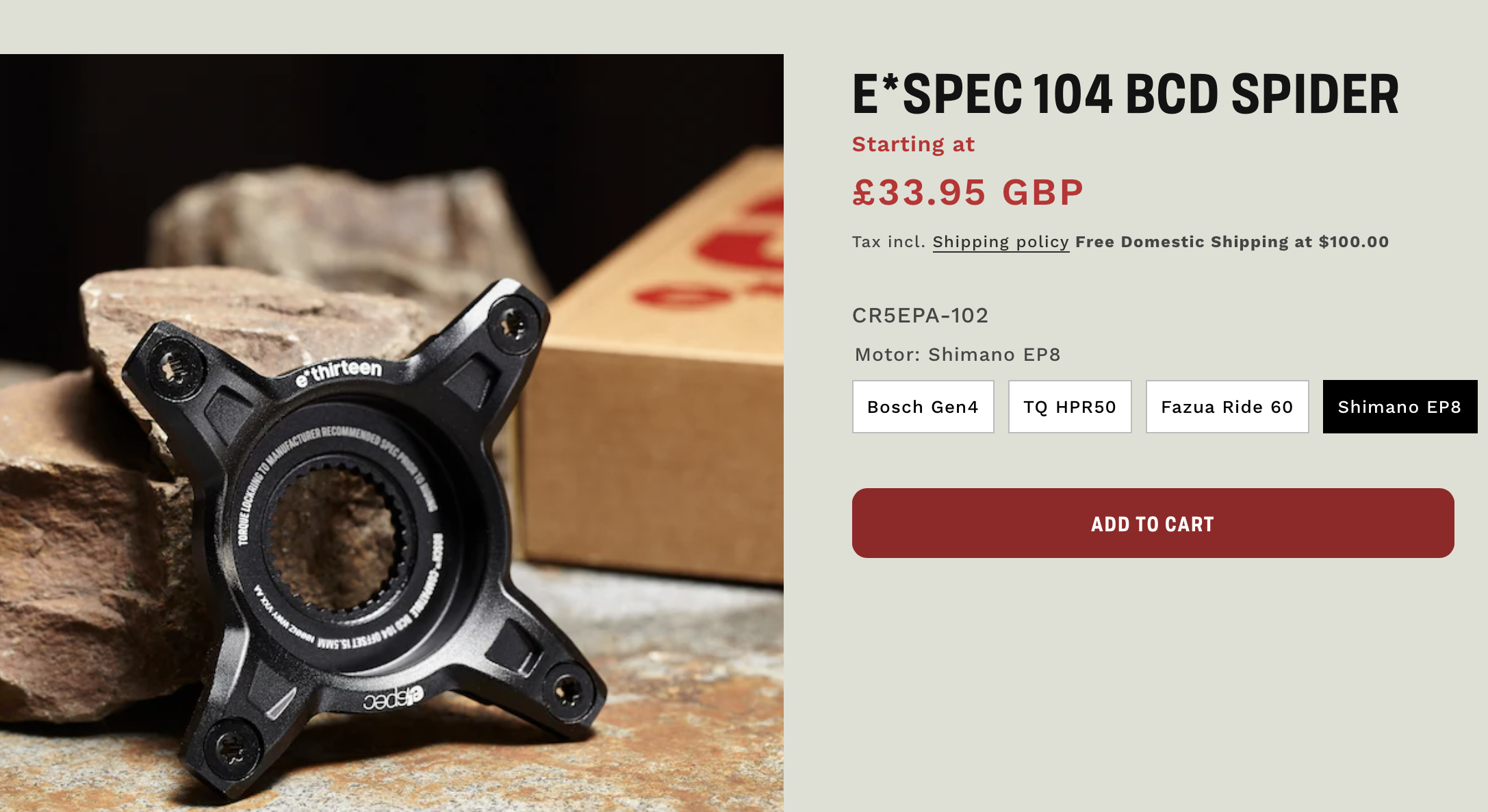

I see they also do an 85g spider as well now - so a 100g steel chainring with that would be a cheaper, lighter solution long term. (and an alu ring as light as the old all one piece).

Tredz had them both when I bought mine. It was a few months ago now though. It might have been £60 for the alloy minus the traditional £5 voucher.
Looks like they're only £58 direct from e13 but the 32 is out of stock there and most other places that I've just checked.
I read on here somewhere that the OEM version had reliefs cut out of the back of the spider and the retail versions fouled the motor bolts but my OEM one didn't have any reliefs and the retail version fitted just fine.
