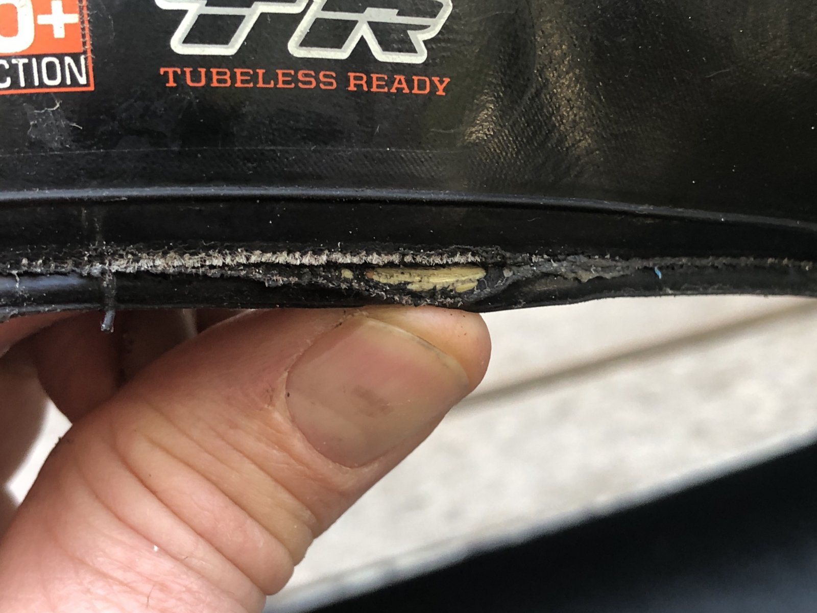

Was searching for some info on the Minion DHR II durability - found this thread. Had my Minion DHR II 27.5 2.6 on the rear for about a month. On a pretty rowdy descent with some jumps and drops got a pinch flat (top of tyre) as well as a rip in the area just above the beading.
('scuse the greasy finger in the pic - rear hub also needed some work)
On closer inspection the sidewall of the tyre is a bit too flimsy as a DH tyre on a heavier bike. I weigh 77kg (on a pimped up Levo)
Spoke to some people at the LBS - general consensus that for eMtb DH riding they don't really hold up. The Exo casing is not built for it. It's a great tyre in all aspects except durability. Cornered well and rolled great. The casing will take scrapes etc, but it's really thin. A few people have had the same problem with punctures etc.
Some people might shriek that you need more pressure, but that really isn't the answer given that you can't just inflate the problem away without losing some feel out of the rear. And even then I wouldn't trust it on my trails.
I was running it pretty hard anyway.
Schwalbe Eddy Currents I had before I could run even lower pressures on the same trail no problem. The Eddy casing is super tough, but comes with a weight penalty. And the tread is a bit too loose for me.
I'm slightly annoyed that a basically new tyre is rendered useless after one rowdy descent. Tried repairing it but it's dodgy at best - looks like the tyre has an ulcer when inflated.
Trying out the Spez Eliminator with Black diamond casing next. Have heard good things.
That actually is the anwser. If you want to run lightweight casings, they are by their very nature less supportive and less durable ergo you do NEED to run higher pressures to eliminate pinch flats than you would using far heavier, thicker, more supportive and more durable DH casings.
And yes, of course the trade off will be less grip and comfort. Thicker heavier tyre casings also damp tyre impacts more
The only shrieking here should be from YOU as it's your money you're pissing down the drain by fitting lightweight tyres and refusing to run them at high enough pressures to be supportive enough for the terrain you ride.
Yeah, be annoyed at the guy who chose to run it at too low pressure rather than the tyre manufacturer though.
Maxxis sells their DHR II as a heavyweight downhill tyre. Not a lightweight tyre.
I’ve dented rims with other tyres and the tyres were fine.
Pinch flat and torn sidewall on the DHR II and my rim was absolutely fine. It wasn’t even such a big hit. Just a bit rowdy.
Not in exo casing they don't
Exo minions are around 750-800g. DH casing minions are a full pound heavier.
In fact the increased pressure will add to the problem by the time you get to the rim.
You might want to think that one through a little longer :unsure:
Using a single ply casing at too low pressure is plain and simple user error.
now you know this you have 2 choices. ;)
A balloon at any pressure is still a balloon. And can only take so much. It just takes one prick. ?

When you note "dhr2" its most important that you include the casing. Exo, exo+, dd, and dh casings make all the difference. A dhr2 exo is not a "substantial dh tire". Exo's actually suck unless youre running extra psi and the terrain has little rocks and roots. The casings , as much or actually more, than the tread design apply to the type of terrain if you want to make it to the bottom.
Personally i like a full dh casing on the front with a flatter/edgier tread profile and a slightly wider rim. The sidewall is flatter and because its a dh casing sidewall its better for edging. You can push in the corners without the sketchy flex.
In the rear i like a little more rounded profile as the tire gets lent over more and a slightly flexier sidewall(a little bit , not a paper thin exo) like a dd equivalent with a tire liner and a touch narrower rim in relation to the tire size. Example would be 2.4-2.6 front tire on a 35mm inner rim dh casing and a 2.6-2.7 rear tire dd ish casing on a 32mm rim. More compliance in the rear doesnt get deflected in the rocks, roots and ruts.
The problem im finding is finding a good dh casing front tire in a 2.6. Magic Mary is all i can think of off hand.
I just put a michelin dh34 dh casing 29 x 2.4 on the front. My favorite tire thus far has been the michelin rockr2 2.35. It measures closer to a maxxis 2.45 so i thought the dh 34 2.4 would be wider like a maxxis 2.5 width. Its not. Its narrower than my 2.35 rockr2 and the same as a maxxis 2.4. That shit pisses me off. Michelin have the best rubber and sidewalls and patterns but their gaps in sizing , weights and sensible width measurements is frustrating. The dh34 is awesome in the bike park through berms and jumps. So much confidence pushing into corners without the sketchy flex. Just perfection. On super steep dirt and rock faces id like a wider profile more control based than race based . I think a 2.6 with full dh casing front is the sweet spot. A 2.8 with less casing is fine for complete control to go slow on steeps but its flexy and wallowy in the corners if youre pushing. Not very precise. Ive no interest in anything 2.8. Less than 2.5 doesnt offer enough braking traction, especially for emtb on the steeps.
Loic Bruni races on 2.4's but on those tracks i'd definitely favor more control than speed. I think we need to see more 2.6 dh casing tires.
It doesnt matter if you put max psi in the tire, its still not a substitute for a healthy sidewall and you actually be more succeptible to rock punctures in place of your previous tiresnake bites. An inflated balloon is much easier to pop kind of thing.
My dream set up would be a 2.55/2.6 rockr2 dh casing front(not made in dh casing or 2.55/2.6) and a 2.6 dh 34 bike park casing in the rear(they make a 1200g bike park casing dh34 but no 2.6). MagicX front compound on 35mm rim and gumX rear compound on a 32mm rim. Another 4 or 5 years and they may get around to it/end mega long rant
Thanks. That’s basically what I was trying to say. Just saying “pump it harder” is not really solving the problem.
I was running the exo+ casing DHR II’s which never gave me a problem on my lighter analogue enduro bike on the same trails.
I was just disappointed at how easily they popped on a heavier bike. They really are very thin despite the claims of 51% better sidewall protection compared to exo.
Back to a heavier casing for the emtb as I mentioned.
And it is tricky finding a decent casing on 2.6 tyres.

It doesnt matter if you put max psi in the tire, its still not a substitute for a healthy sideall
I don't think anyone said it was.
That's not strictly true. some rock hits will pierce a higher pressure tyre more easily and some will pierce a low pressure tyre more easily.
singleplys are clearly not for everbody but they do have their benefits. if you're going to ride fast rocky terrain on high pressure single ply tyres you need to be a skillful, smooth, calculated and precise rider. But even if you are, if you're the type of rider who always wants to go as fast as possible regardless of the consequences they're not a wise choice.
