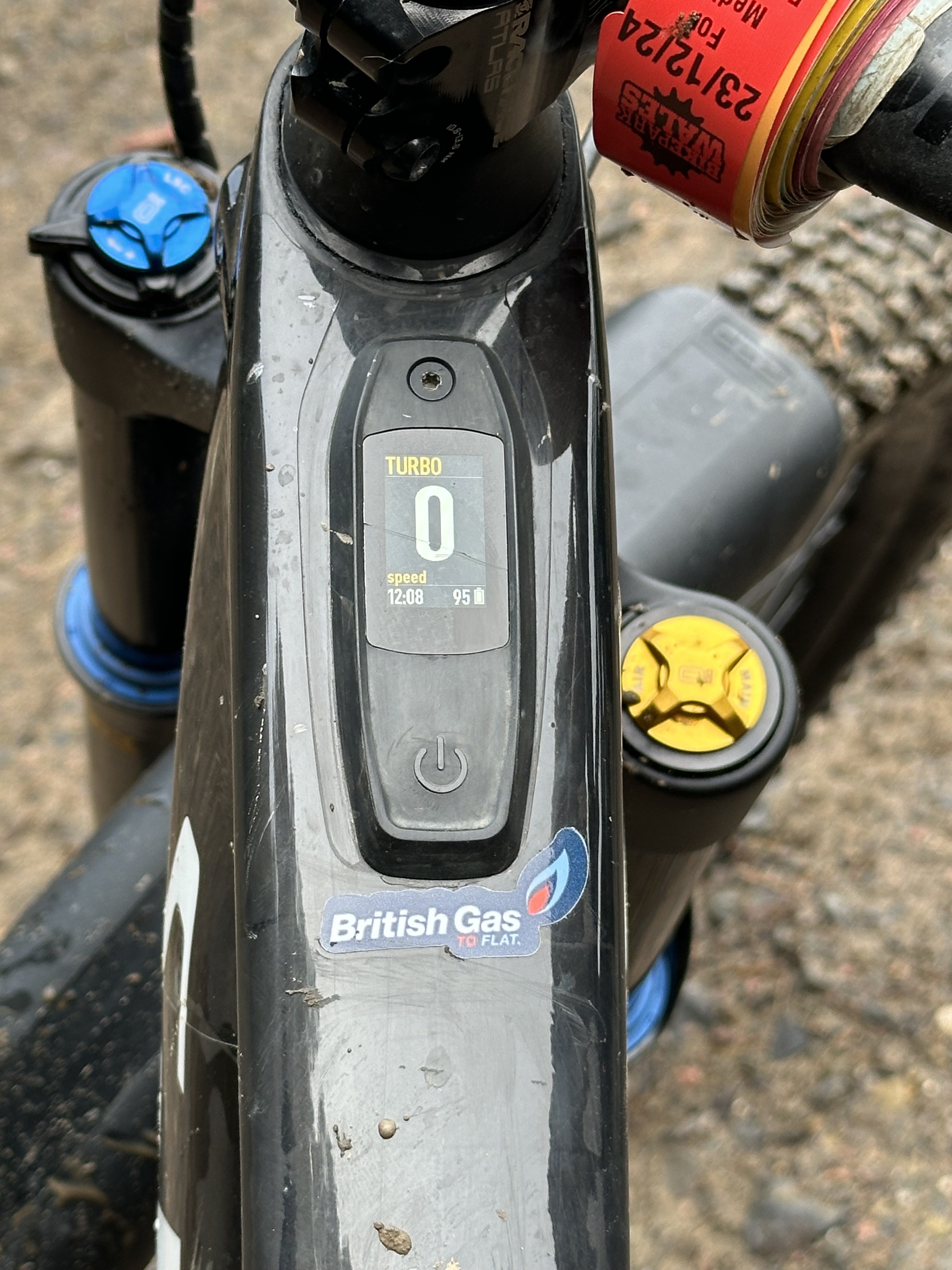

Added a sticker to reflect my habit of massively over jumping everything to flat 😅
