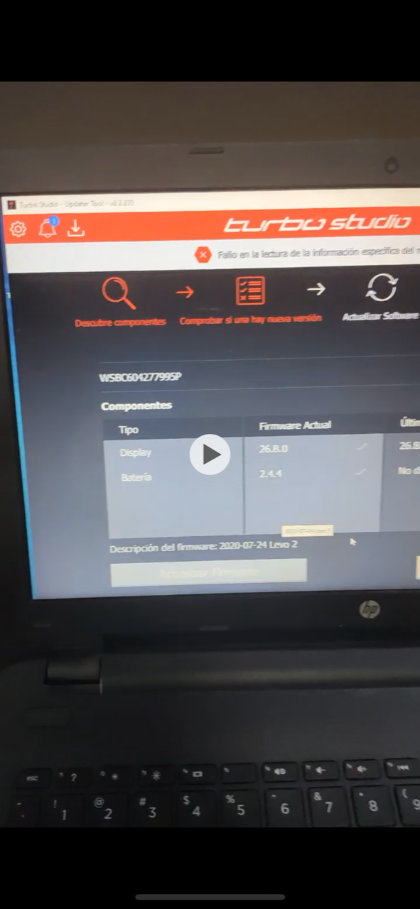

Hello all! Just purshased an Levo SW 2020. Bike was ready to deliver on 07/31 and local BS heard about Software update so they decided to update everything before the deliver.
News: after software update motor stop appearing on software and don´t turn on anymore. So they´re waiting for a brand new motor from Specialized (2021 model). Have anyone heard something like this before? Swiss technicians told might be defective TCU, cables or some energy discharge on the update exact moment. But I trully believe should be a software error or an old engine ...
(bike was working perfectly before update).
Hi @rafaelblu - so very sorry to hear this and our apologies for the trouble. It's the only such case we know about which is why I can speak with confidence (having checked our quality system, we monitor update failures as you'd expect) - our Brazilian support team reached out about this on the day it happened. The motor FW crash was due to an old version of retailer software on the PC being used to make the update. Not the fault of your retailer, but it's a highly unusual case and I apologise that it delayed you picking up your bike. In the background I'll reach out to our team in Brazil to check progress here.
