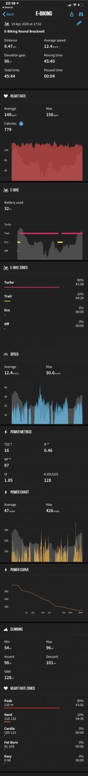

It does not help to add a wahoo Speed Sensor. I also testet that. The actual Speed is always shown right with the Levos Sensor. The Problem is the Average Speed and distance. These 2 Values are Wrong as soon as the Levos Power Sensor is added to the Wahoo.
In the picture below you can see what happens:
As long as the Powersensor is not connected it works fine. As soon as the Powersensor gets connected, the average speed gets to a constant max value. Even if you drive faster for a long time, the average speed do not follow.
Also the cumulated distance gets wrong from that point on.

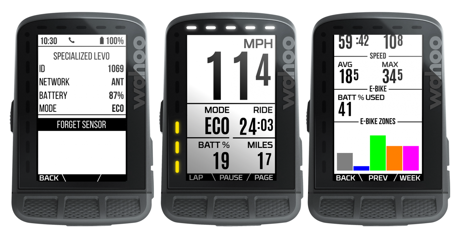

For those of you who are using a Wahoo Elmnt/Bolt/Roam - I noticed here it shows "E-bike zones" in particular reference to the Turbo Levo
I've got a Wahoo Bolt paired up with my Turbo Levo - but... how do I display those bars? I get that the image shows the new Roam, but the wording on that site makes it sound like this capability is across all the Wahoo devices.
Anybody else got this to work and if so, where is the setting to add to the page?
As far as I know, you can only see those zones on your device in the ride summary after finishing your ride. I usually skip past this screen when I'm done as I just need to go collapse somewhere! Extensive zone data is available in the companion app and Strava when uploaded.
Ohh... yep - I just found it. Thanks! It can be viewed in the ride history in the Wahoo app. Cheers.

Ok so I've got an update.....
Bike went in for it's first complimentary service last week, and while the bike was in I got them to change my wheel diameter to 2326mm. A google search seems to show this is the universally accepted wheel circumference of a 29x2.3" wheel. Keep in mind previously configured wheel circumference was 2100mm (27.5").
Since the LBS changed it to 2326mm, the Wahoo Bolt has been spot on with the distance recording.
I just rode the same local loop as I did with my previous tests before (2 posts above). On those tests, my analogue MTB with 29ers using older sensors measured 5.5km. My Turbo Levo using the Wahoo sensor (with automatic wheel circumference detection) measured 5.3km (the same as a Strava corrected distance).
Now with the correct wheel size using only the Turbo Levo built-in sensors, I measured 5.47km both times. This is the same distance as my road bike and my analogue MTB (give or take 30m) - which is within tolerance because I probably didn't ride the *exact* same line each time.
So on that note - I actually consider my issue resolved, and can rely on the bikes built-in sensor to measure distance accurately.
