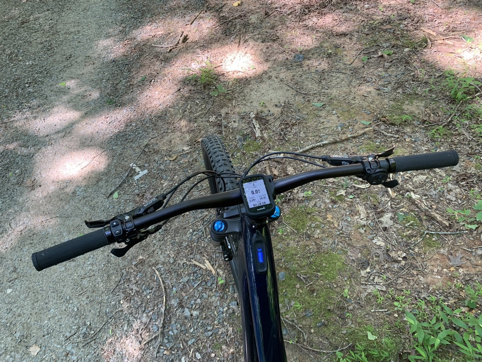

A few fumbles in setting it up but it is mostly working now. The MTB mount interferes with the SWAT tool on the stem but I stashed an extra Allen key in with the spare tube in case I need to get to it.

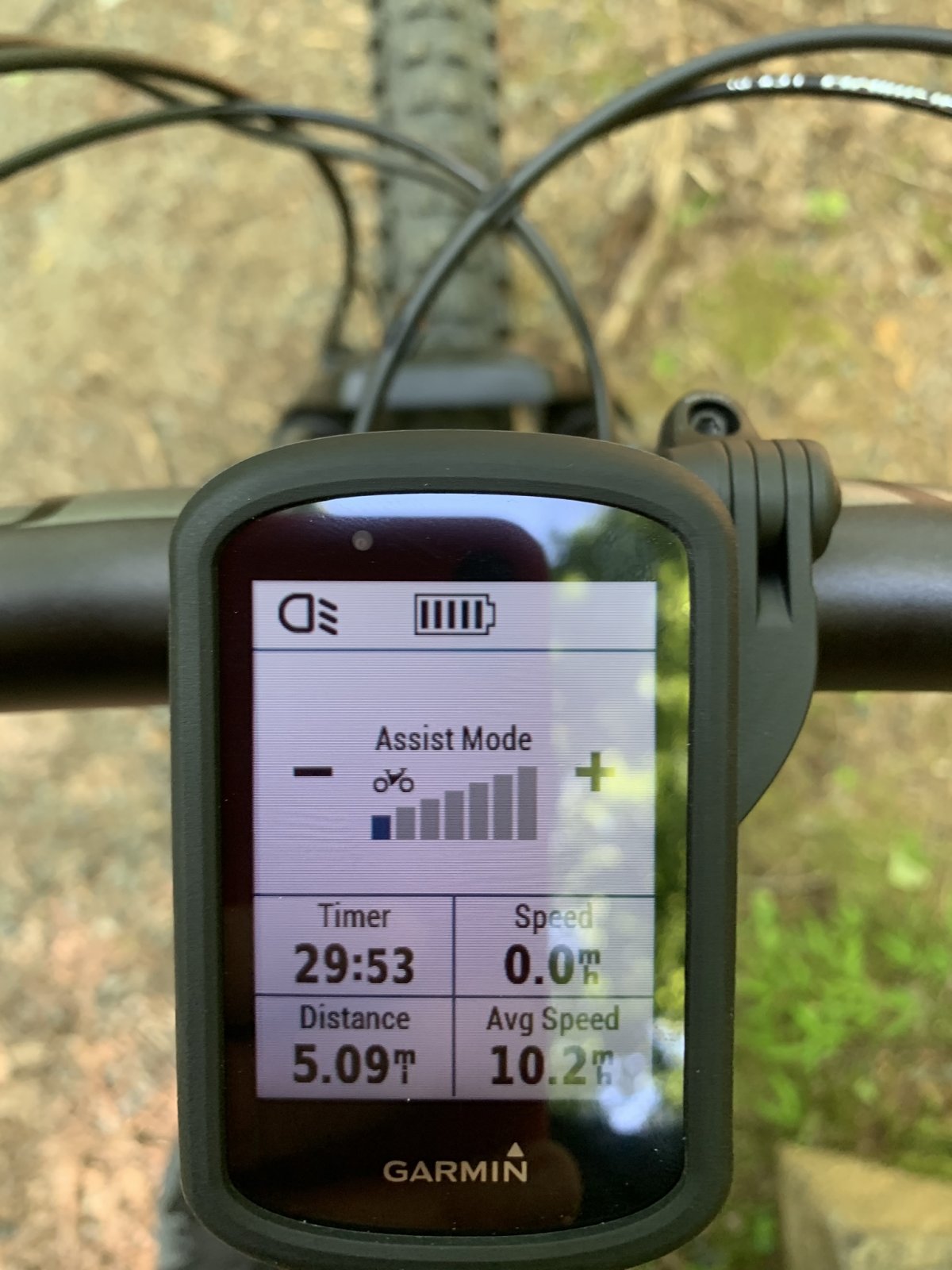

Have you definitely got the correct eBike Field (Connect iQ app) working? That screen is only for Shimano STEPS bikes, so you may as well disable that one in settings as I don't think it works for battery, assistance level, etc. on a non-shimano bike. Install the eBike field Connect iQ app on the device, customise the settings to display battery & assist level in a single field, and then place that onto a data screen.

Ok I didn’t realize that another bike was working with the app yet. I will try and pay attention a little more :). Thank you
... it's not - the photo you show is the native ebike screen standard on the device, and it only works with Shimano STEPS (I believe). The 3rd party eBike Field app only works with the Levo as far as I know, and this is the field you need to install, configure and display. The Shimano screen is not showing you your bike info.
I remember seeing 2 built-in screens on my Garmin Edge 1030 - one for Shimano STEPS and one for other e-bikes.
You ae quite possibly correct - however the only way I could get my 2019 Levo to talk to my Edge 1030 and display battery & mode was to use Jan Capek's app from the Connect iQ store.

That screen may be for the Shimano but when I change assistance levels it changes it in that display. The other odd thing is it shows eco as level 1 but trail as level 3. Skips right over 2

Does anyone use Specialized Turbo Connect Display Mount MTB for Garmin Edge 530/830? I'm wondering if this still interferes with SWAT tool? I'm ok if I need to remove the Garmin device of the mount to access the SWAT tool ...
I think, there is no problem at all....go 4 it!

For everyone looking to use a Garmin with the SWAT tool, take a look at a K-Edge mount.
Mounts on top of the stem putting the Garmin over the bars, but doesn't block the ability to access the SWAT tool.
I have a Swat tool and I use Garmin MTB mount. It allows me to have the Garmin in safe location just on top of the stem and I can use the Swat tool aswell (I lift the Garmin mount up) .

I mounted the bracket on the left side of the stem and tilt the screen toward me. It doesn't cover the SWAT tool. Photo on request.
