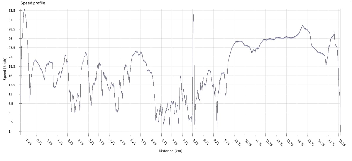

I have previously a speedCHIP V3 (not speedbox) that work verry well without error but latence for speed indication-->go to the bike of my wife
Placed the Volspeed 3 on my bike
3 day to receive from ebiketunning.com
>The female connection tubes are to be reviewed no locking with the connector> insulating sheet required
>First ride, very good feeling, reactive micropressor (reactive speed display), no countdown
>Tested @32km/h 15km-->Ok all mode

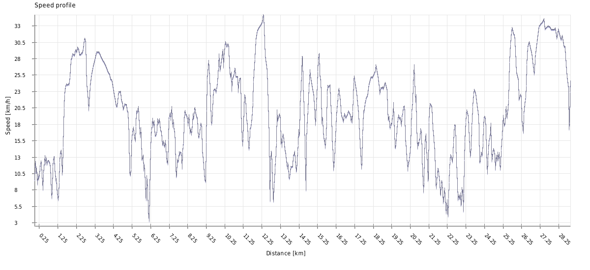

Took the first trip with new firmware. The rocks and roots were very slippery as it had been raining the whole day. I could say that the new torque adding effect is maybe not so exceptional. For this ride I had changed the new fork (Cane Creek Helm), new firmware, lowered the handlebar (1 knockblock ring) and the trail was slippery so there was many changes compared to previous rides.
My trip was only 28km long and speed was not much beyond the 25kmh limit. The Volspeed was installed before the update and I didn't remove it for the update. Have to admit that the Volspeed has brought the speed and joyfullness to riding in parts where you would hit the 25kmh "limiter".
No error codes now or in the past. Will report my experiences when I get more kilometers.
