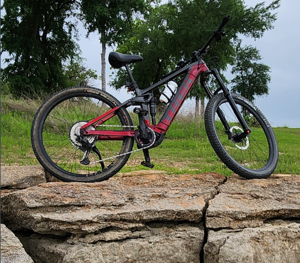

Texas
What year/model of Rail is that? The shock looks very different than mine with the external spring. Lots of other things look different to me too. I have this 2021 Trek Rail 7
arTNC
Feb 1, 2024
240
282
Texas
dschael, it's a Gen II...the year after yours. Yes, you're right about the suspension on my Rail in the pic. OEM fork was a RS Domain, and the rear shock was the same as yours. I swapped to a coil Marz Bomber fork and a Fox DH-X2 rear coil shock. I prefer coil suspension most all the time. May come from my dirt motorcycle background.

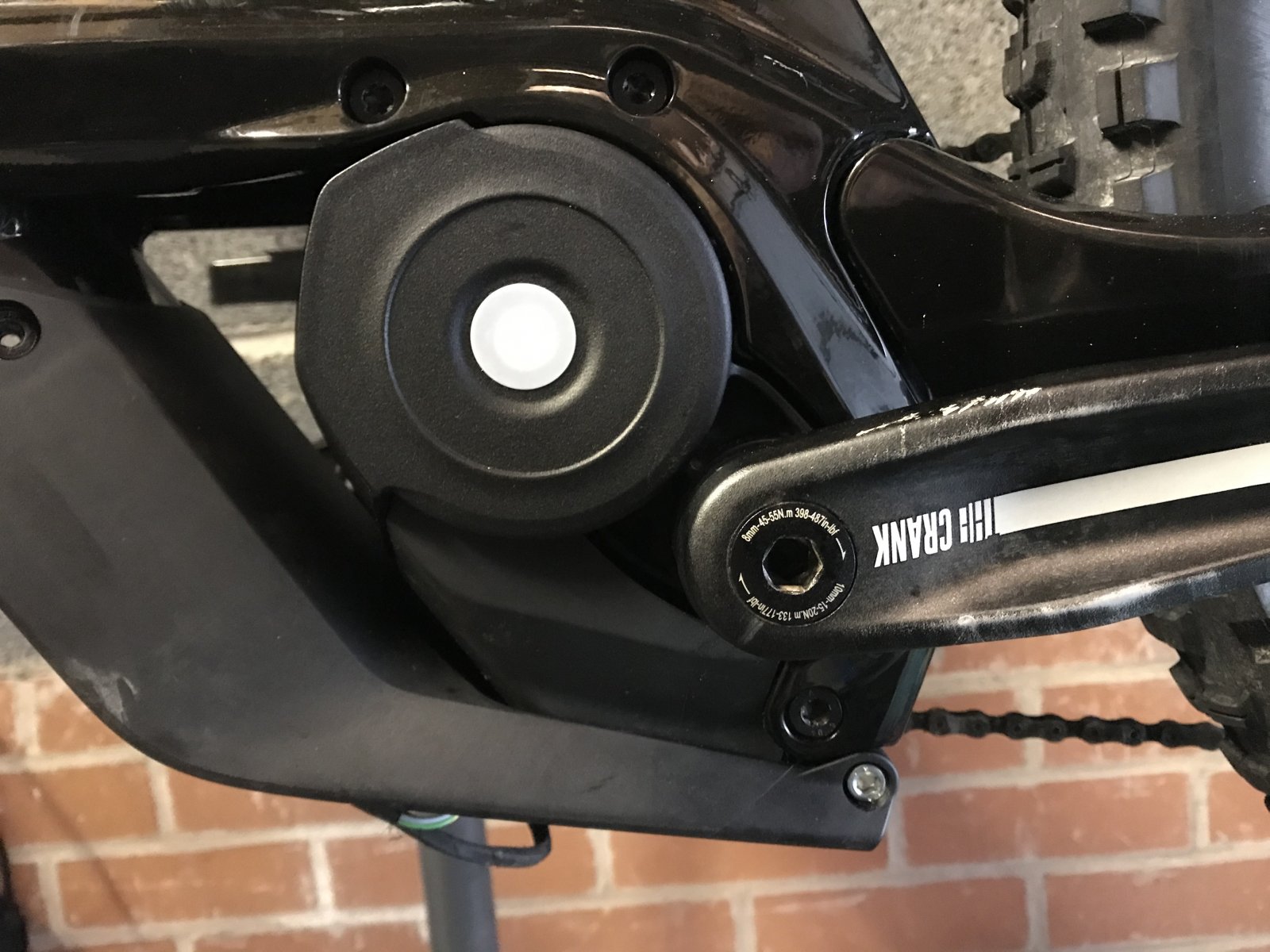

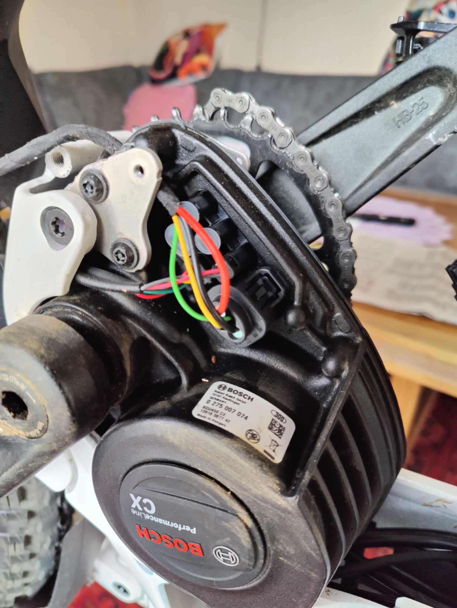

Hi guys, I have just bought a Haibike Xduro All MTN 5 with Bosch motor 2021 and i want to derestict it using the volspeed V3, Ive read loads of posts on here and in most of the videos i’ve seen it looks very straightforward to install however on my bike i can’t see how you can get to the electrical connections to fit one? Any help greatly appreciated.
Update.
To get to the wiring on this model of bike/motor, the procedure is as follows
Remove bottom cover 6 x 4mm allen bots, remove right hand crank arm, 10mm Allen key followed by an 8 mm allen key, then you need a crank extractor to remove the crank arm. Remove the chain guard 4mm allen key, remove the front sprocket, 43mm isis bottom bracket tool is needed to unscrew the lock ring this is a clockwise turn to unscrew.
Once you have the front sprocket off this gives you access to the 5mm allen bolt Silver one on the bottom right side, of the motor remove the left one also, now remove the upper fasteners on the plastic trim which houses the battery connection one either side and these are a 2 part fastener, 4mm allen key on the outside large flat blade screwdriver on the inside. Now this plastic cover slides downwards and off the bottom of the frame. Lastly remove the 2 torx screws size 20 now revealed one either side to remove the plastic trim which houses the electrical connectors. Install the tuning chip and put back together in reverse.
A bit of a lengthy process on this bike which was very annoying.
Dave.
Hi, no problem getting this done without removing crank arm and sprocket on my 2021 All Mtn 3.
I could access the screw through the sprocket. Didn't have to remove the screw, just loosen it fully.
