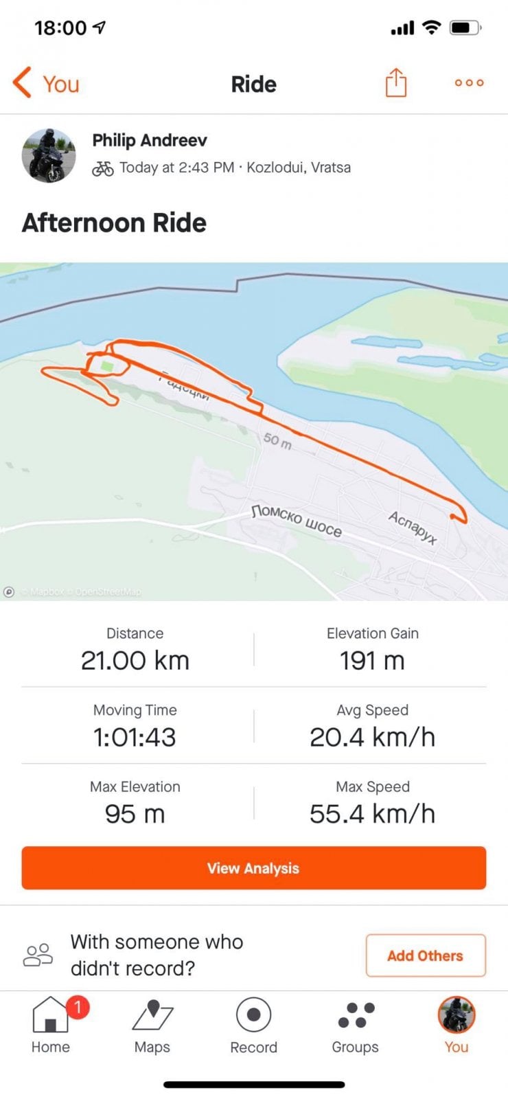

Hello guys! I have Bosch Performance CX Gen 4, Ver. 1.1.0.0 on Bulls Sonic 2021 , waiting for my Volspeed on monday. I will set 60 km/h max speed, and will report later the result. The weather here is awful, I hope for more sunny days soon. See you later! 😇
Flo
Sep 16, 2020
108
14
Romania
Great ! You can mantain 60km/h speed ? Because i have 34 tooth with 12 speeds and i can mantain 40km/h when is no a windy day. After 45km/h i pedal in vain.
gothic_fan
Sep 3, 2021
bulgaria
My previous bike was Cube Reaction Hybrid 2016, Bosch 75Nm , reached speed of 55 km/h on flat (but not maintained) with motor ON. So I hope to beat that with this new bike. 🚴‍♂️
gothic_fan
Sep 3, 2021
bulgaria
For now the chip is great, 55km/h on flat, I think it can make 60 downhill. The consumption is good too, all in TURBO mode, from battery full.

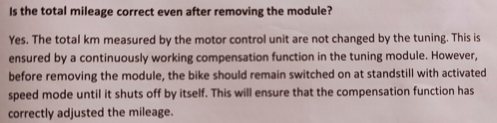

From what I've read on here, that only applies to speedbox.
14,183
21,097
I think it's the same on the volspeed.
You just leave it to turn itself off when it's finished - which is longer than it would be to turn itself off without the volspeed turned on.
2. Can you plug it in to charge during this time, or would that stop it from properly 'tricking' the bike?
Probably want to let the battery cool a little before you charge it anyway, but if you did plug it in to charge I think that would stop the procedure as the bike re-boots into charging mode.
14,183
21,097
is this just Volspeed 4? I know for the 3 this is not the case. It is a reason to purchase over the speedbox.
I thought it was like that for the V3 ? I know after a ride I'e seen it shuffling all sorts of strange numbers on the display. Maybe it depends how fast/far you've ridden and how much it thinks it still needs to compensate the data ?
Darren
Sep 25, 2019
191
246
Warwick
I thought the leaving it to run on was only for speedbox too.
I've always turned my bike off immediately with the volspeed running never had any problems.....well over a thousand miles with it now.
14,183
21,097
I think it all depends on how fast you've ridden, how far and how long. Most of the time it will have compensated on the fly as you're riding.
However : From the manual (excuse the crap picture). It's referring to if you remove the module, but the principle is the same, it compensates then turns itself off.
I'm pretty sure mine was on for a while after this and I thought I saw it displaying different numbers (I was drinking beer then though), it had a top up charge part way through so would have been off and on then.
Who knows. I just leave the bike on and always let it turn itself off, but then I don't always turn the volspeed on.
