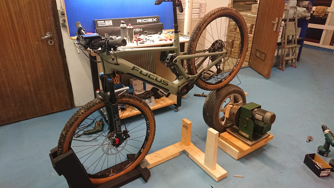

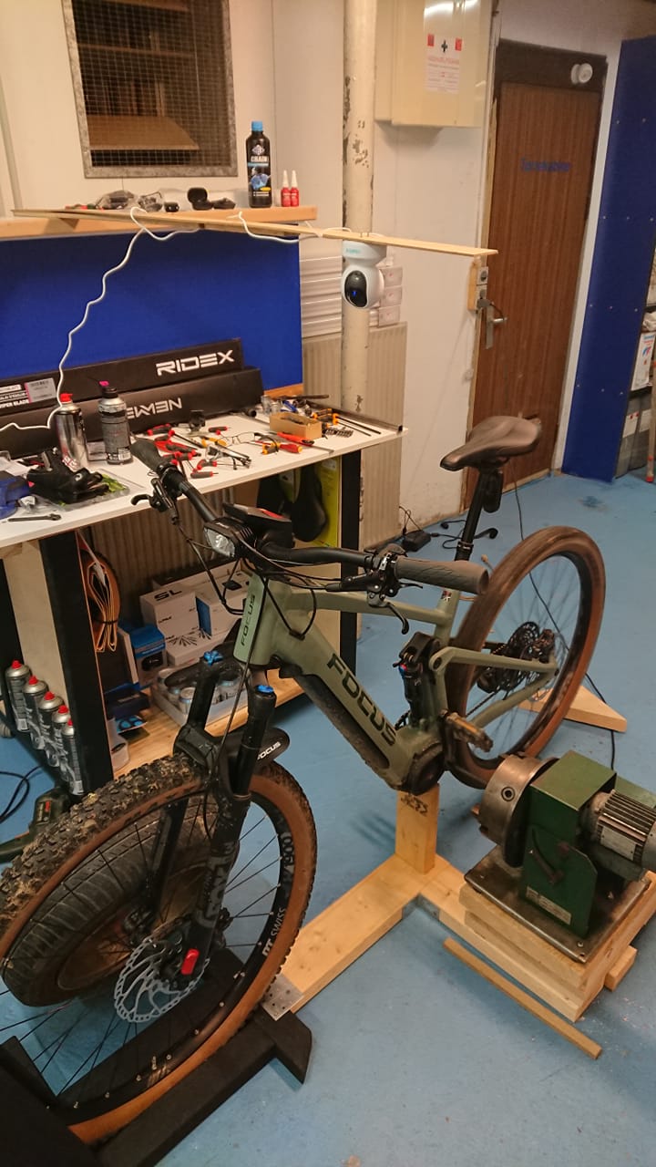

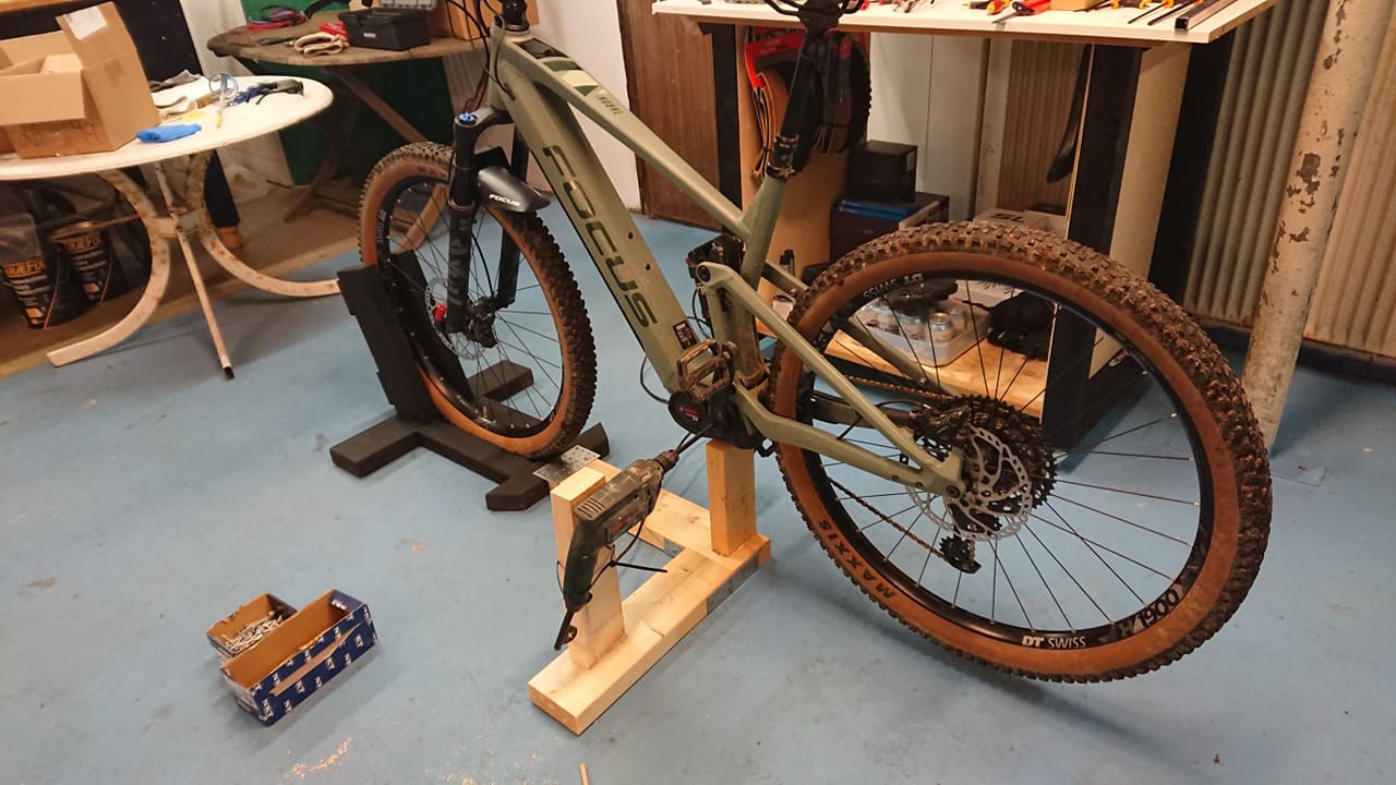

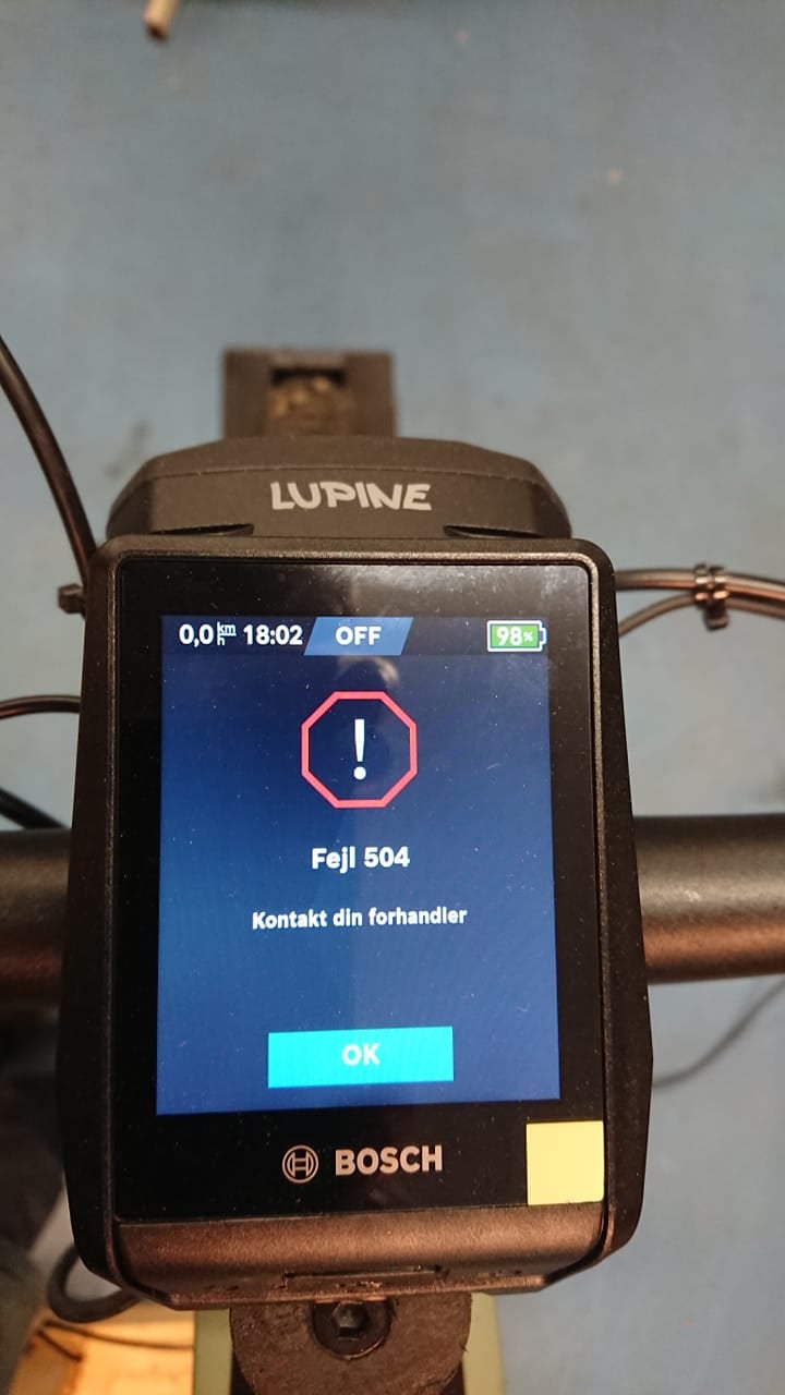

So far I have done +3000Km with VOLspeed running firmware 1.0.2.0 and the Kiox display.
Last week I received the Nyon2 (ordered 12th august...) I did 8Km and I got the 503 AND the 504 :oops:
I tried to dodge the "penalty run" by attaching a motor to it (as seen on YouTube). NO luck. My Nyon2 started
going into standby mode and switching of the screen, and NOT counting the time or distance.
I switched back to the Kiox and tried the "motor" pedaling still @ 7.5Km/h again. No luck, display was now on for 1hour before standby.
8 hours into trying to out smart the software I did my 1,5 hour 32Km penalty run (in the rain) :censored: before I was able to reset the 503 and 504 Error. :p
I kept the VOLspeed connected and I have re-tuned the bike to 38 Km/h max speed and it's working fine (with Kiox) :cool:
I was not going to update the motor firmware to the 85Nm version (never touch a running system...)
But reading through different forums I think it might be the time to take the jump?
What do you think?
I really like the Nyon2 display.
Attached pictures shows 3 different ways I tried to attach a motor to do the pedaling for me. No luck?! :unsure:
What do you think?
View attachment 46241 View attachment 46244 View attachment 46242 View attachment 46243
