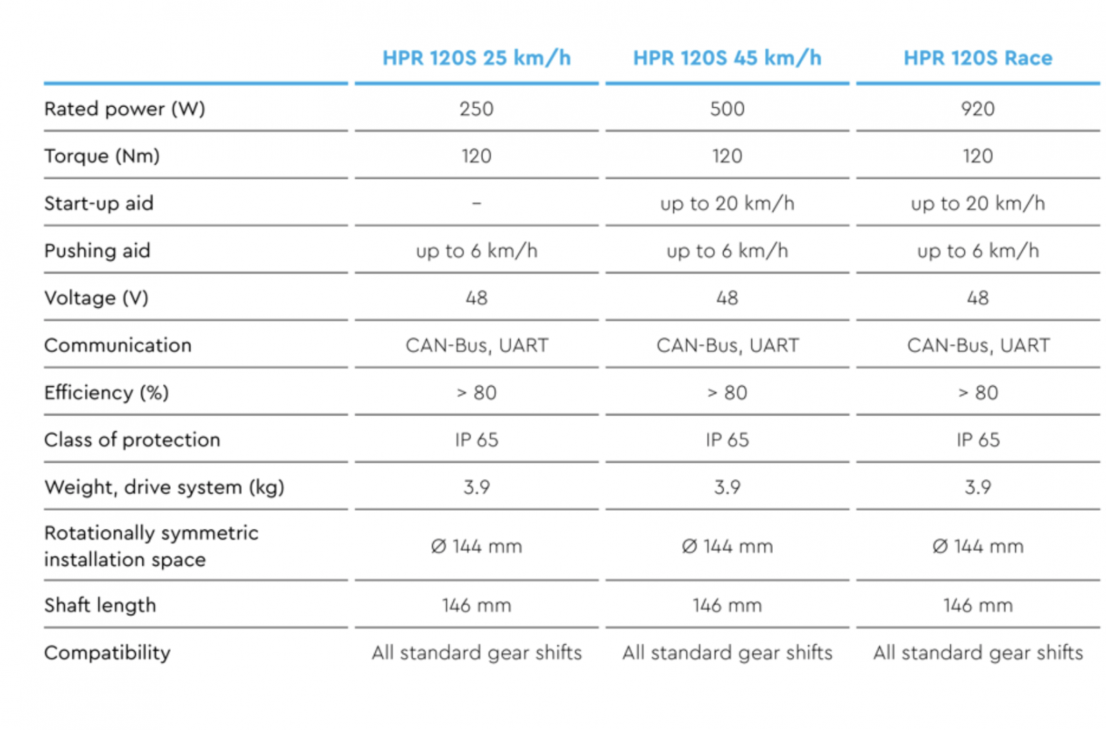

Engine need to have "rated" power as 250W and this can manufacturer declare. If its higher then cannot be categorized as bicycle/pedelec.
So if you take 1500W rated engine and cut a power of it to 250W then its still 1500W rated engine and no one will ask its cut to 250W or not. its engine not for bicycle/pedelec.
TQ 120 in the Haibike FLYON is the same motor as their 920watt motor, just software limited. I spoke with their engineer and its the same hardware. So theoretically, if I had that TQ app or software, I guess I could do the exact same?

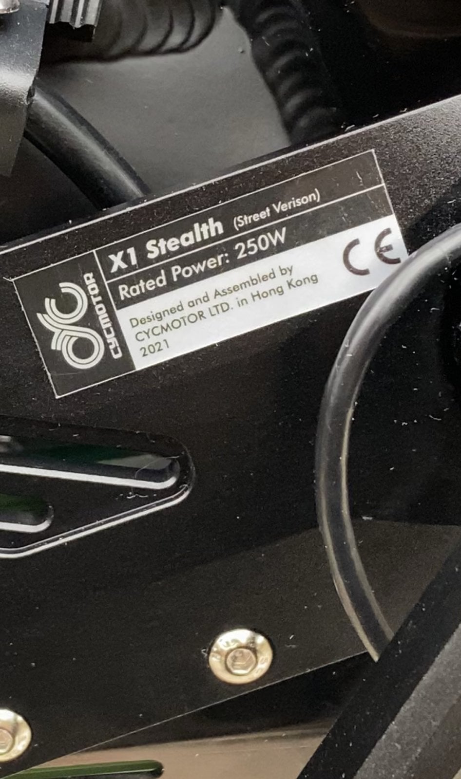

Also, my motor has this 250w rating on it:

If that is 'rated 250W' and some manufacturer claims that then should be OK i think. The peak power have no matter - important in case of 'rated' power is fact if manufacturer is claiming its 250W. I mean not by having a sticker - but as a builder of your bike i think in 'worst case scenario' you will need to be able to deliver some proof its 250W - for example declaration of manufacturer.
In overall its interesting but i would focus on legality for not having troubles - that is why i personally picked M500.
btw, its manufacturer label? have a typo :|

Bruchsal, Germany
btw, its manufacturer label? havea typo :|
Street Verison ?
This shows how serious this sticker is…
Time for me to chime in with all my prior research...
If Haibike CE certifies it (and not just by a sticker on the frame), they are legally on the hook for their fraud (which is precisely what they are doing).
However: There is one way they could be doing this legally:
By limiting peak power output to 250W in firmware as well. While the actual rated power of the motor would be higher, it would be technically impossible to reach a thermal equilibrium at a higher wattage during testing.
This would mean the bike has about 50% of the power output of the m500 and 30% of a bosch. So I doubt that's a good choice.
Hence I suspect they are just committing cheap-old chinese fraud.
