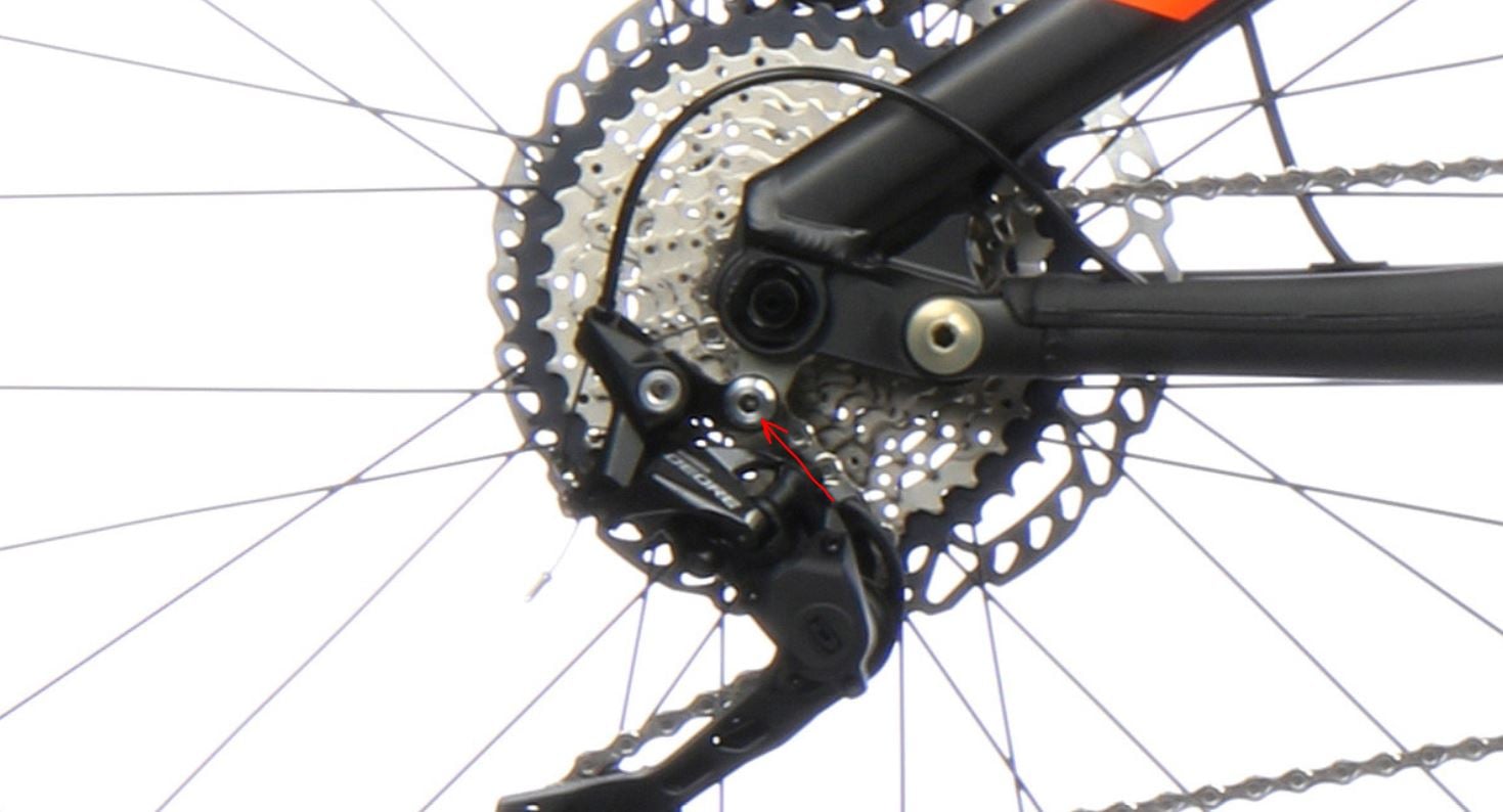

Sorry for been a bit thick but I only found out what a mech hanger even was the other week when my son bent his but is this the one that wants a bit of thread lock on Gary ?

Mech hanger turned up today, fitted the new one, threadlocked and the fit is fine, no movement or excessive wear to the seat stay from it coming loose... Phew! have kept the hanger part as a spare.

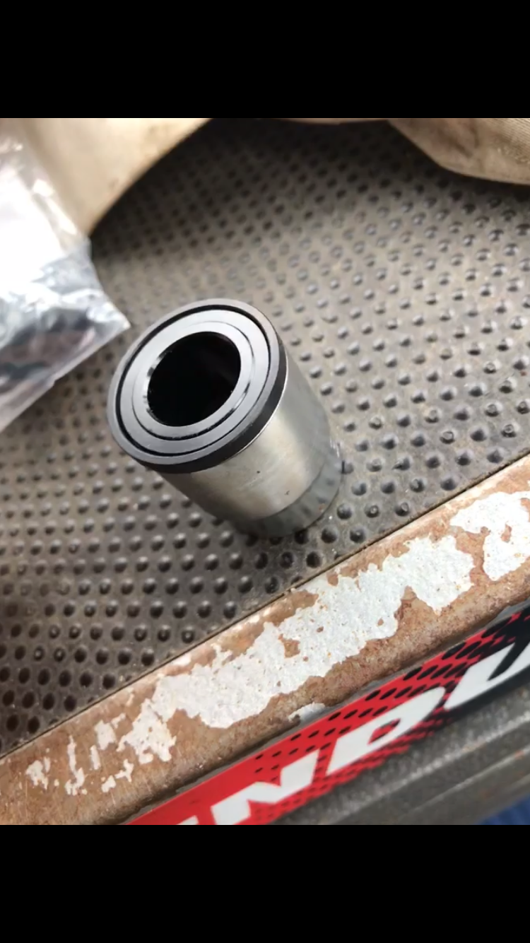

DT Swiss tools so expensive. I fitted the torque caps on my H1700 front wheel and happened to have a socket that perfectly sat over the cap but small enough to not catch the hub shell. The lock ring needs to be knocked in just below the hub but it's not going anywhere when the is fitted I suppose.
That's what I was looking for but didn't have any that would fit. What size socket did you end up using?
Might make my search easier.
Actually, thinking about it, 27mm OD PVC pipe would do the job perfectly I reckon. Pity there's not a plumbing supplier close by
googling 3/4" ID PVC pipe is 26.7mm OD so that sounds perfect

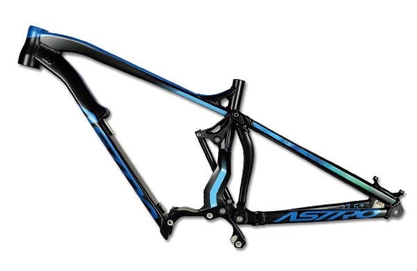

There are lots of similar versions of the frame out there, all a bit different, non with the Vitus geometry.
Thats because most are based off OEM frame out of Astro in Taiwan, who as it happens made the frame for the demo bikes when Shimano launched the E8000 System.
ASTRO Own Design E MTB Frame - Shimano E Suspension

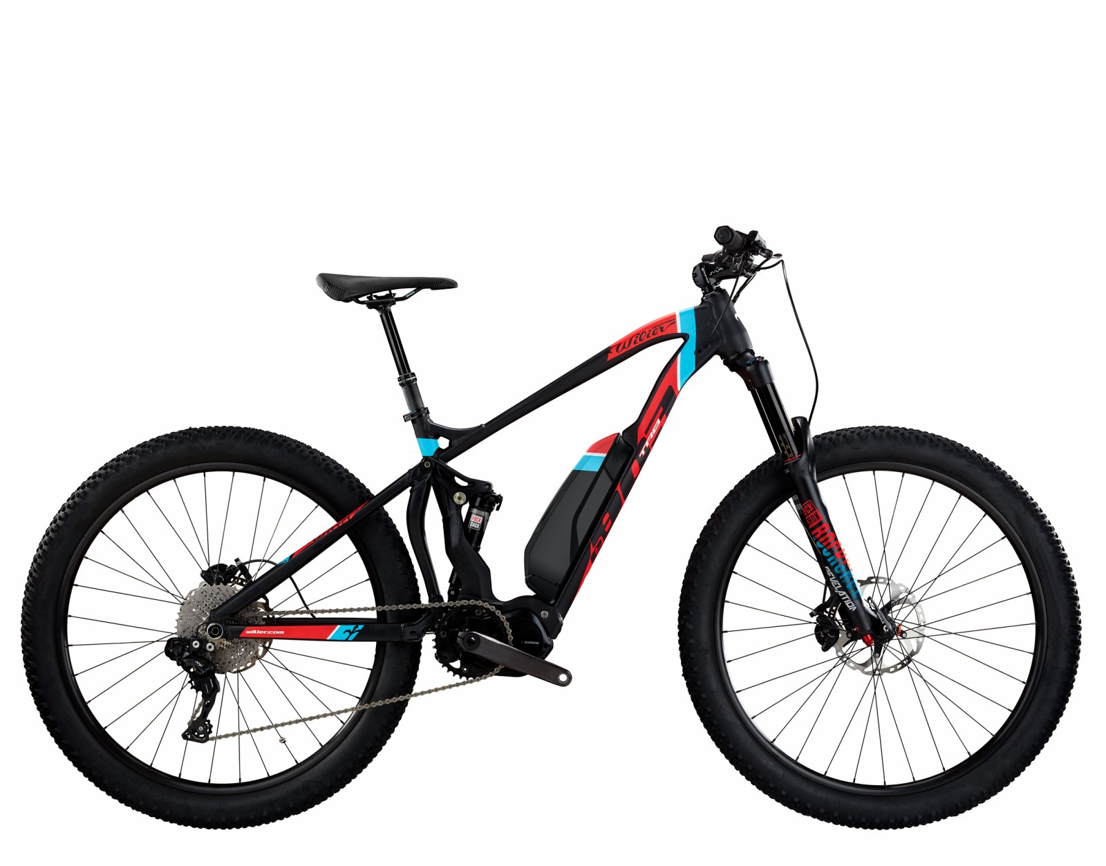

E.G Willier
What you tend to see is that some brands have different rear ends. A lot of brands just buy the generic frame ad badge it up, others use it s a base and change a fair bit - the commonality is the Zero suspension platform, and the down tube/bb area.

21mm socket should do it but I borrowed a 3/8 drive socket off a mate that had a thinner wall and fitted perfect.
Thanks mate. I had a 22mm here that was too thick but no 21mm. I'll try and raid my motorbiker mate's sockets next time I'm round there to make sure it's seated properly.

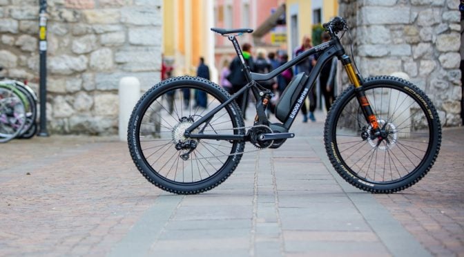

The KTM (Astro) frame I saw spyshots from interbike of looks promising. KTM did a great 27'5 Ironhorse Sunday (almost) rip off a few years ago with sorted (decently low/slack geo) that was ridden to pretty decent success in US National DH races. Hopeful they got their numbers and kinematics rigt on their Ebike
