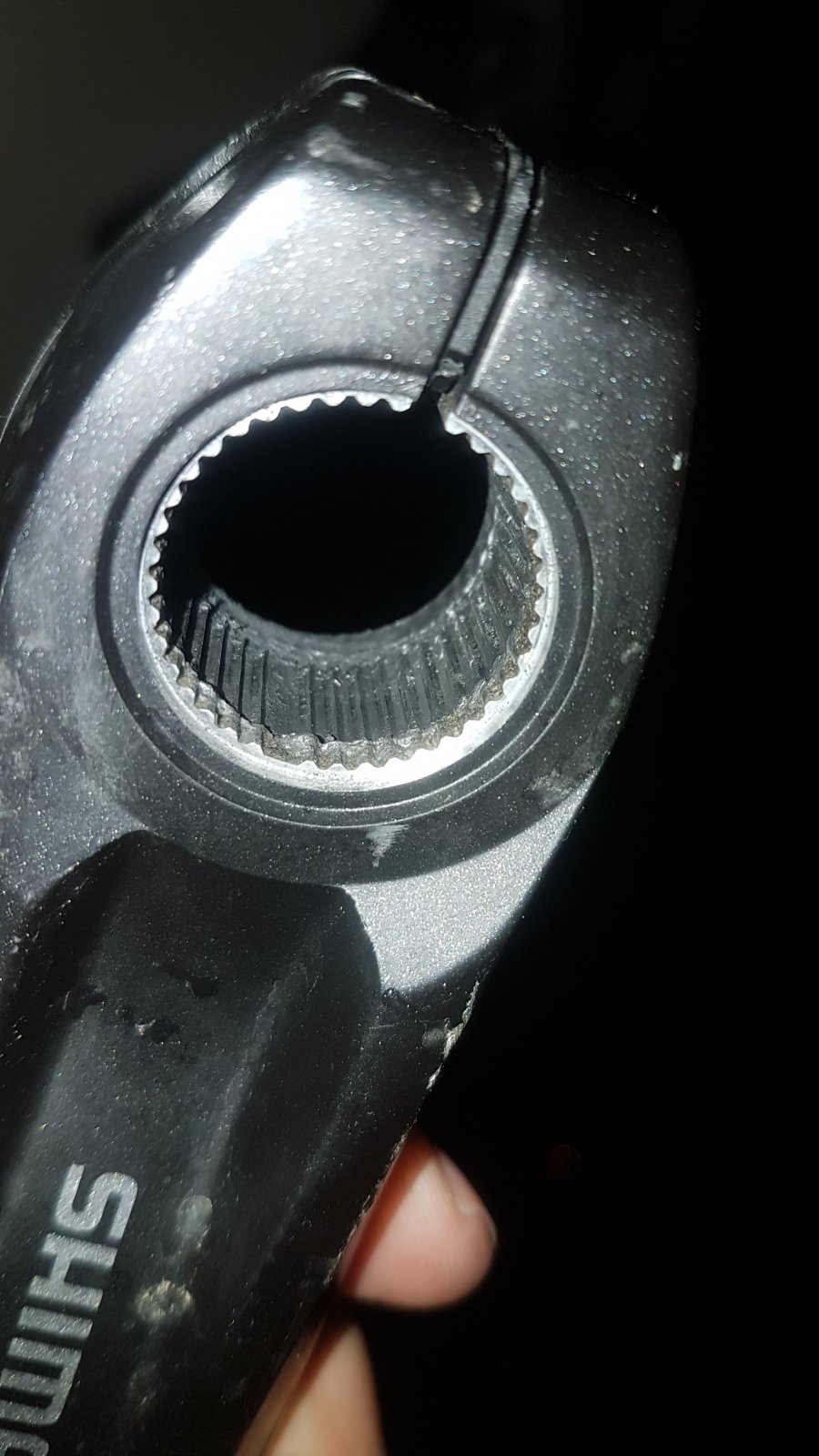

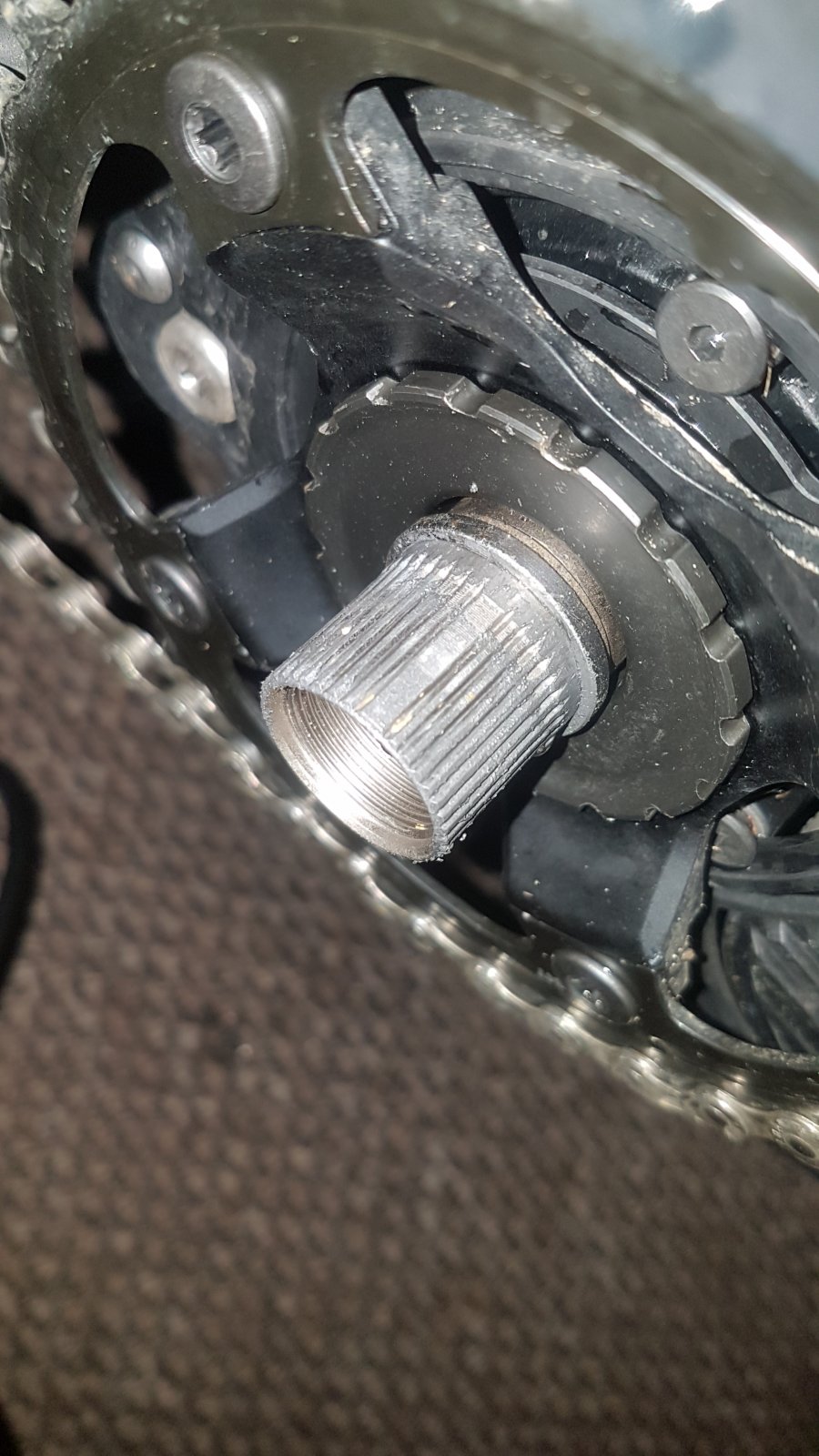

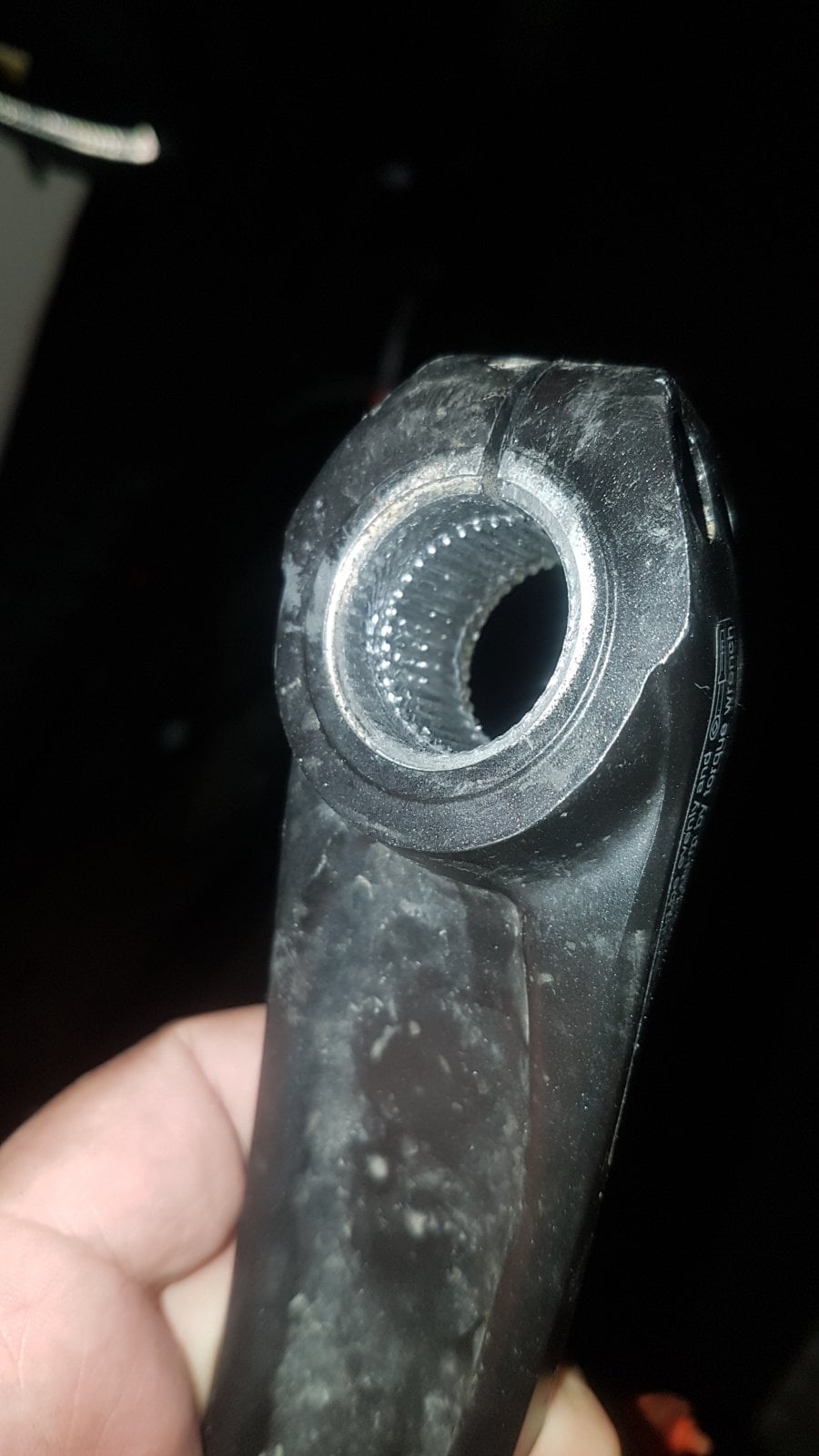

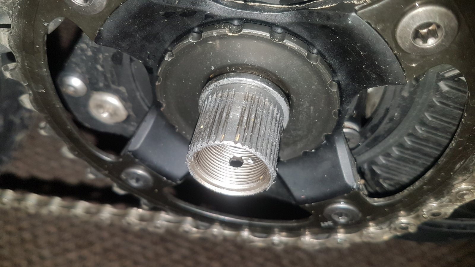

One of my cranks came off today, tightened it back up but it came off again, lost the end cap thing, Gary can I have a link to the metal ones you bought please, do these look too rounded off ? And is there anything else im missing ? Does something go in that small hole ?

the small hole is for the plastic spacer that sits between the pinchbolts. if the crank came off it's probably missing the tab that sits in the hole now. it doesn't matter.
Yes those bolts Dom linked will fit.
You don't *need* to threadlock anything but it's good security.
CRC/Vitus need to do those pinch bolts up tighter (and evenly) when assembling the bike. Even with my new motor I wasn't entirely happy with how tight the crank pinch bolts were.
Most of those bolts use a 10mm allen key so you'll want to carry one in your tools. I use a 10mm socket to use with the 10mm spanner on my multitool as it's less bulky (and will rarely ever be required out riding)

I cant help thinking there is a reason shimano made then plastic. most likely to prevent overtightening. seems a bit strange though since they could just spec torque low and recommend thread lock on it. idk.

Yes. That;s exactly their job. To stop you overtightening and deforming the clamp. The little tab does nothing to keep them on the spindle.

Most folk I know who're decently mechanical minded (ie. can turn an allen key without overtightening) throw away the spacer

The clown crank arms doesn't even fit the spacer, so no problems there :)
In regards to the end cap deforming the arm and/or spinde with an alu cap, it would think it will require some serious mismanagement of force to do damage. I dislike the plastic, but as long as I don't have problems with it coming loose I guess ill just keep it plastic.

Yeah. I use saints on all my other mtbs and they come with Alu pre-load bolts. (as do XT IIRC) Plastic bolts of any kind are stupid and anyone who specs them on a premium product is doing so to cut their costs. The Alu allen key ones are just handier for checking while riding if you sort out a 10mm hex for your tool pack.

Cheers ordered them and will tighten the crank bolts to the recommended 12-14Nm with a bit of thread lock and hopefully it wont happen again, luckily it was the end of my ride.
