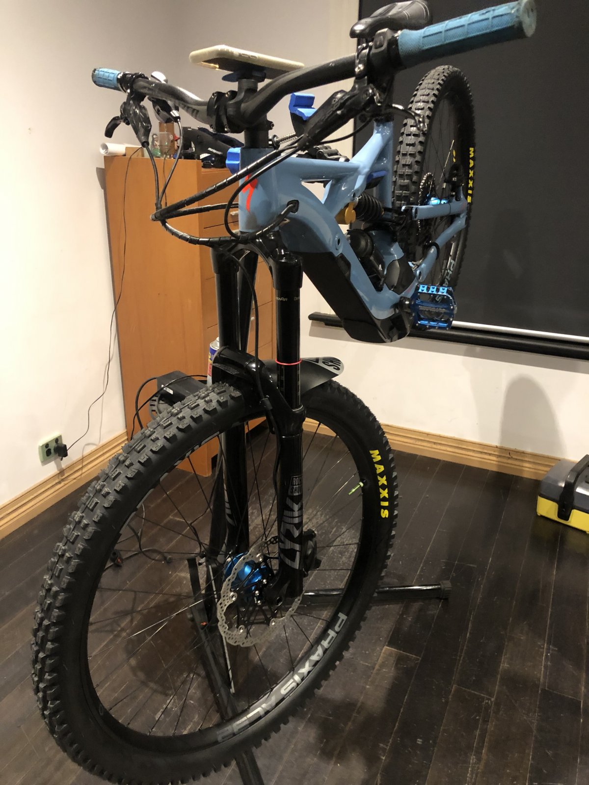

I just put them on my Kenevo. Haven’t ridden it yet but I’m taking them out in exactly 7 hours so I’ll let you know!
