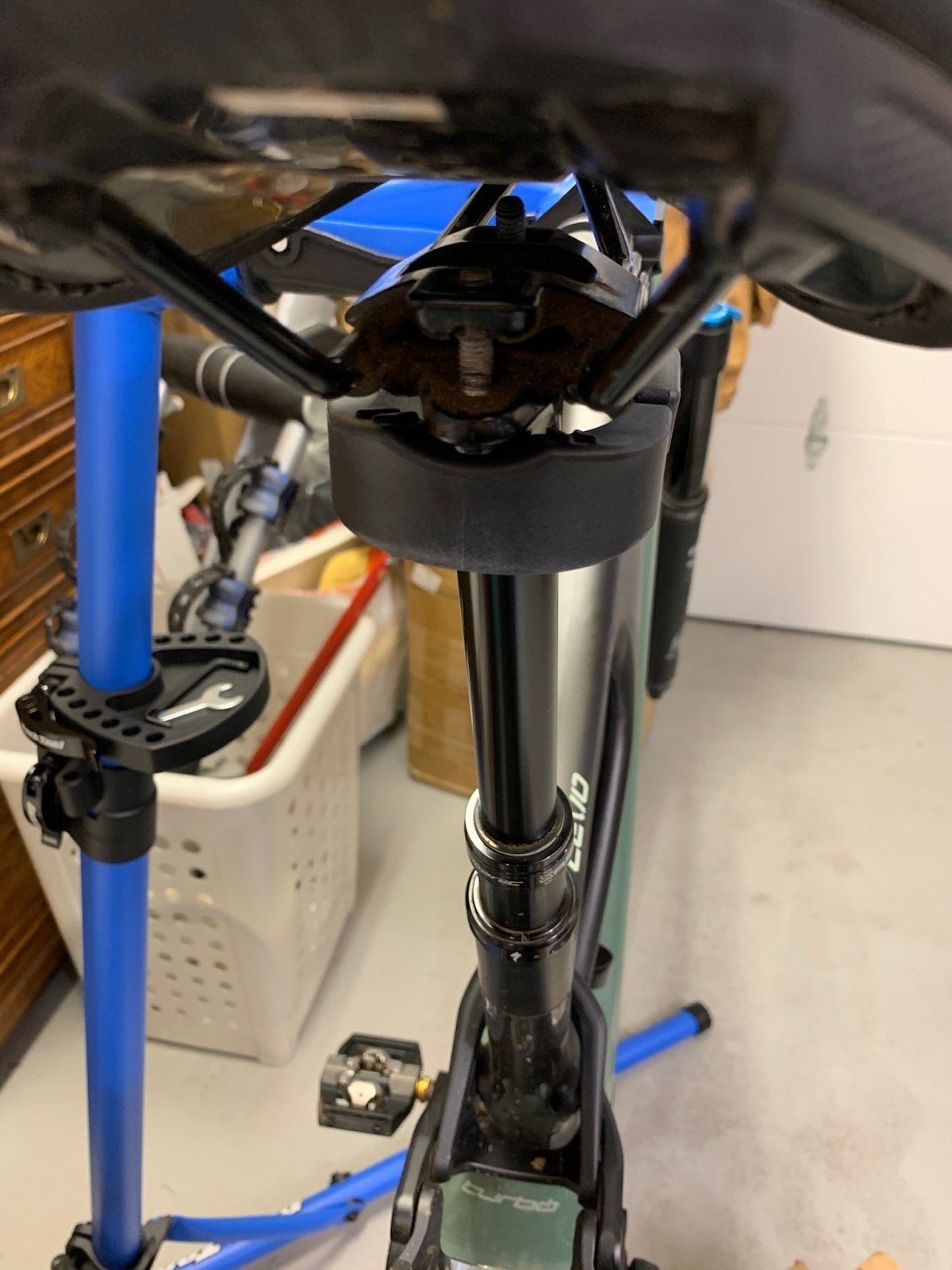

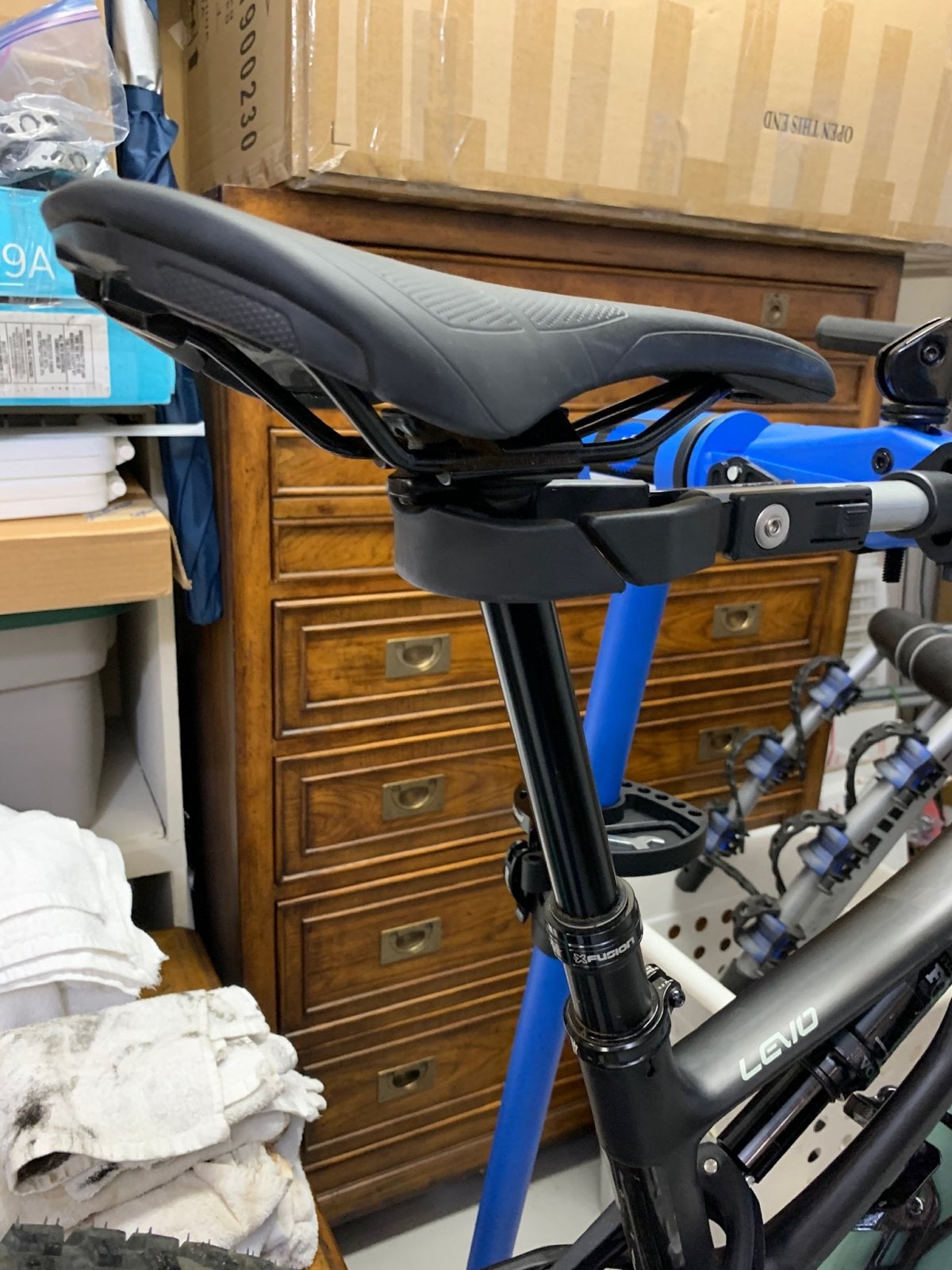

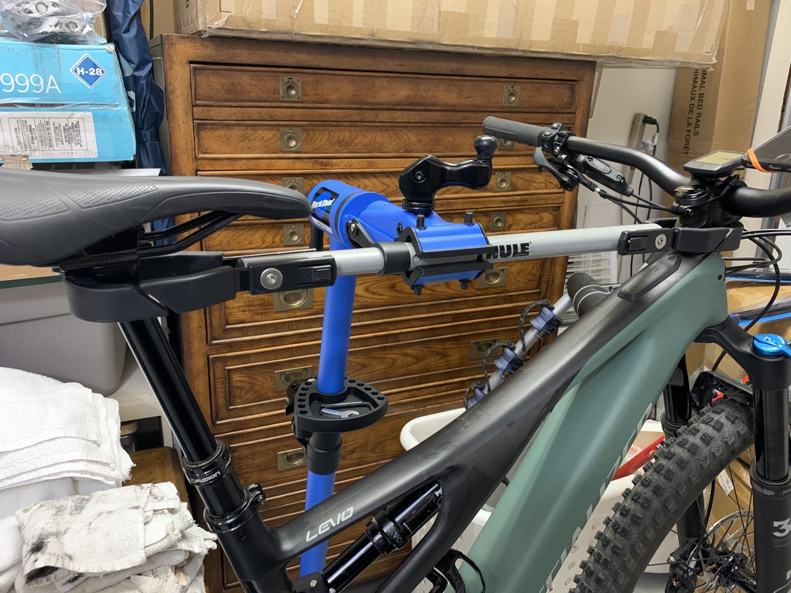

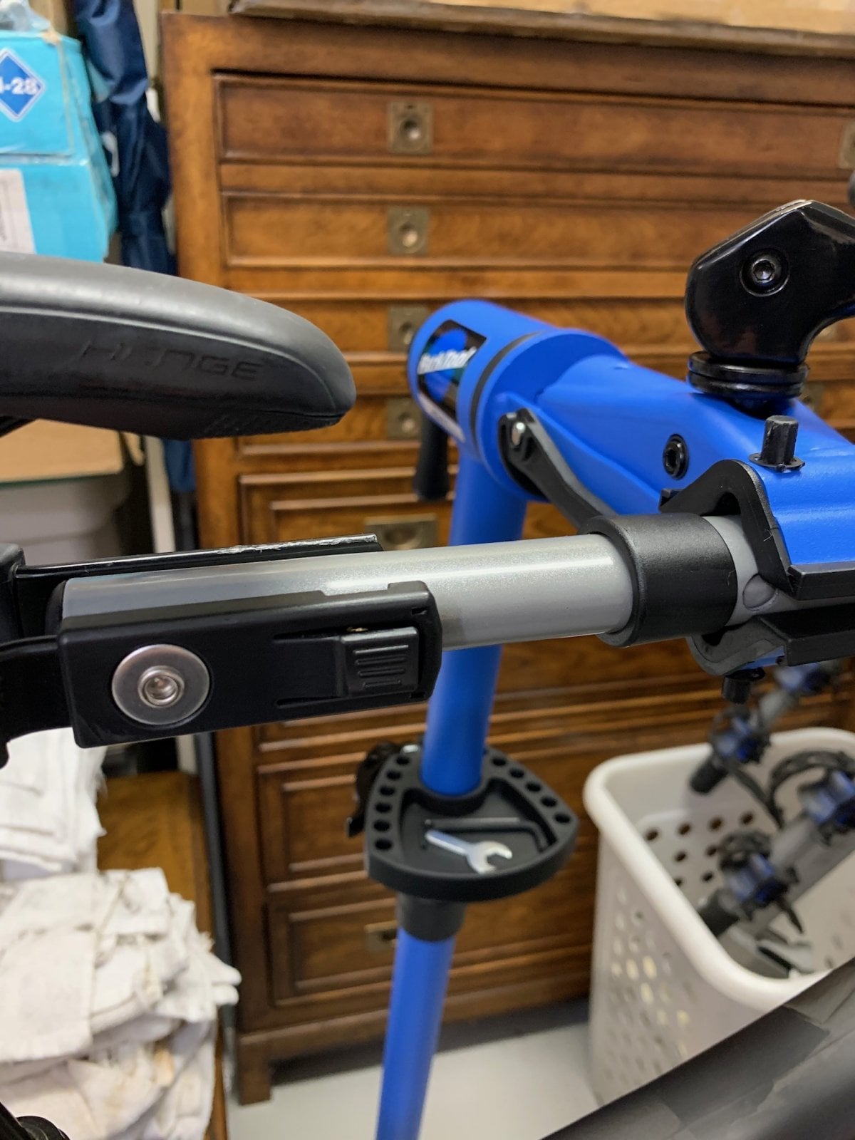

Is it possible to post a picture of the other end of the bar? It looks like the dropper post is fully extended with the Thule bar under the saddle?

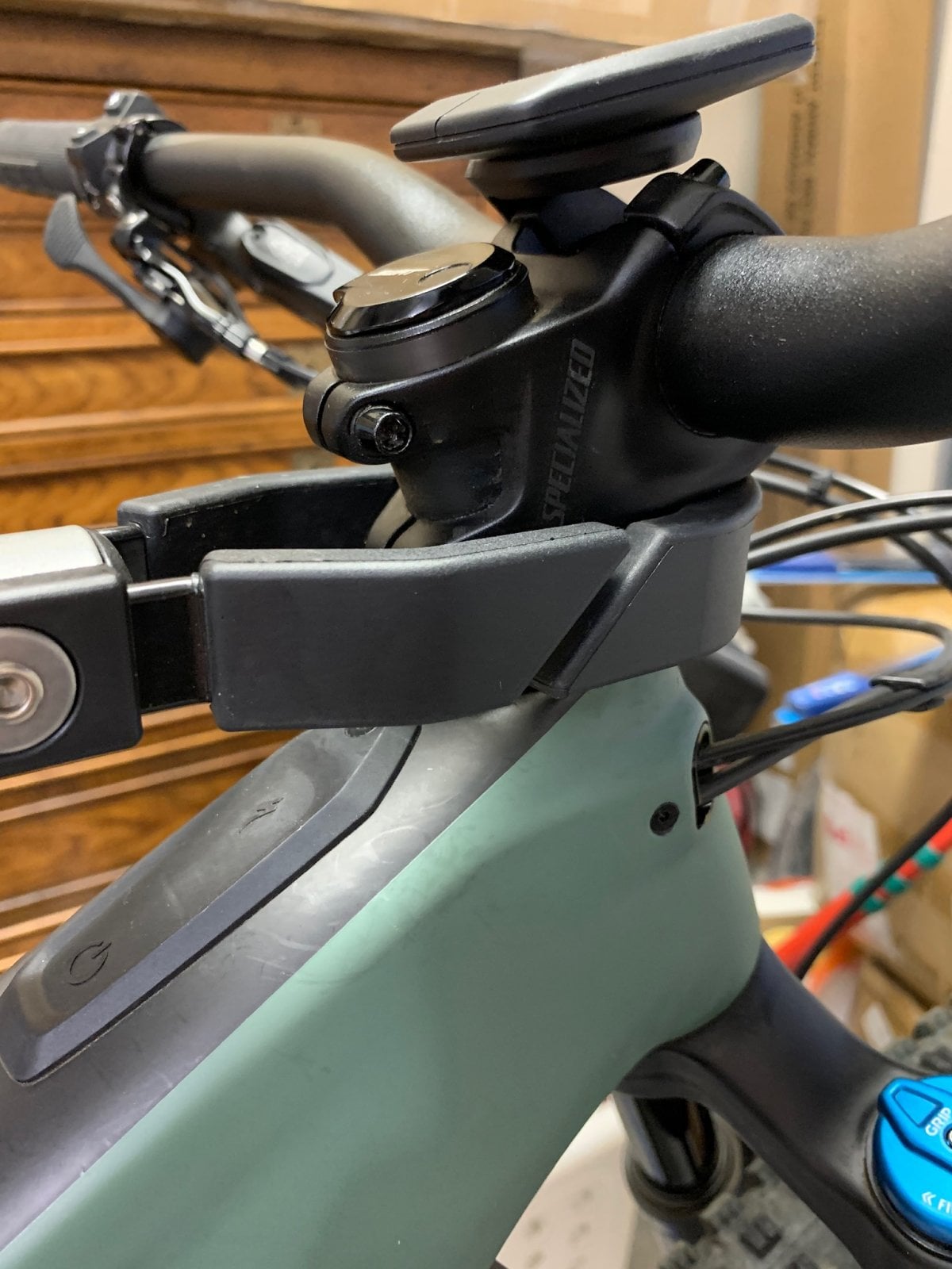

Here are a few pics on the stand. Not on the rack, but the position of the Thule bar is the same whether on the stand or the rack.
Yes, the dropper is fully extended, and as you can see from the close up pic, the hardware of the dropper sits perfectly on the Thule bar end.
I also included a close up at the front FYI. As well as a shot of the bar where the small tube slides in and out of the large tube. As you can see, the small tube is not slid very far out of the large tube. The Thule bar being rated at 50 lbs has to handle the smaller tube being much further out of the bigger tube. So I think with it being on the more compact end of the extension range, I have no worry about the weight on the Thule bar. My bike is a medium and 48.7 lbs.
View attachment 24656 View attachment 24657 View attachment 24658 View attachment 24659
Great! thanks coggbike, looks good, I'll look at getting a bar and see how I get on :)

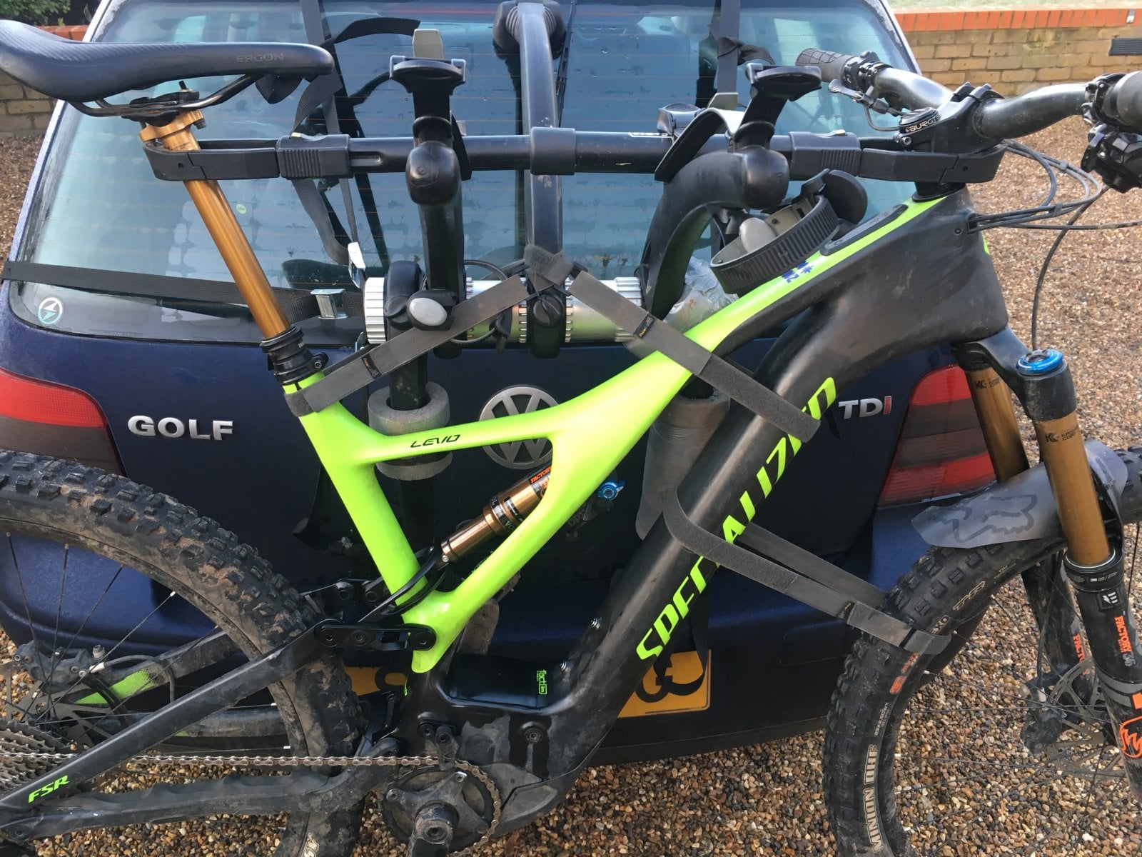

I’ve had no issue with mine for 1.5 years at the 15kg limit. The Saris one is more beefy than the Halfords one but it is quite a lot more.
As I say 3 Velcro straps and some Plumbers foam on the Carrier frame to stop rubbing. It’s been a perfect solution so far. I wouldn’t put more than one eBike on the back.
