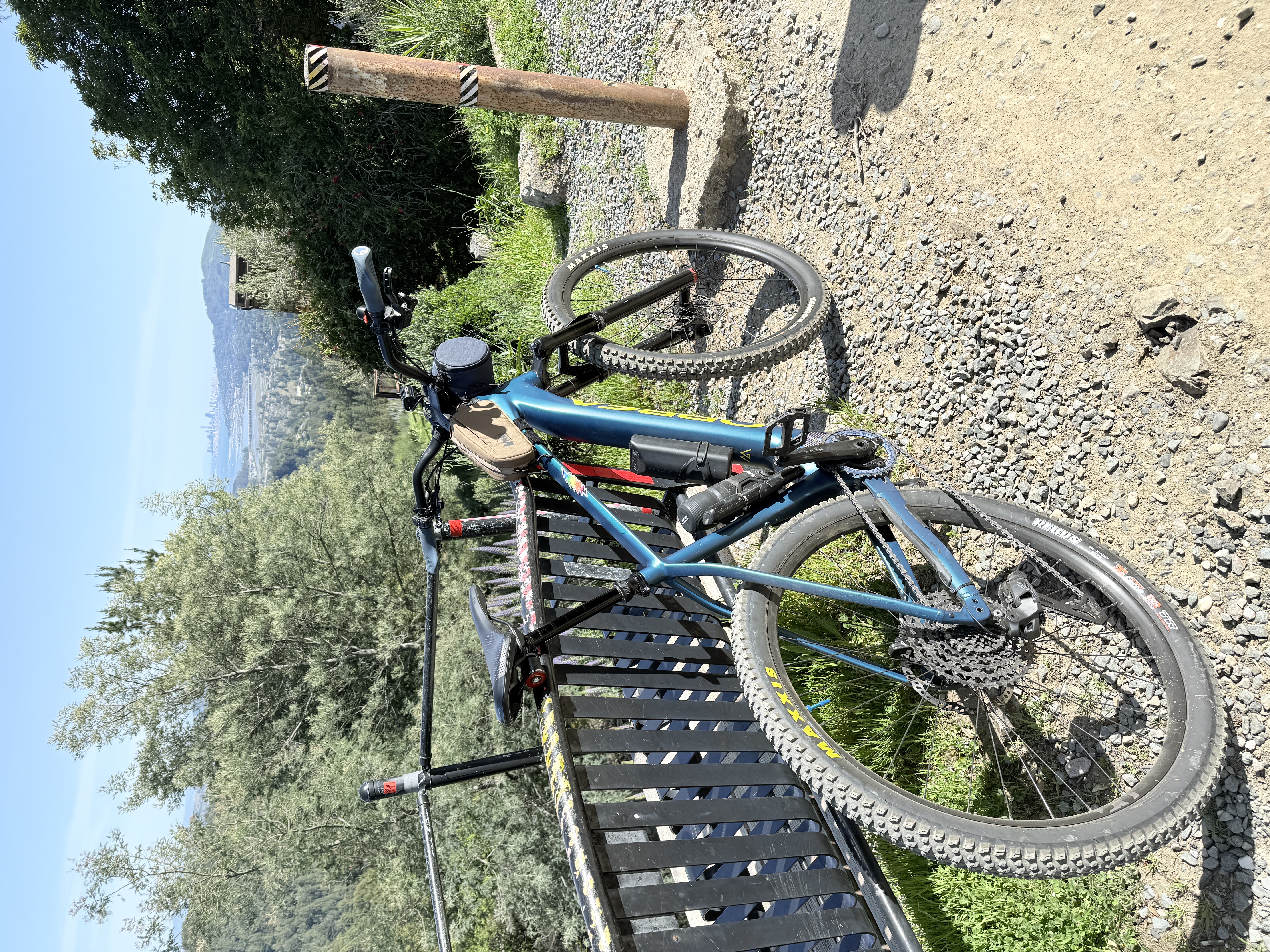

Hi,
talked to eMax over the last couple of days. I was able change the motors max power/torque ranges and it really made a noticeable difference. Im just waiting for a E600 display so i can fine tune the settings using the display.
Thanks

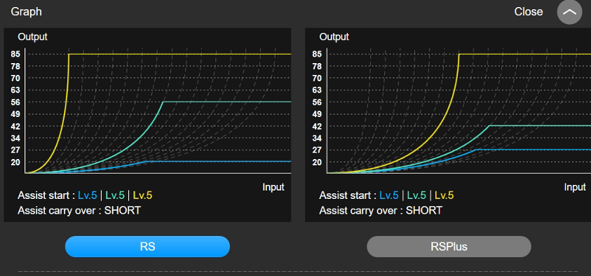

On an EP6-RS, you can change max. peak power (up to max. 500W on a DU-EP600) and max. torque range (up to max. 85Nm) as long as you currently have installed a motor firmware equal or less than 4.3.0 via the eMax - software tools (Bluetooth based eMaxMobileApp for iOS and Android or Windows based miniMax - program) already in the licence key free mode, see in chapter 12 of this document.
If you are already above this motor firmware and have installed motor firmware 4.4.1, then these settings can only be changed via cable bound SM-PCE1 or SM-PCE02 interface and the Windows based miniMax - program, but no more via Bluetooth. Maybe this forum post may be interesting too.

The reason for this is very easy and clear: Orbea didn´t like that everybody knows that Orbea is cheating their customers publicly and their reduced "RS" (Riders Synergy "BS") drive units are not "specially developed by Orbea" (like Orbea claims), but are just "ordinary" standard drive units with ordinary original plain motor firmware from Shimano with reduced settings for max. peak power and max. torque range, see e.g. here.
There is, there was and there never will be any "very special developed - RS -" motor firmware from Orbea - Orbea uses the ordinary original motor firmware from Shimano since the beginning of their "RS" drive units.
So Orbea for sure did not like it at all that everybody could easily increase these values on their "RS" drive units with the tools from eMax-Tuning already in the licence key free version and get the full potential of these motors.
So Orbea insisted that Shimano will create a new motor firmware on which this hidden functionality (which is available since many years already in the Shimano STePS system, long before the "RS" drive unit was "invented" already) will be deleted via Bluetooth in one of their next versions (which now happened).
However, because also in the future it is very important that Shimano (and Orbea) can use these functions for changing max. peak power and max. torque range after production (e.g. if Shimano uses a hub gear which is not able to withstand high torques) you most probably will still be able to use this hidden functionality also in the future via a cable bound PCE - interface and the Windows based miniMax - program from eMax-Tuning. :)
So, yes, you need to get access to such an interface (e.g. this SM-PCE02 one) and then also to a Windows computer - otherwise there is no way anymore to change these values if you are already on the latest motor firmware 4.1.x on a DU-EP801 or DU-EP600 drive unit.
And again: Never update accidentaly a Shimano STePS drive based bike to a new firmware if you don´t exactly know what you are doing and have a look to the compatibiltiy of eMax-Tuning first (see e.g. in chapter 12 of this document), if you are using these tools, otherwise this easily can ruin your day and create a lot of frustration.
The latest version 4.4.1 does not give any single advantage (but only disadvantages) compared to the previous version 4.3.0. Sounds strange, but is fact.
