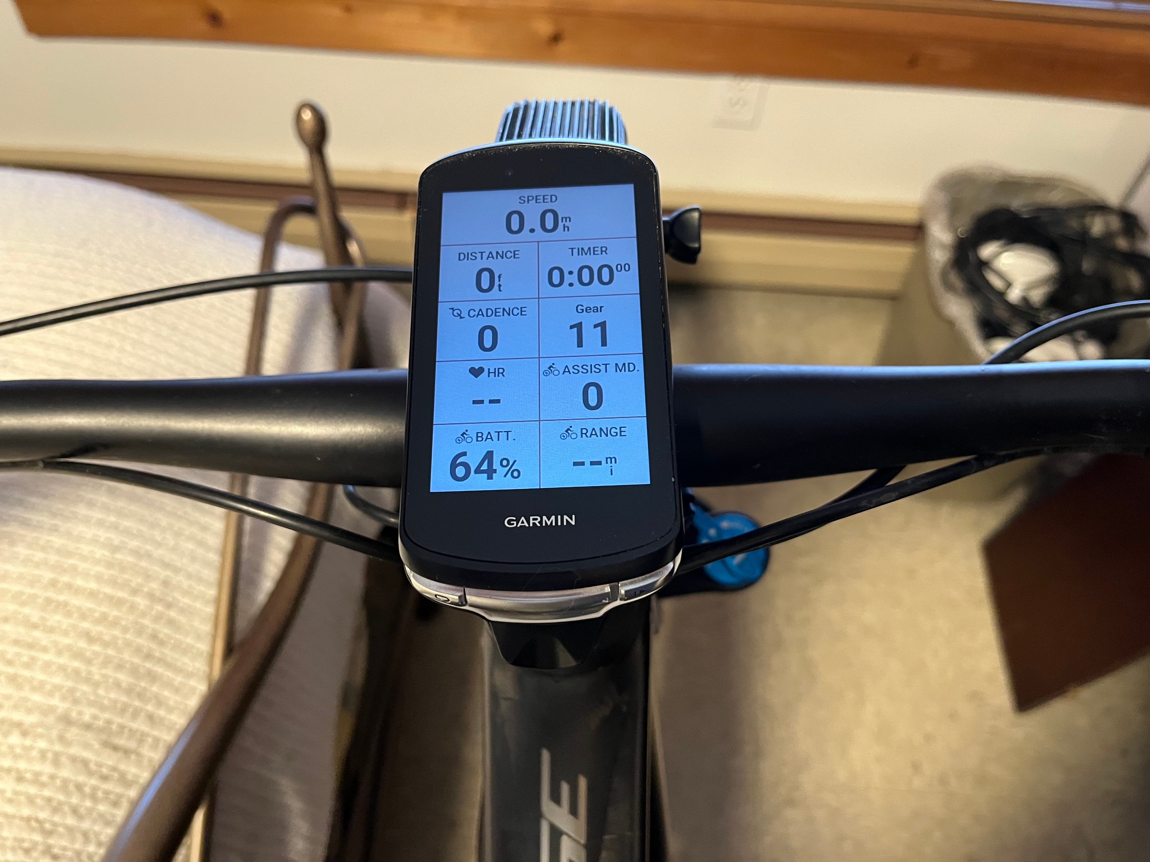

If the cost of a Garmin is an option I think it looks better, is more customizable and gives you more data options than the Shimano unit. It mounts in the center using the mount that came with the bike as opposed to off to the right of the stem. Also the connect app will track MTB stats like jumps to review at the end of your ride.
I use an edge 1040 using just the default ebike fields for speed, distance, cadence battery percent, assist mode and range, and use the AK MTB Gear optional data field from the connect IQ store. I tried the RS Toolbox but found it showed things I didn’t need to see and wasn’t customizable.
