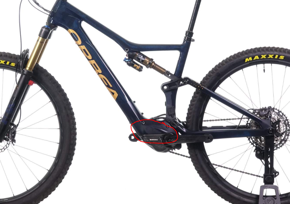

Yeah but you can't get to them as the chainring is in the way anyhowOh BTW. If you undid the top 2 motor bolts. The motor should swing down on the rear bolt, and give you access to the ports.
You don't have to drop the motor....... Maybe ......![]()
They know best.How does the dealers hook up to the computer for the motor upgrade if you don’t have the EN600 displa. I have a 2023 M10, and they telling me they have to drop the motor.

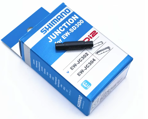

I took my 2023 H10 in for the update and stood by while the girl did it. I’m glad I stuck around, because I figured it out for her. Fortunately this adapter was included with the new stuff they ordered, in order to hook up my bike to their computer. Worked perfectly!Then use the 4 port connector, and plug the switch back in. You will need an extra SD300 cable.
