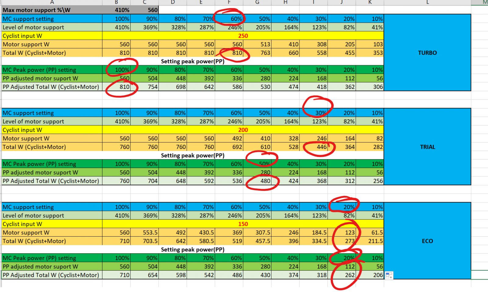

Hi, based on the post from Specialized in this thread I have created an excel table which calculates the support given by the motor based on the support setting in mission control and the rider input at cadence 70-90 RPM. If I interpret everything correctly, this shall give a good direction how to setup your own custom settings in Mission Control (MC).
Turbo: I know I can sustain to pedal with 250W average for 20 min. This means that at 60% support setting I will be already getting the maximum support level from the motor and using combined power of 810W, enough for 20 min of climbing the steepest hill possible to climb. So I set my turbo to 60% at 100% Peak power.
Trial: Let’s say I want to sustain 200W on average for the whole time I use trial mode (typically on flat to 5% incline). If I set support to 30%, that would give me 446W total average power, enough for good tempo and fun on the trials, I can even reduce peak power to 60% and still be able to use 495W average total power.
ECO: Let’s say I will want to be able to ride transfers with 25km\h on the flat in the most economical, but comfortable way. I'm 86kg and based on past experiences I know I need around 250W to sustain that speed on flat fire road. I know also that 150W are very comfortable for me for even long stretches of time. That would mean I need additional 100W from the motor which I can get from 20% support (123W). I can set peak power to 20% to further limit the motor to max 112W input.
See the picture below with the highlighted numbers to better understand my fuzzy description ?.

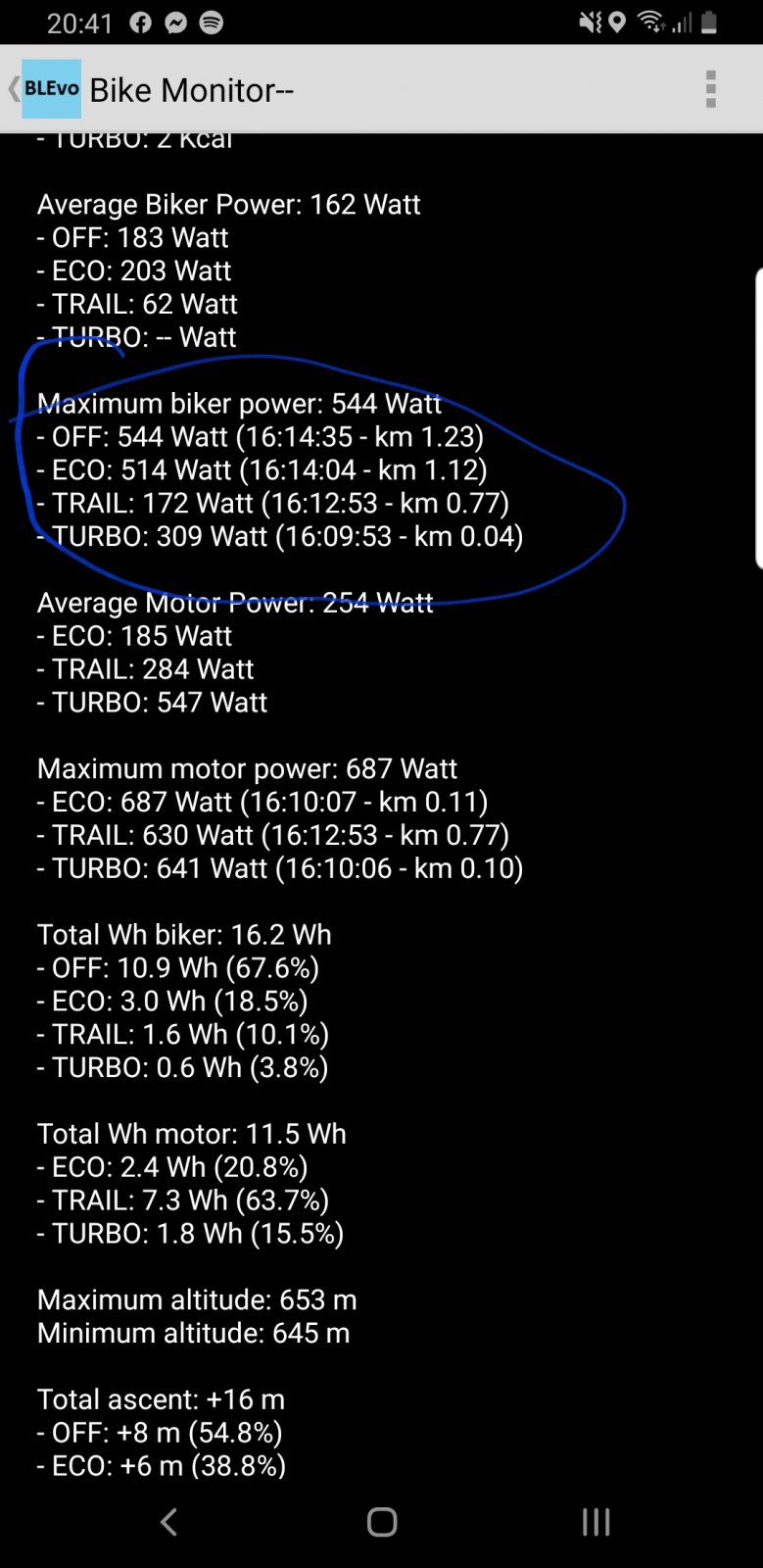

I have a question. I've always wondered how this Blevo stat is possible:
Advanced user - 10/30/70 PP 30/75/100 ACC 0% Shuttle 0%
Maximum motor power: 756 Watt
- ECO: 330 Watt (17:27:11 - km 7,65)
- TRAIL: 750 Watt (17:45:29 - km 12,51)
- TURBO: 756 Watt (17:24:16 - km 6,58)
If 100 % = 756 W then with eco the max should be
0.3 * 756W = 227 W. My Blevo says 330W.
Can you explain this?
Hi @Mihail , thanks for your helpful contribution!
I think I more or less thought in the same way but approached it from a different side to end up with more or less the same result. I use BLEvo Smart Power function and with the function via the optional O_Synce remote I change the leg power threshold during the ride so BLEvo's algorithm then automatically adjusts the support% within a preconfigured range. If you like to experiment with this too, check my post below:
@PaoloBLEvo , can you maybe comment this? Maybe there is difference between a max theoretical wattage setting (227W) and a short peak of overshoot of wattage in practice possible?
The Official BLEvo Thread - EMTB Forums
I saw this remove on some BLEvo youtube videos and i was wondering what is that. I have just found it from your post, thanks for that. I will order one and experiment with it as suggested. It would be great if i can make it work with my Hammerhead Karoo bike computer aswell.
The only thing that I can say is that the value is received from the motor..
BLEvo doesn't do any calculation..
Maybe this is a peak value and not the "average value"..

My understanding from the Specialized post on the first page of this topic is that the max real motor support is 560W, not 756W, i guess 756W is the maximum electrical draw from the motor?
I have just bought BLEvo yesterday, so i didn't experiment with it yet, hence i don't have an answer to your question :(.
Yes. Assistance level is made by limiting current drawn from motor. Not by limiting the real assistance output. Max current is 20 A. Max output watts is related to battery voltage level which it can keep when drawing this 20 A max amperes. So reverse calculation 756 W / 20 A = 37,8 V. If we assume that efficiency in that moment is 0,75 then the real assistance power would be 756 W * 0,75 = 567 W.
Efficiency is not related to my question. I was wondering how the power drawn from battery can exceed the limit set with PP. Looks like this is happening. And after this we can evaluate the excel calculations. It's a nice sheet but there might be some more variables that is affecting assistance power and max power drawn from battery.

I figured this out by myself. Maximum watt readings are measured when I'm changing from Turbo to Trail or Trail to Eco. Higher power level don't stay on so this is just echo from previous assistance level. And of course as you can see I'm not talking about assistance level, I'm talking about power level drawn from battery.

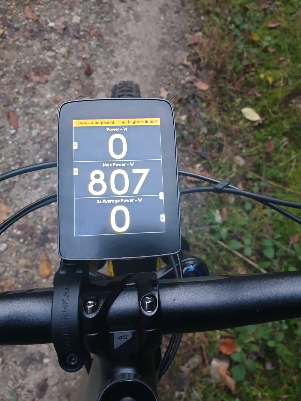

As promised i did peak power comparison. My road bike on Wahoo Kicker Power meter 973W, Levo 719W but measured with the Karoo computer, next time i will check it with BLEvo and share back. But I'm starting to think that it is lower, as when motor is helping, it impacts the signals to our brains making us think we are at the max, while we are not. You know some say 40% of our muscle power is locked i our brains:). I think this can be verified with a test with support off and even with the whole bike off which i will do:)
I have tried max rider power also without assistance. No luck breaking 600 W limit with Levo. Could help if could see the power from display when pushing the limits. But my phone is always in backpack. Or maybe I'm just stronger indoors with Wattbike and both readings are correct :).
I did some experiments today. According to the data from Karoo, first I was able to produce Max 709W which is consistent with the previous attempt. Than I dialed the preload on the fork to the max, and i stiffened the shock (I have Levo 2020 comp with rock shock suspension). This enabled me to register 807W on the Karoo. However when I looked at BLEvo, the same effort was recorded as Max 544W. So I think there are two things into play. First the suspension eats lots of Power compared to the stiff Watt bike, and second BLEvo and Karoo are interpreting the data from the same sensor differently. Tomorrow i plan to ride for 1 hour with Garmin, Karoo and BLEvo recording the data, to see how this will compare in term of Average and Max power.
