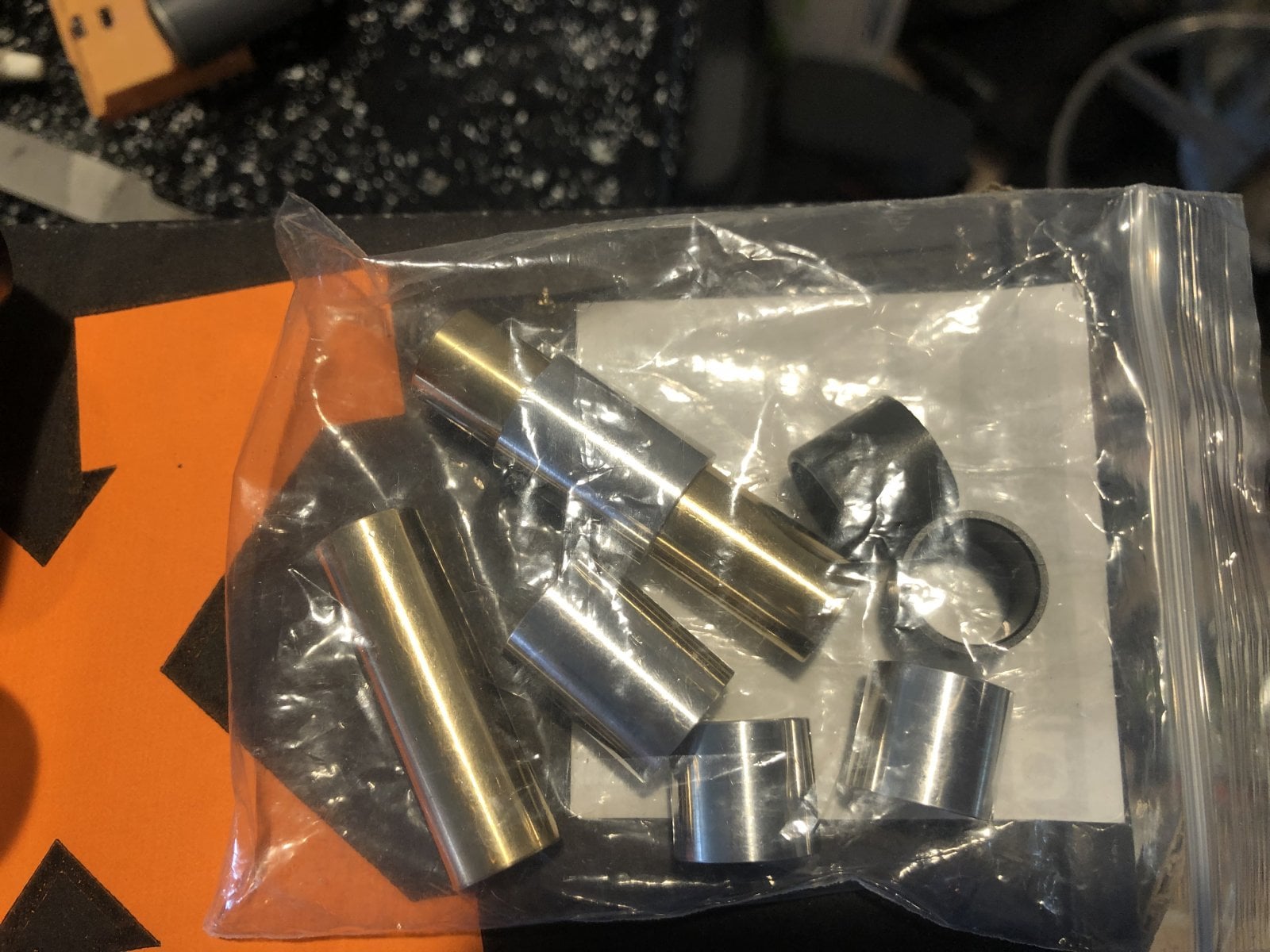

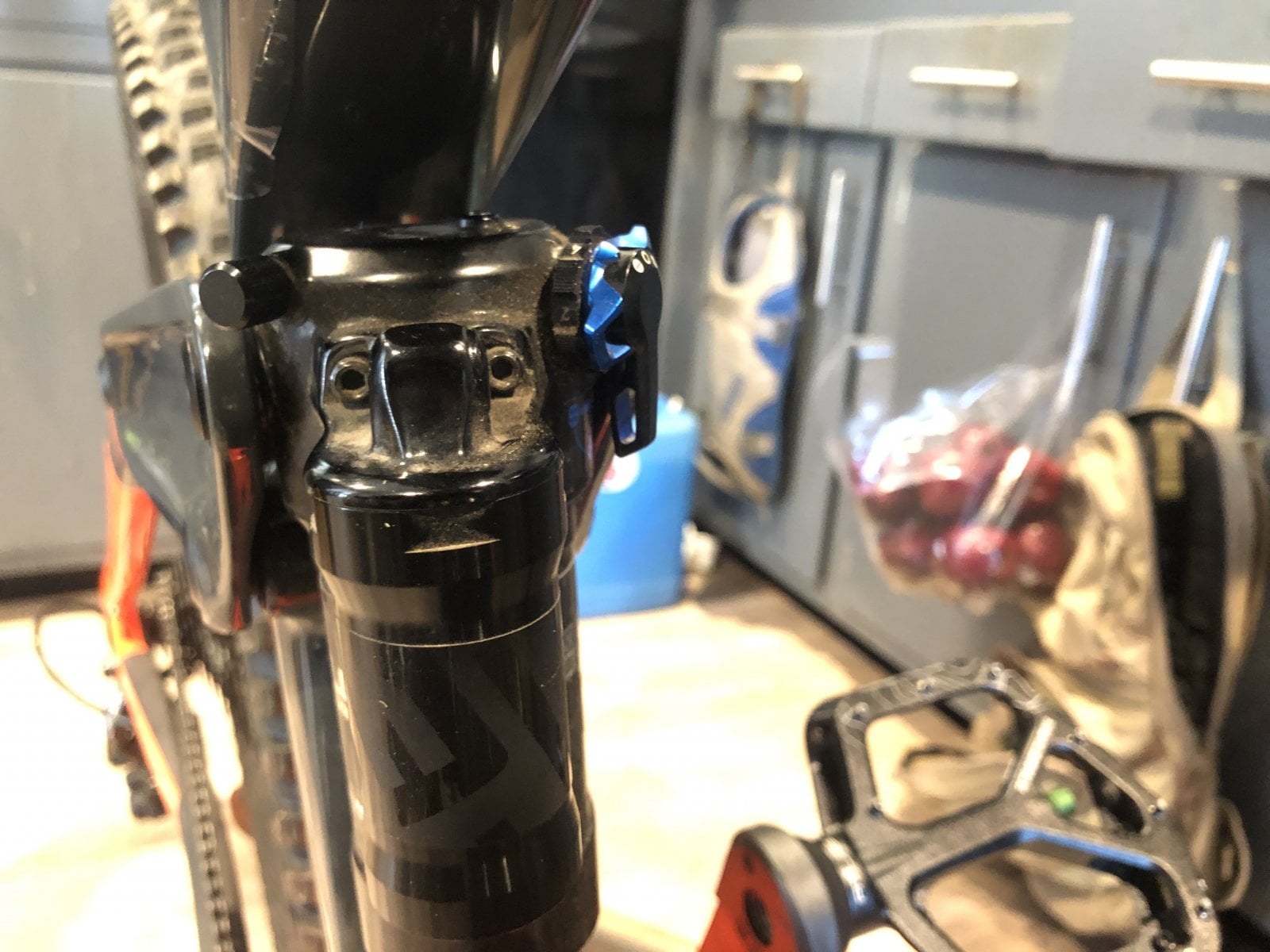

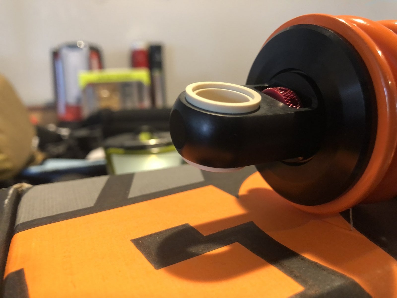

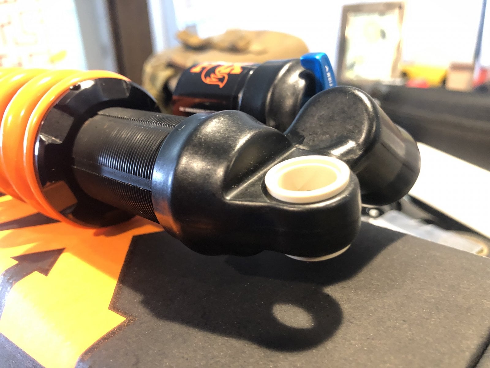

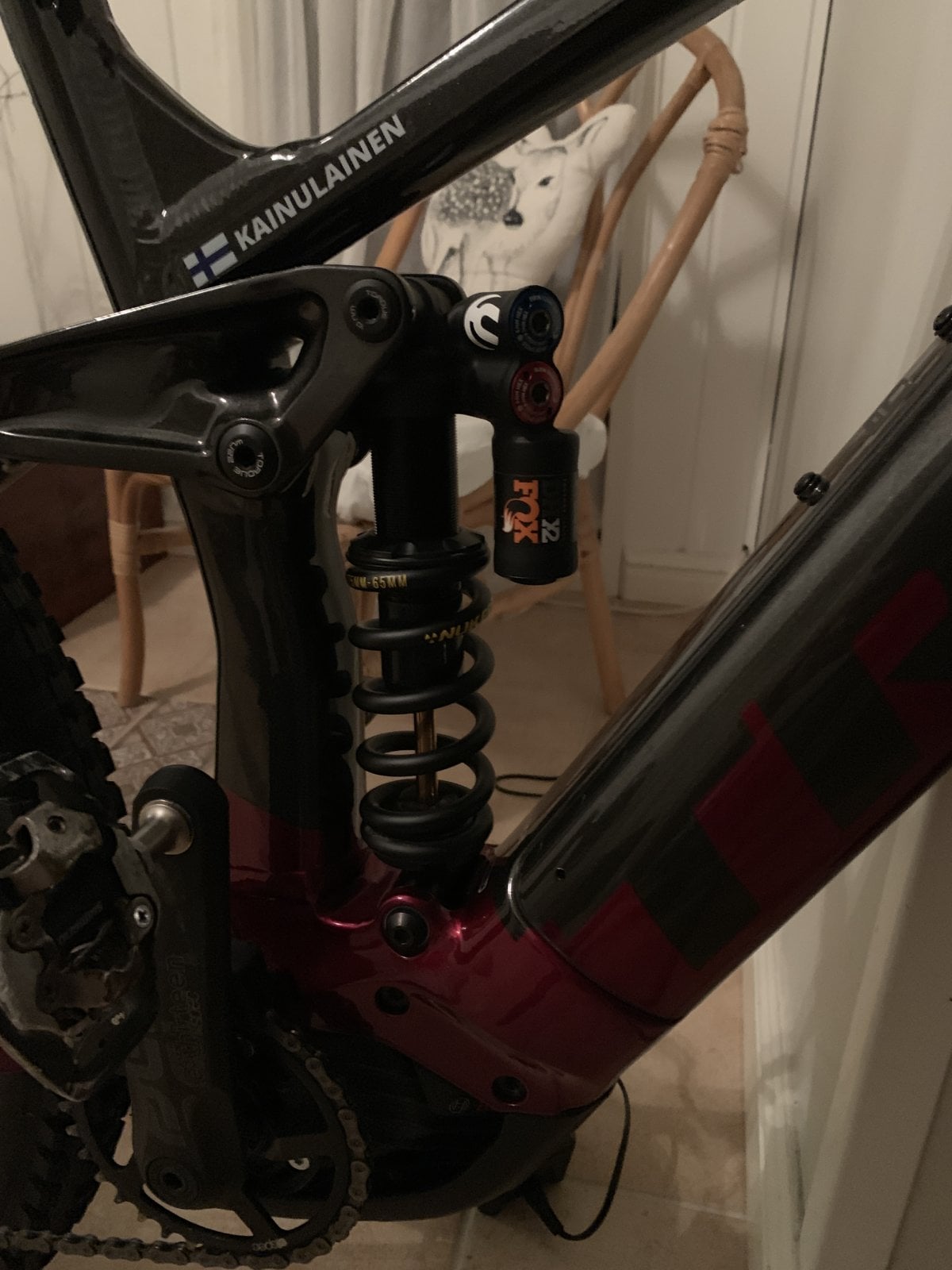

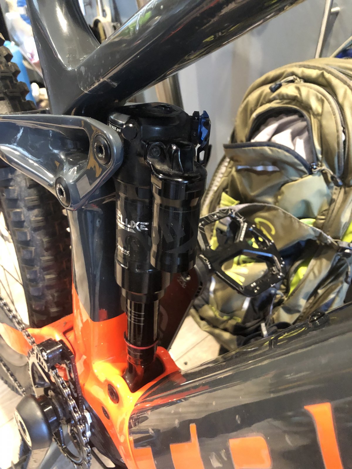

Ok after reading carbon frames vs. ally frames Im wondering if the fox shock I have with the @offsetbushing kit I got is even going to work. Do I have the right shock and bushing setup for my frame? the top look drastically different on rockshox compared to fox.
BiGJZ74
Mar 17, 2021
573
444
American Canyon, CA
Ok after reading carbon frames vs. ally frames Im wondering if the fox shock I have with the @offsetbushing kit I got is even going to work. Do I have the right shock and bushing setup for my frame? the top look drastically different on rockshox compared to fox. View attachment 65305 View attachment 65306 View attachment 65307 View attachment 65308 View attachment 65309 View attachment 65310
To use The Offsetbushing hardware you have to remove the Fox white IGUS Bushings and insert the black DU bushings from the kit. then press the 54mm long piece thru the top bushing and then the sleeves over each end....repeat for lower. The hardware from thelostco.com shop I sent u the link for was Fox specific so it would use the White IGUS bushings that are factory installed....plus their sleeves are black which will look a bit better
Im still waiting for that hardware to land, Hopefully it makes more sense when I can see it in hand.

We at Offset Bushings can produce standard shock bushings for you if you'd like to upgrade from the thru shaft to a standard shock! Hit us up if you have any questions :). They're £28.80 (including VAT in the EU, £24 outside of EU) + postage.

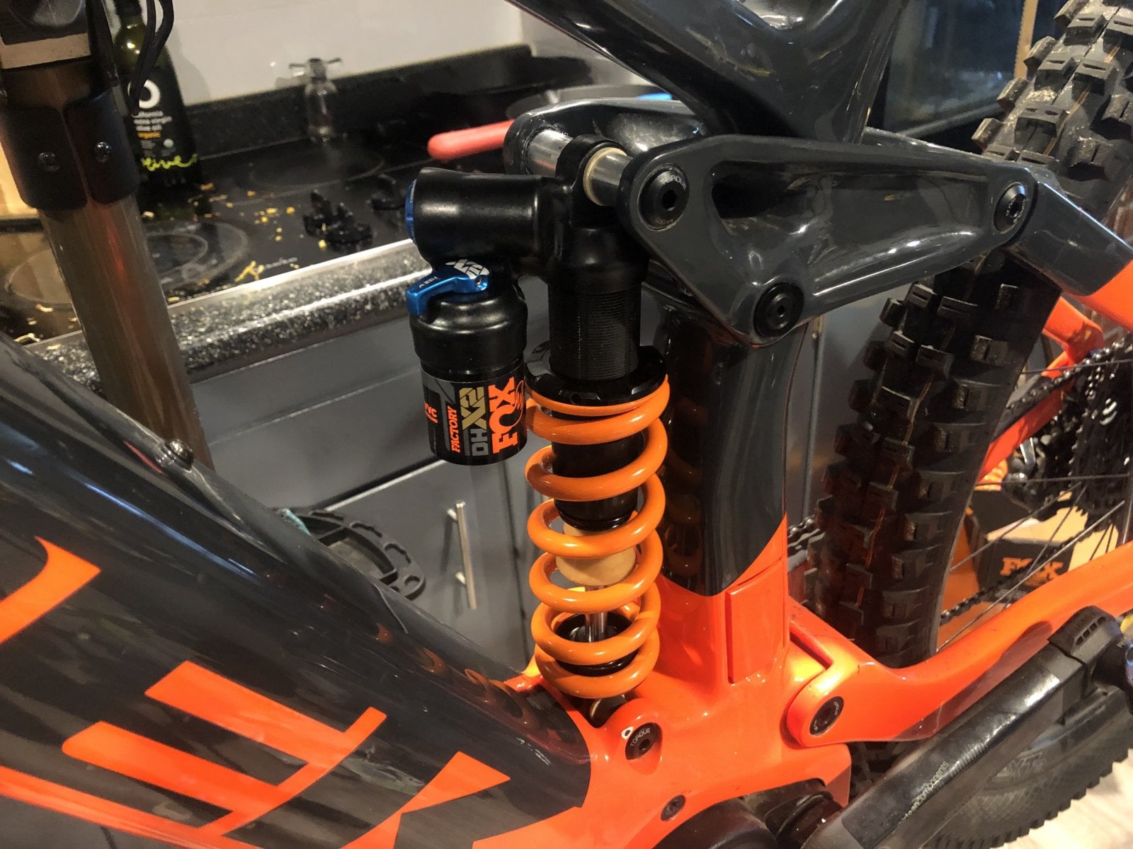

AGAIN< I ordered a set from you, and I would love to know what it should look like when assembled 21 trek rail 9.8 carbon frame and a 22 fox DHX2 coilover.
Richiefromboston
Mar 15, 2021
228
123
Boston, Ma. USA

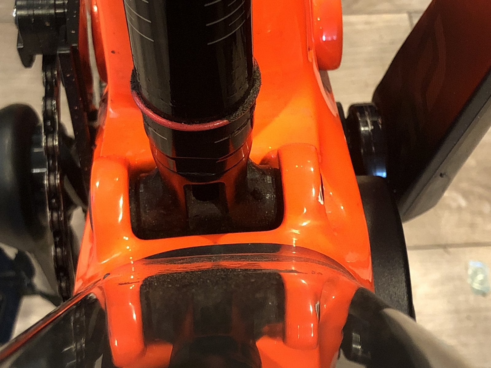

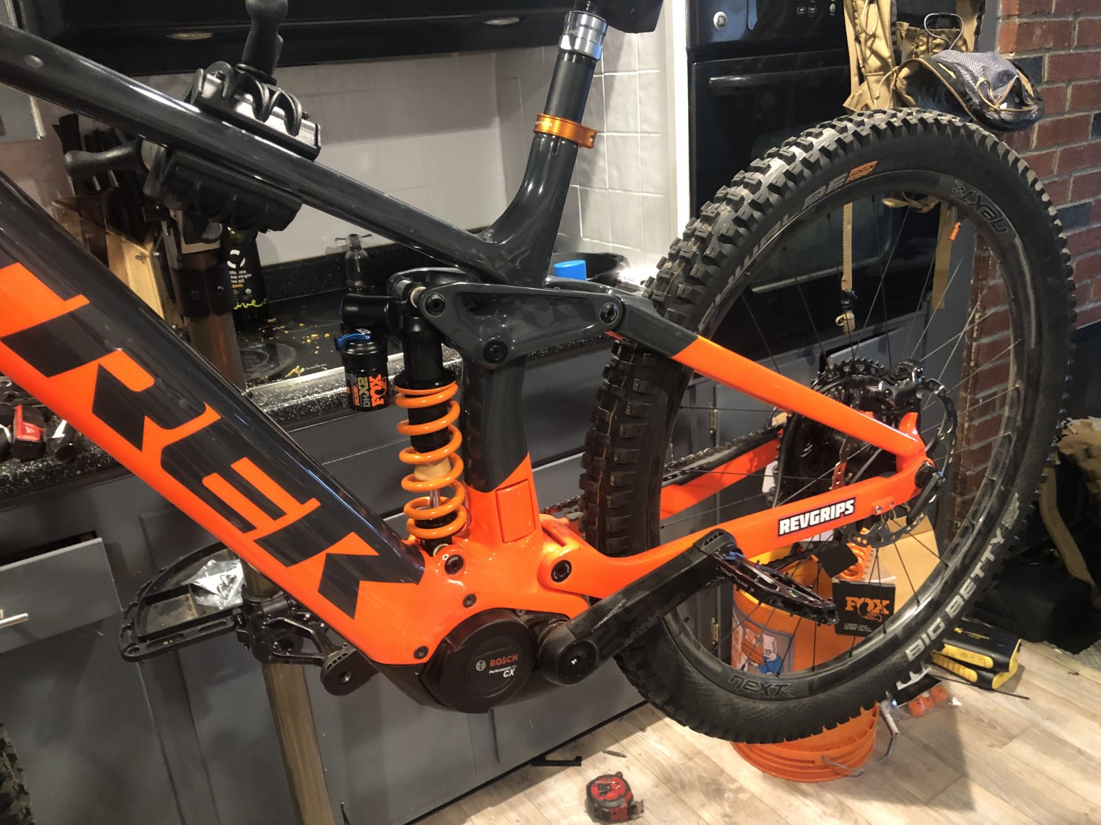

Ok even though I Should be running the trunion mount version I used mounting bolts from Trel and the hardware from Uk offset( after filing them down a lot, and got it to go . And the ride difference is what I hoped it would be. I was expecting nothing to be honest but with a 550lb Fox spring its perfect. I weight 230lbs Im going to do a walk around video of bike tomorrow Ill post the link up when its done.
the $$ tag on this entire build hit 16K just for reference. ya gotta love those chips in the paint already bike has about 90 miles on it and 2 goodly crashes.
BiGJZ74
Mar 17, 2021
573
444
American Canyon, CA
the $$ tag on this entire build hit 16K just for reference. ya gotta love those chips in the paint already bike has about 90 miles on it and 2 goodly crashes. View attachment 65761 View attachment 65762
So u had to file down the silver sleeves because u used the IGUS bushing instead of the DU bushings from the offset kit. Looks great!
Richiefromboston
Mar 15, 2021
228
123
Boston, Ma. USA
Or I have the tools to remove the Igus Bushings and install the DU bushings to make the offset hardware fit properly
or theres that, But i filed down offset bushings they werent right size meaning I will be replacing the hardware with better hardware. Ill send you a close up pic
