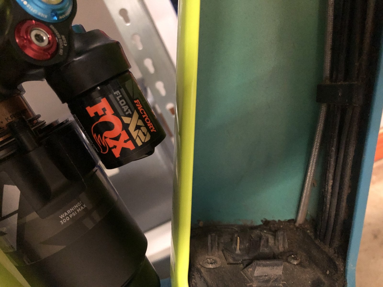

No you don't because the air shock has an internal rubber bumper that also compresses. That's why I just cringe when I see someone post a pic like in post 21 of this thread "claiming" they have 5mm of clearance to spare... would love to see the downtube now after some big hits.

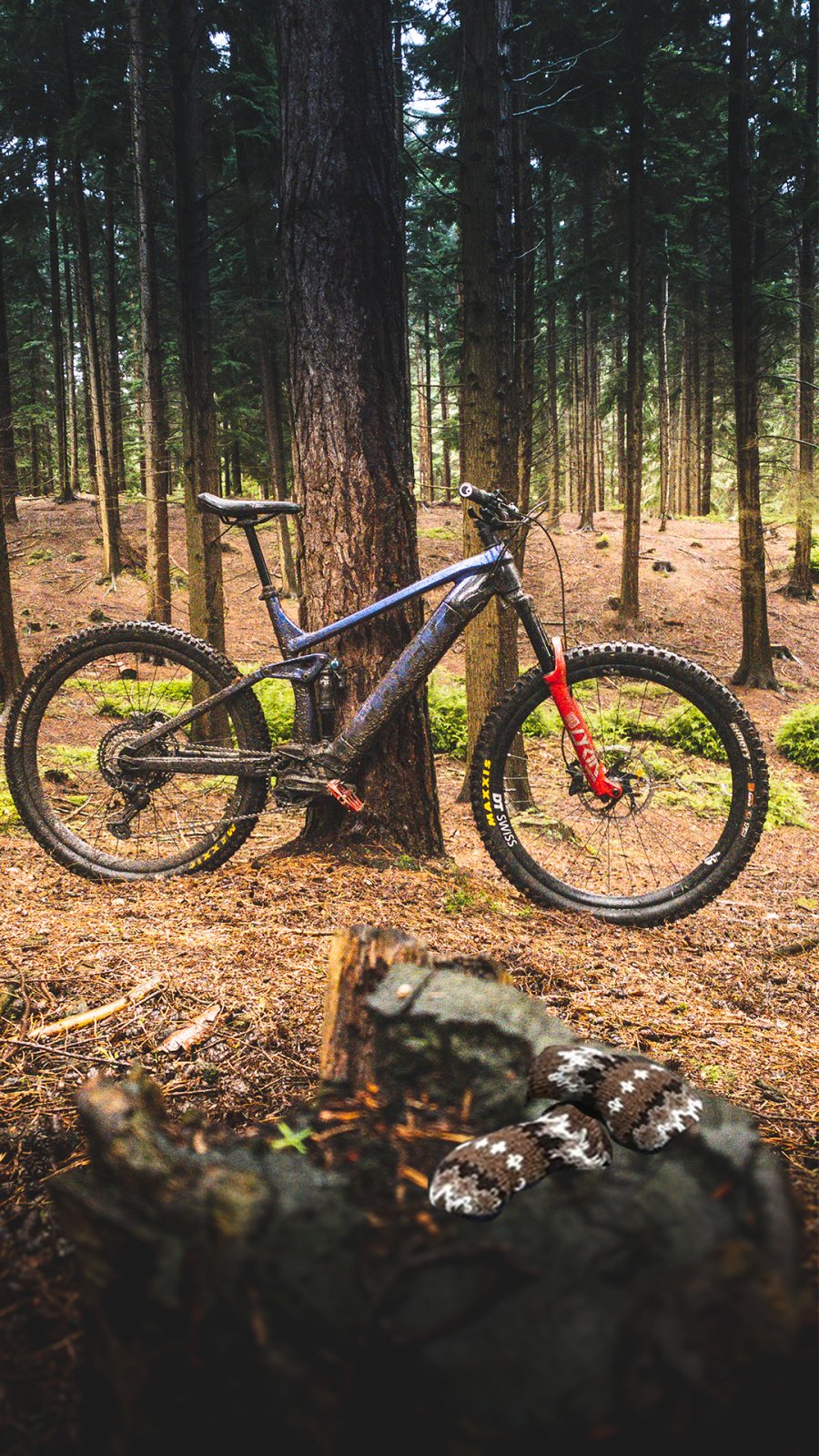

Post 21 is mine, and i can guarantee it has never hit the downtube on any big hits, so all your cringing has been in vain
You’re probably now default thinking if thats the case it can’t have been taking hard hits, but thats not the case either, its had a fair number of heavy landings and the odd unplanned flat landing. It doesnt get an easy life, and also has a few koms (if thats your measure)
perhaps the clearance is more than 5mm, i didnt measure it with a ruler 😀

Sorry that I ruffled your feathers Jamo... my point is simply that the clearance in your pic is NOT the actual clearance. Glad it worked out for you and I would suggest a follow-up post or edit saying as much versus slapping a shock on and saying "it's good". On my medium Rail I wouldn't be so sure... also why I got the Jade X and not the Fox X2 as I know for certain it's fine with the longer 60mm stroke (that I wasn't going to compromise for the way I ride).

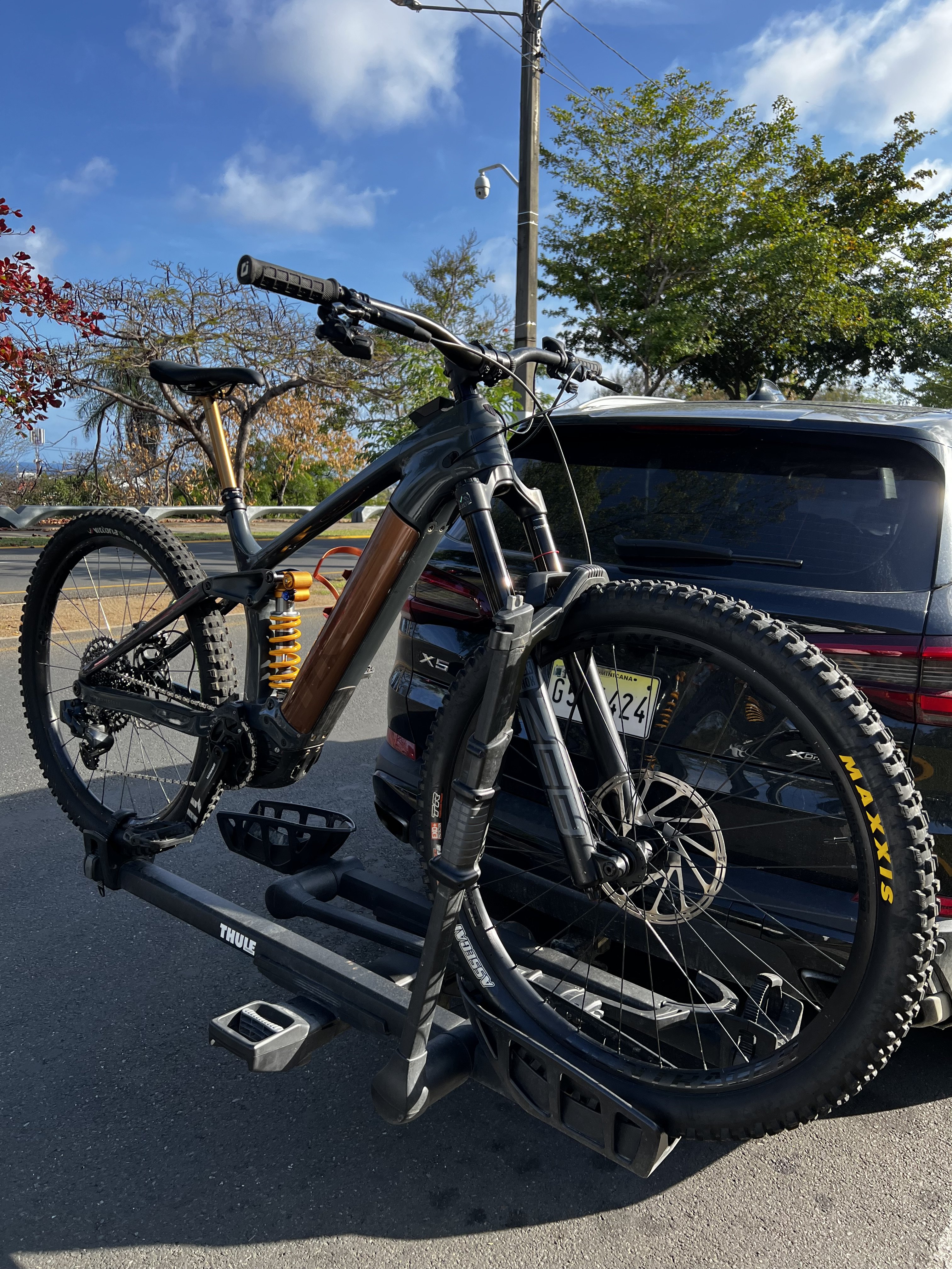

Just wanted to add to this thread since it helped me out quite a bit as I made the decision to upgrade rear shock on my Trek Rail 9.8 GX AXS build (2021 size L).
Went with Ohlins TTXM.2 coil
Using FULL 65 mm stroke (230x65) instead of 230X57.5
Shock clearly is far enough from frame when fully compressed without coil and bottom out bumper. No issues here. On Large frame at least. Works up to about 169mm rear travel.
Front fork upgraded to Zeb 170mm
This beautiful beast of mine now shreds downhill and still climbs decently.
Mini Link still set at low position.
Might push a bit further and go with a 180mm air spring up front and Mino link set to high, but currently very happy.
Effective Trek Rail 9.8 build 170/170mm
Head angle 64.1 degrees
So pretty she makes my wife jealous.

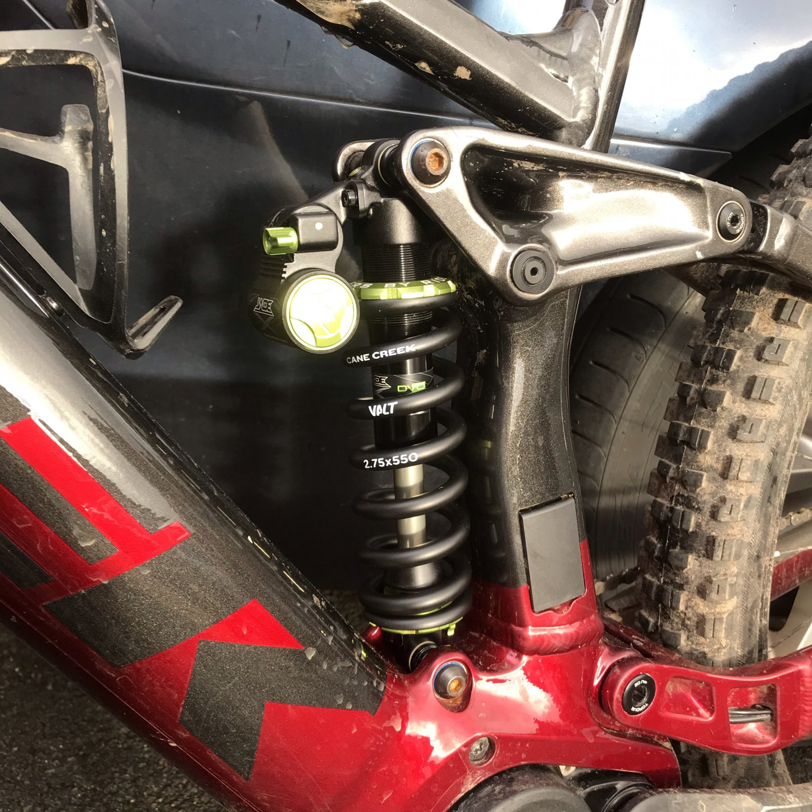

Have since changed from Ohlins 525lb spring to a Valt 500lb spring and removed one 2.5mm spacer to increase travel from 150mm to ~156mm, and upgraded forks to Zeb Ultimate A2 160mm.

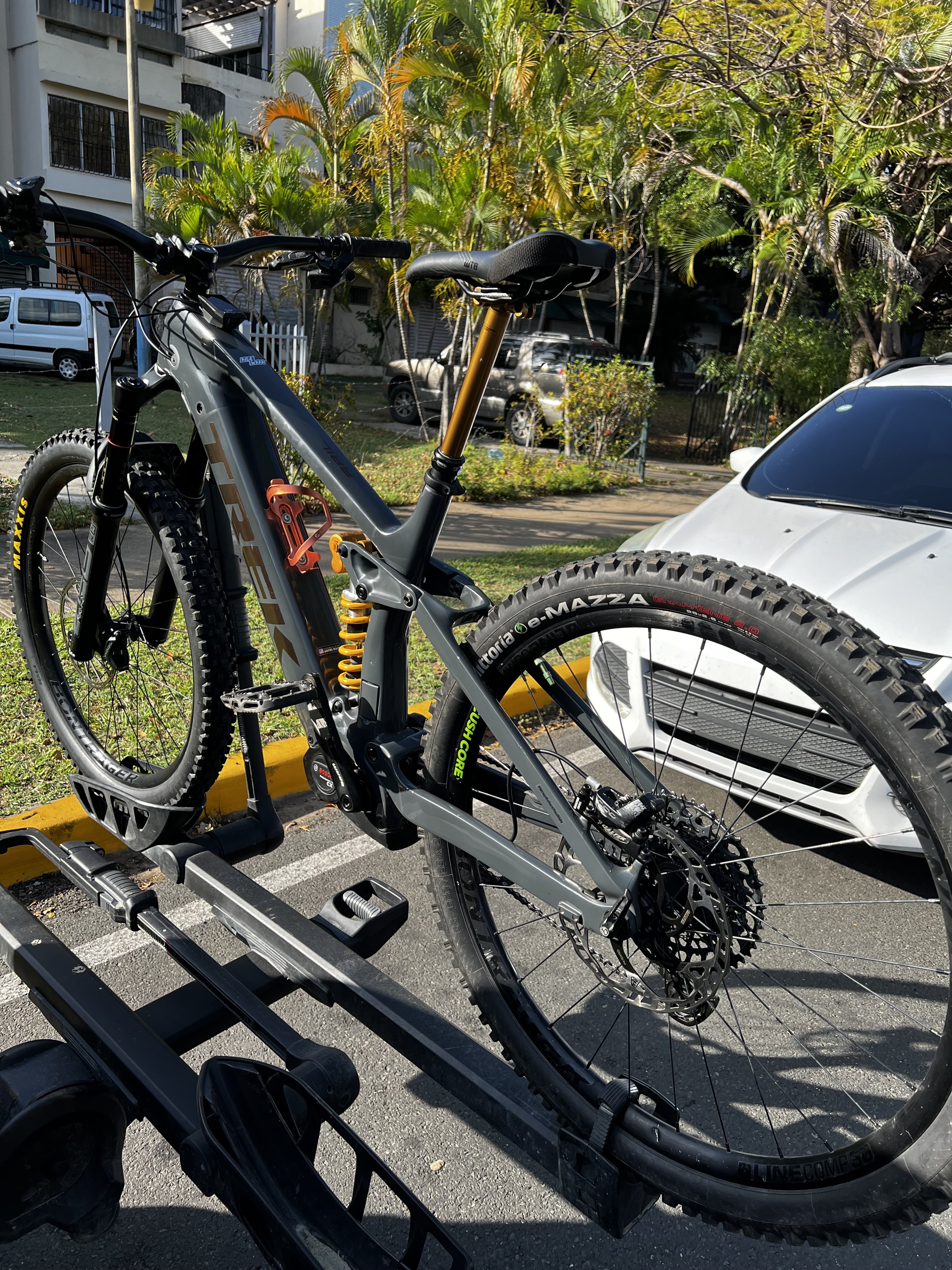

I recently came across a 2021 size medium Trek rail 9.8. The bike still had the original Bontrager tires and was owned by someone who is very gentle and easy on their gear that found himself in a position of owning four e-bikes, and offered me a very righteous deal for two of them. (the other was a 2020 Pivot Shuttle, both bikes had upgrades of carbon bars and carbon wheels. The pivot lasted all of 1 hour before a buddy offered me $500 profit on it which dictated that he was definitely the new owner)
I was able to pick up a Jade X Prime while they were on an amazing sale from DVO as well as a 170mm air spring for the Zeb.
My mechanic has informed me that the jade x prime will function without interference at the full 65 mm stroke.
I believe I'm going to initially set it up with a 2.5 mm spring cap reducing the stroke to 62.5mm.
Sounds like this should put the bike at 170 front/163 rear.
I won't be able to ride this bike for another week or two due to current family obligations, but when I get a few rides in on it after I've dialed it in a bit I will definitely post my thoughts on the setup.
