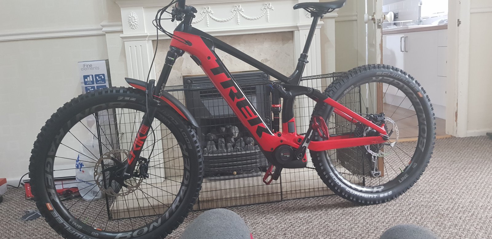

Just got it rebuilt after painting. New Minions mmmmmm. ODI rogues, WTB saddle, motor update. Coming this week One up carbon bars & composite pedals - it's all about comfort.

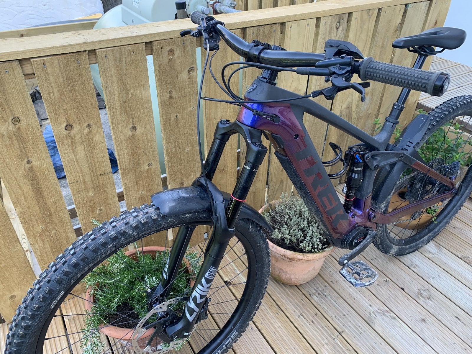

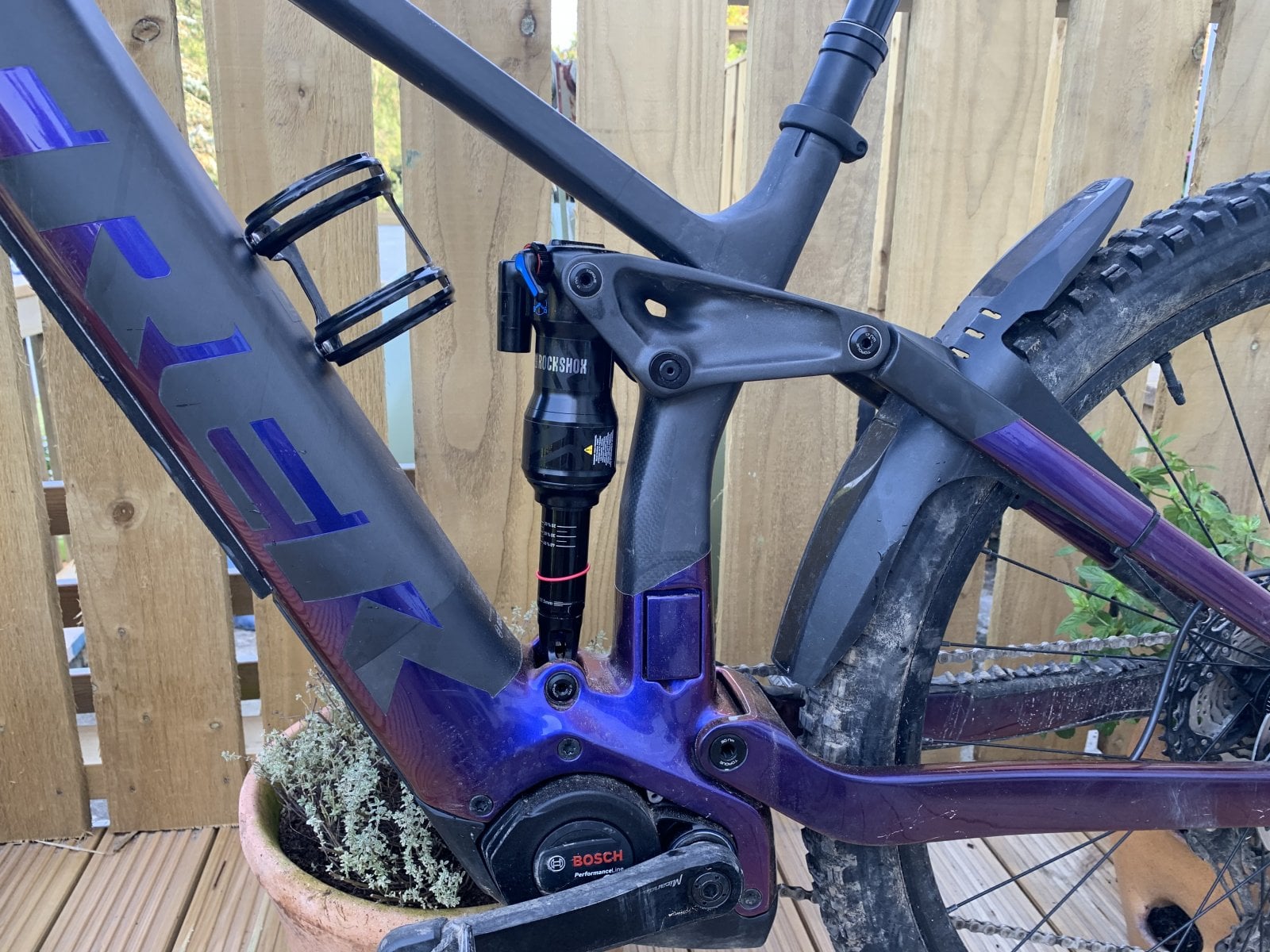

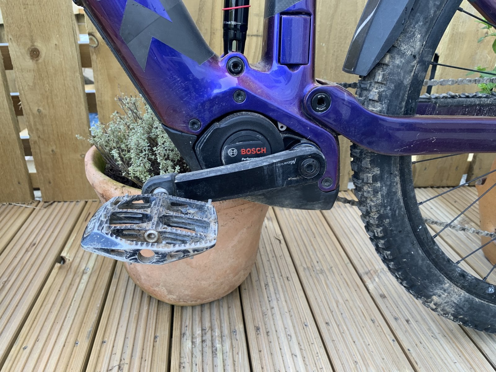

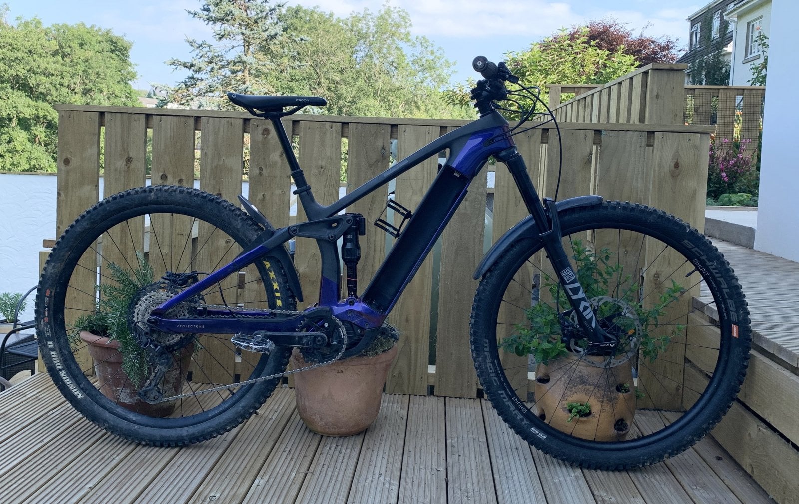

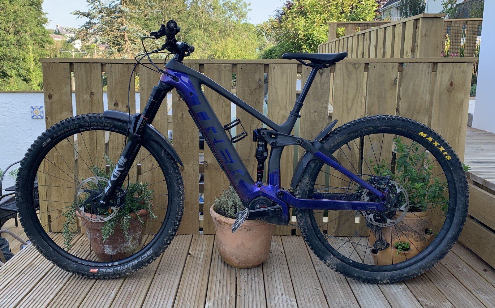

I bought a Rail 9.8 XT as it was basically the only medium Rail I could find! Wasn’t bothered about carbon but the lower weight is welcome.
Upgrades:
2.1rc2 damper
170mm C1 airshaft.
Megneg
Rev grips
Magic Mary front tyre
DD Maxxis DHR2 rear
Hunt Trail wide wheels - total crap rims, made of butter so currently changing the rear to a DT Swiss XM 481 rim (I actually like the Bontrager wheels and the 12 speed on my bike came with the 108pt engagement)
One Up 150mm dropper - the faster return is so much better and essential on an Ebike when you hammer XC uphills faster.
Miranda 160mm cranks. I was hitting the cranks in the low geo setting hence I fitted the 160mm cranks and raised the front with the 170mm airshaft.
Shop did the s/w update.
I’m running Hope pedals and will fit a 40mm Bontrager stem when they’re back in the UK.
The bike is brilliant, so fast and so much fun. Just fitted the. Megneg and 170mm airshaft today so looking forward to the next proper ride later in the week so see/feel the difference.
I’m 5’8” and the medium is perfect. The 150mm dropper is about 20mm proud of the seatclamp so I could possibly go more. I’ve got a couple of KOM’s and PR’s without really trying so it must be betterer than my old Powerfly LT.
Paint job looks lovely but wafer thin (mint sir) and chips easily but, hey, it’s a mountain bike!
Fitting the Megneg was slightly terrifying and because of the yoke at the bottom of the shock not exactly easy to modify and experiment on the trail side for fine tuning.
I went one positive token and two x negative bands. Seems easier on the first 30% then firms up in the middle as promised. Looking forward to trying it properly on drops, g-outs and general trail chatter. Happy to help if you’re wanting to fit one.
I’m 5’8”, 85kg in gear and a fast/aggressive rider.
