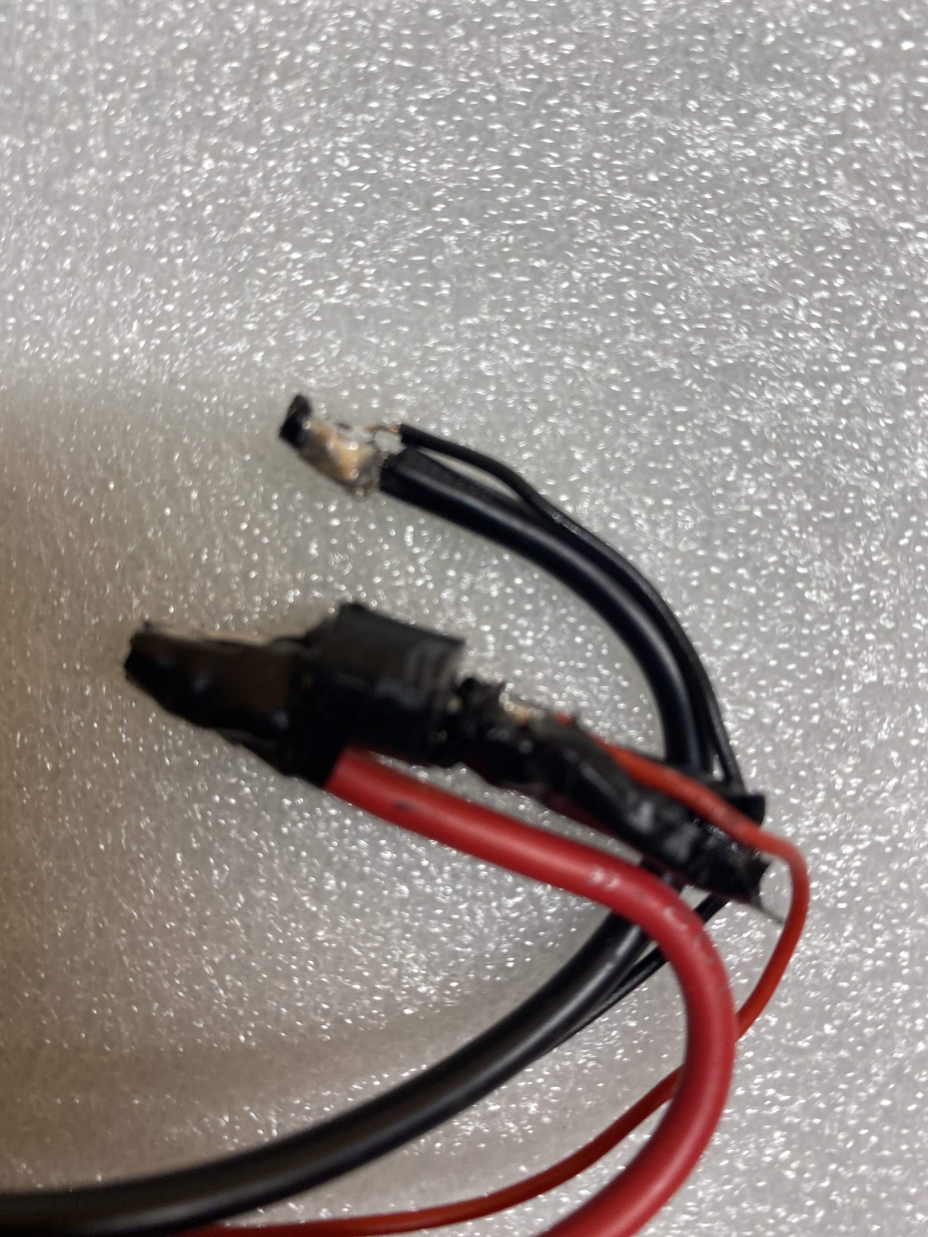

Here’s an example of a ‘so called’ active system available from one of these companies. Customer’s battery BMS was destroyed and the power input PCB within motor has burnt off the main board and was rattling around in motor casing.
