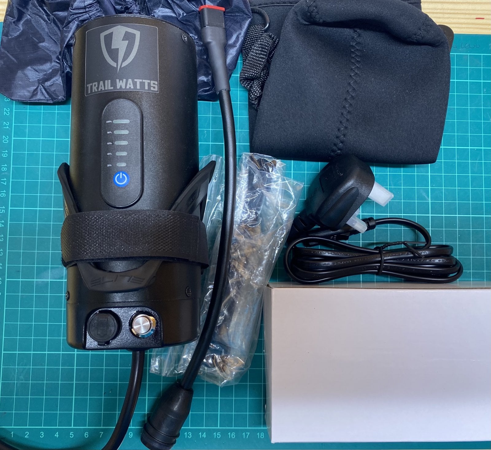

Kit assembly completed.

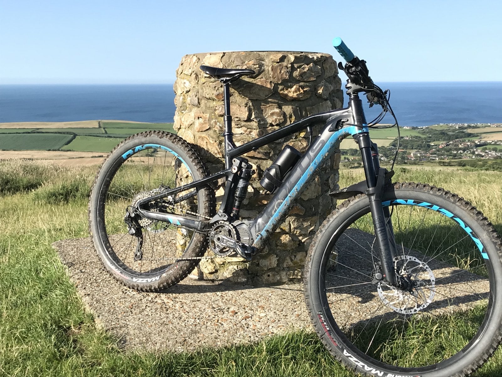

Just bought one of these 252Wh Batteries. It's a beautifully made piece of kit. Graham has done a great job here.

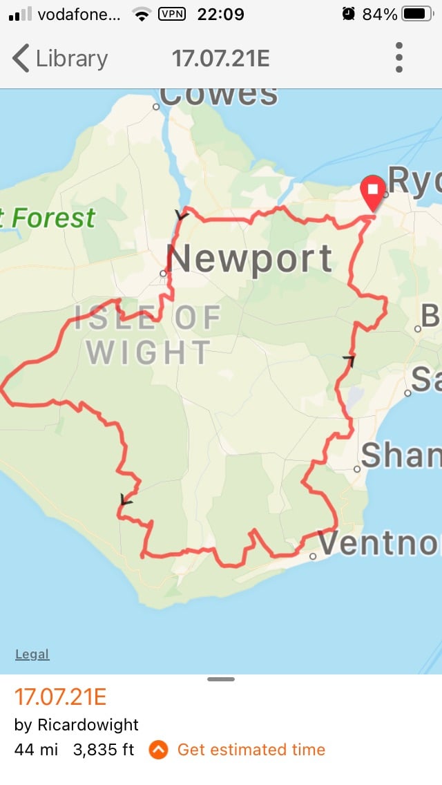

I tried it out for the first time today on a big ride on my local Isle of Wight trails.
44 miles and 3835ft (higher than Snowdon!), of climbing later I'm well chuffed (but my backside is complaining!)
The internal battery was showing 14 miles of Eco and 10 miles of Trail range remaining at the end of the ride.
I set off with the Trailwatts battery attached and running as the initial power source as recommended by Graham, and it kept going until 29 miles in and over 2000ft of elevation!
After switching to the internal battery, I was a little surprised how quickly the first power indicator bar disappeared .
I guess that the two batteries were working together and that a little of the internal battery was depleted at the same time as the Trailwatts battery was running?
But that quickly settled down and the bike indicated the kind of range that I would expect.
I must point out though that my focus Jam2 is tuned down to :
Eco - 20% assist - 30NM- This negates the weight of the bike and gives a gentle push, like you're fitter than you really are.
Trail - 60% assist - 30Nm
Boost - 100% assist - 70Nm
So it's not a full fat EMTB and is reasonably light at 22.2kg (23.6kg with the Trailwatts).
The ride was done in a mix of Eco and Trail with only a few very short sections of Boost when climbing particularly challenging sections.

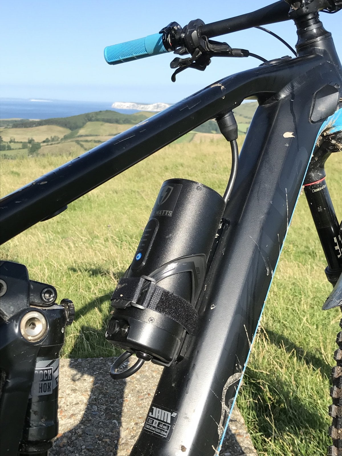

Much neater looking than the Focus T.E.C. pack - it just looks like you have a water bottle on there , very stealth, and I personally couldn't notice any difference in the ride/handling characteristics of the bike due to the extra 1.4 kg weight.
All good - thanks Graham & Trailwatts
