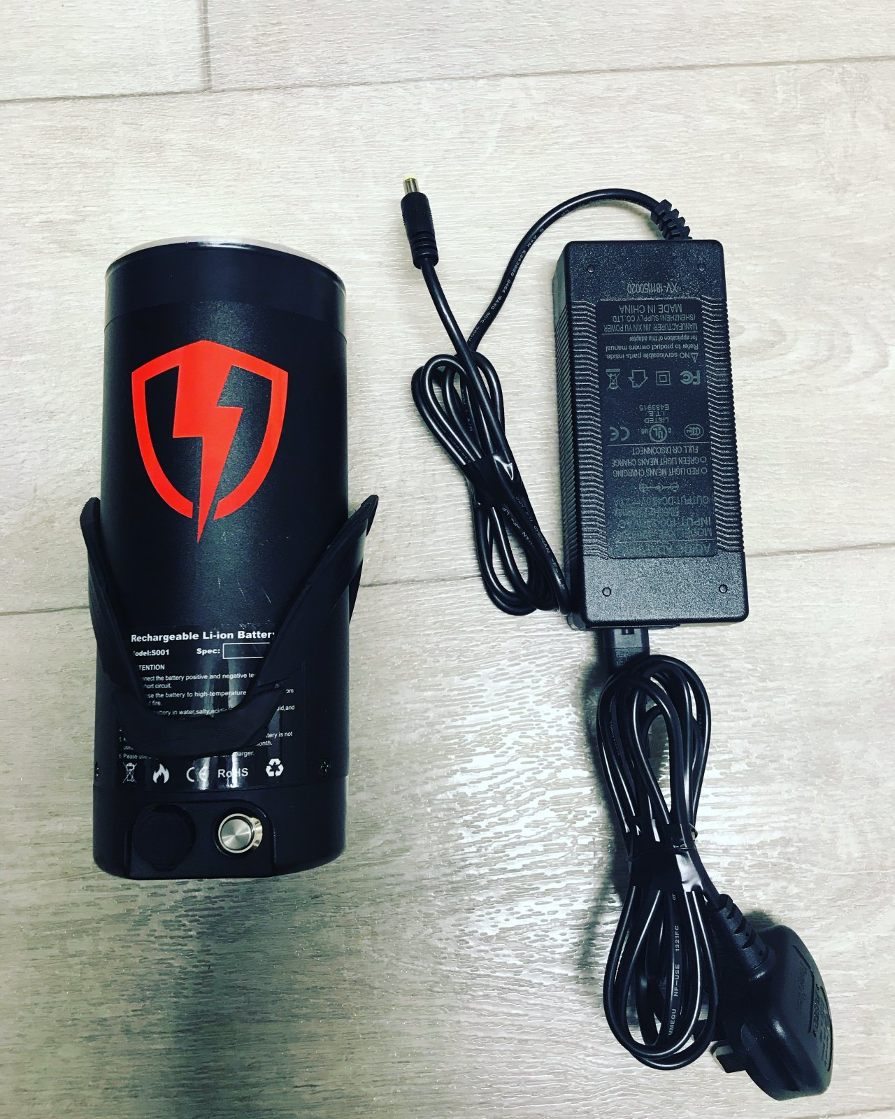

Hi everyone,
www.trailwatts.com has started testing range extending battery systems on Bosch.
Just wondering how many could do with an extra 252wh or 378wh to make their ride longer.
Ride the trails longer.
Graham at trail watts.

Frame pouch is probably best option for bikes without space for a bottle cage ??
Looking at abs mounts to secure booster but a pouch is safer for bikes.

Would deffo be interested. However I have a fox DPX2 shock and it comes very close to the bottle cage on my LT7, I know that with a larger bottle it touches, I will check on dimensions later. What sort or price are we looking at ?

Price depends on fitment really. I cannot release price till completed kit form. 2 types will be available due to newer trek/ Bosch having bottle cage options.

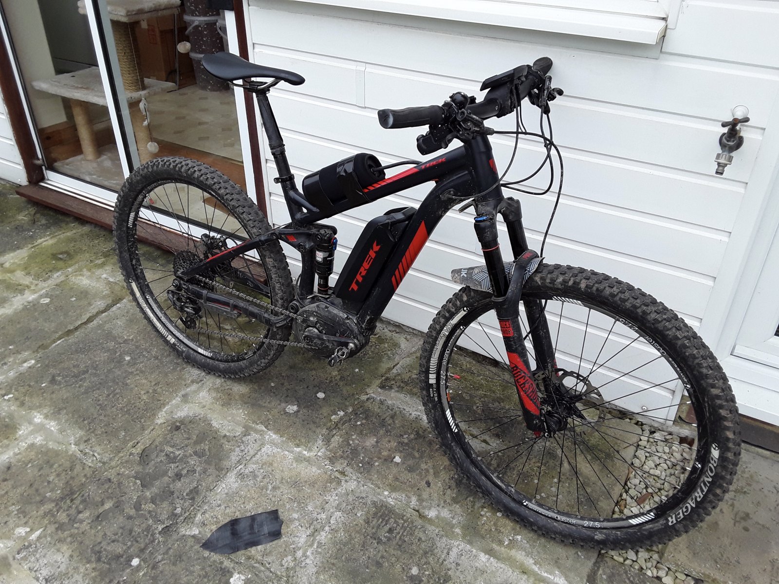

1st tests proves system integration working and drawing power from both factory battery and booster battery. Now to read through the data. Please do not comment about the fitment etc as this is proof of concept/ integration level.
Thank you for all the interest.
What size frame is that?

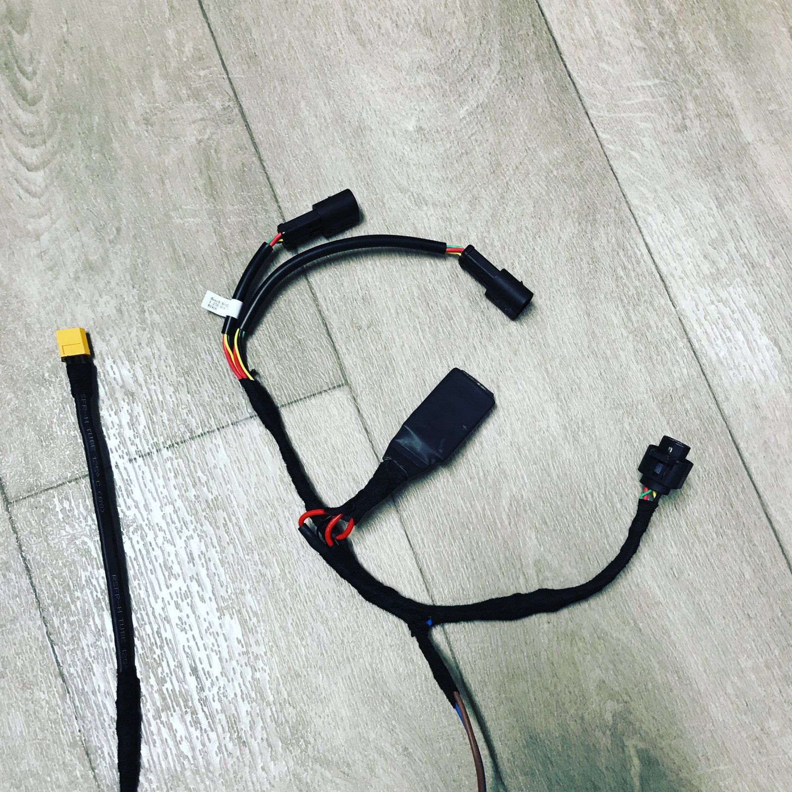

Testing is going well. Battery integration is working and test rides have proven system for Bosch. Working on harness assembly to allow end user to fit to bike. Not alot of room around motor area to hide module so looking to 3D print attachment to cage or battery itself to allow space under motor covers especially for users with speed chip attached.

As testing continues the loom design has not been started yet. I would hope to have a design and method once concluded.
I hope to be plug and play but the space restrictions on frame and motor may have to be a fitting service.

Bosch already do a twin battery loom, is that any good to you?
Twin loom is for combining flat Bosch with cx packs or haibike system.The Bosch system uses 5% from each battery at a time switching them on and off.
Not ideal compared to load sharing 752wh allowing you to remove 1.4kg if only doing 500wh ride etc
Haibike system good but early bikes need a different system.
