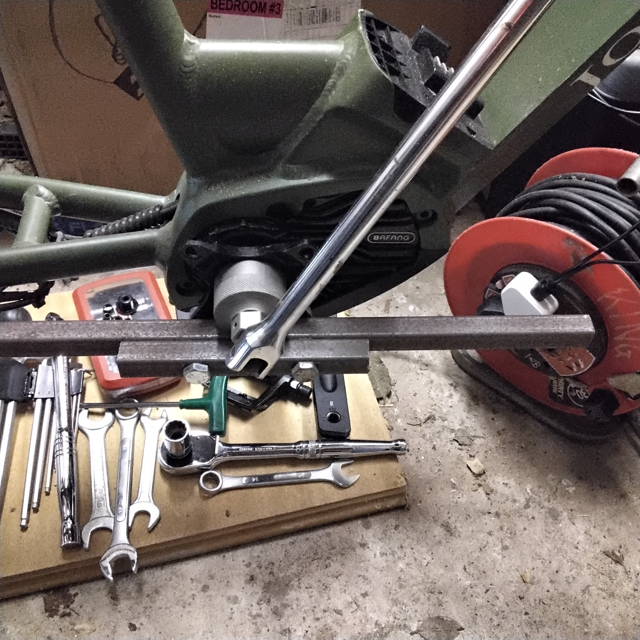

Hi,
I am trying to take the motor apart, and as usual, there are hurdles in the way. This time is the spider locking nut, which is super tight. I have bafang´s official tool (which kinda sucks), but in order to loose the nut one has to apply the force in the same direction than the freewheel, hence I have not been able to loosen it. I´ve tried putting the motor in a vise, but the problem is pretty much the same. I would have to somehow fix the spider (which is not really strong) to be able to unscrew the nut. I ´ve even used a bolt screwed into one of the ISCG mount holes to create a stopper for the spider, but the bolt ended up bent.
Any one smarter/more experienced than me, that can shed a light?
Any Macgiver among the public?
Greatly appreciated
Take an aluminum bar or small length of steel angle. Steel bedframes are just the right material. Take a piece about two feet long, and drill holes to match the holes in two adjacent spider arms. Bolt your Bed Frame Tool to the spider. Now it's a long handle that will allow you to hold everything rigid as you loosen the nut.
Thanks RustyIron, seems the way to go.

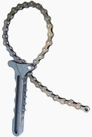

Your basic chain whip for holding the rear cassette whilst undoing that is more than suffice. Basic trick is to zip tie the chain section in a couple of places to stop it coming off the sprocket. If that is still a bit tight then put a bit of pressure on the tool ( its a left hand thread by the way ) and tap the tool with a hammer gently, the shock normally is enough to break the grip of the thread.
