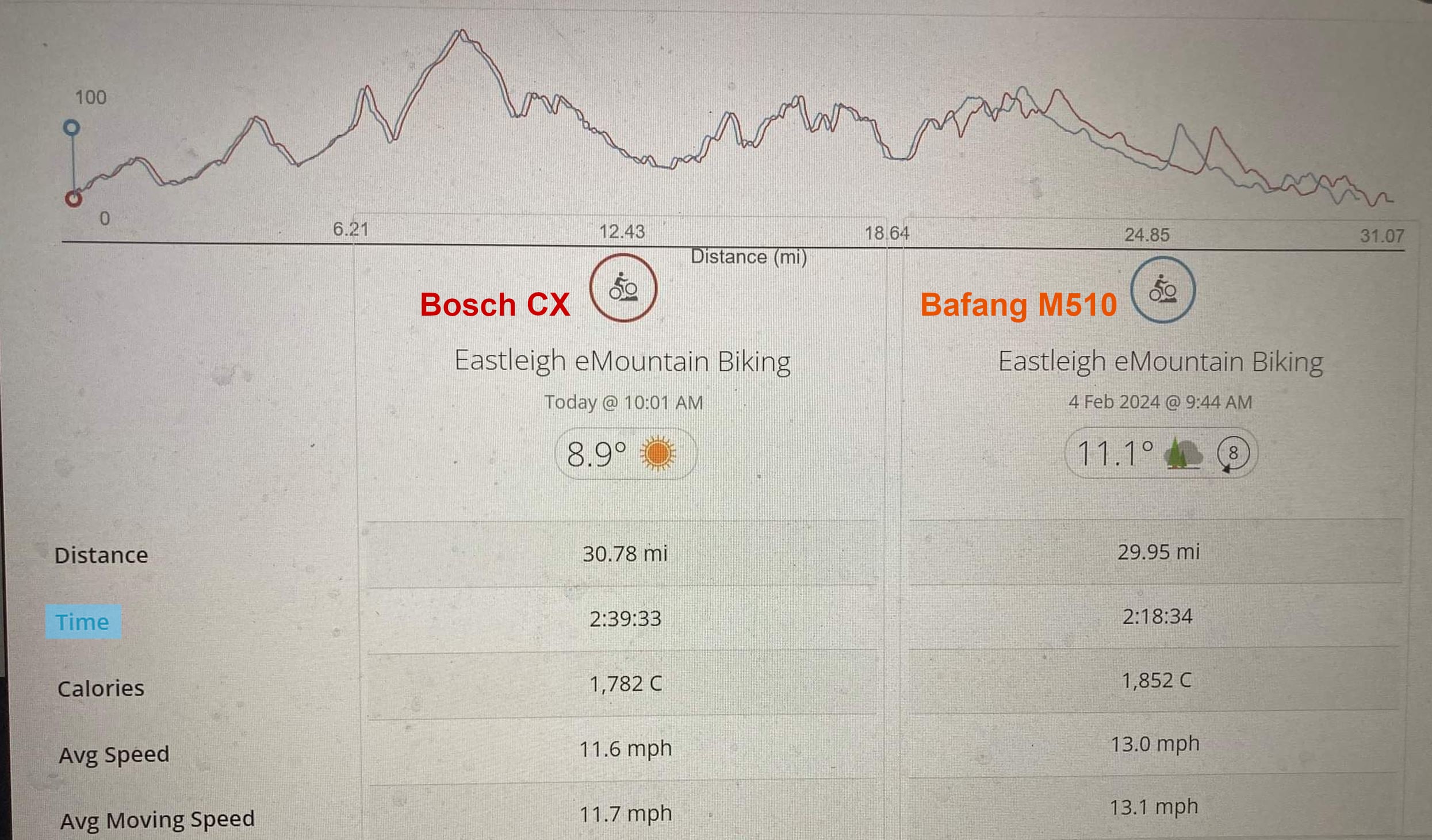

Hello. It is peaking 720W electrical. Yes, the question is efficiency, so what power is at the rear wheel. Bosch is not peaking this power.
Here is one comparison from one ebiker from USA. Same trail. 20 minutes difference on 30 mile track.
14,376
21,602

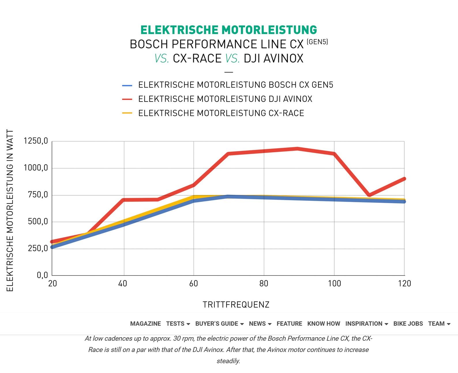

Bosch CX gen5 and Bosch CX Race have peak power input 750W:Der große E-Bike Motoren Vergleich - 15 E-MTB Motoren im Test
My M510 FC2 has peak power input 700-750 W (display C245).
According to tests on climbs, the M510 is slightly slower than the Bosch CX4 (approx. 1 s on a 1 min and 10 s climb):
Hello Andy.
1200W electrical of DJI is remarkable. I wish Bafang will copy :) this HW gearing design - is best so far! Can be very reliable.
Difference is that Bafang can hold this peak for long. Bosh did overheat quite quick in a race (purely on Turbo) and did reduce power.
What a great article! A must read for all, even nerdy part for me. ;)
Possible to find power curves also for the rest of motors?
Had one M510 with older firmware (with greater overshooting) and was peaking 820W. ;) Bafang is measuring current quite precise, was comparing against smart BMS.
Unlucky, that latest Bafang controllers have almost no overshooting.

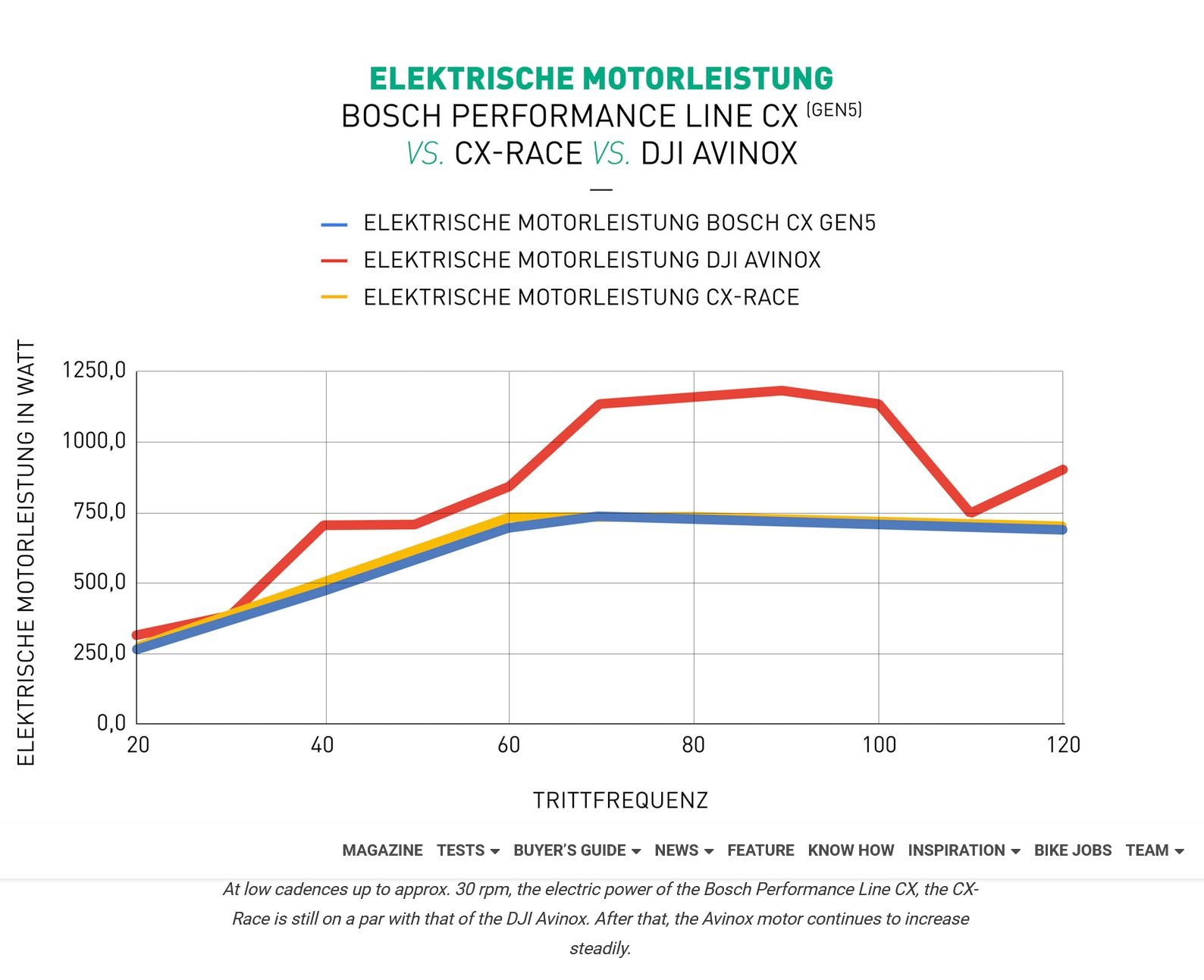

14,376
21,602
According to the chart in the article:https://monami.hs-mittweida.de/frontdoor/deliver/index/docId/15359/file/Kreter.pdf
the Brose motor is more powerful than the Bosch-about 800W peak power (electric)

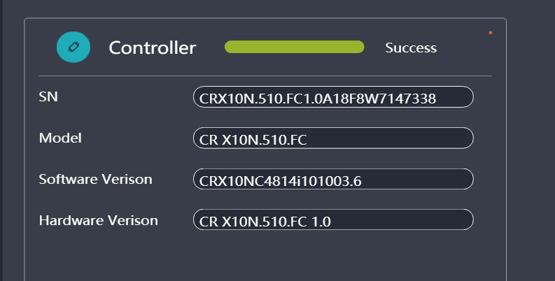

Hello, after i uploaded firmware i can't turn on my engine (M510) but when i connect motor+ HMI to besst i see on screen Battery% and i can change support level, any idea?
Dado
Jun 28, 2022
741
502
Bratislava
Hello. Then just faulty buttons or cable/connector from a display. If motor starts over Besst.
Besst is waking up processor over same pin by grounding.
