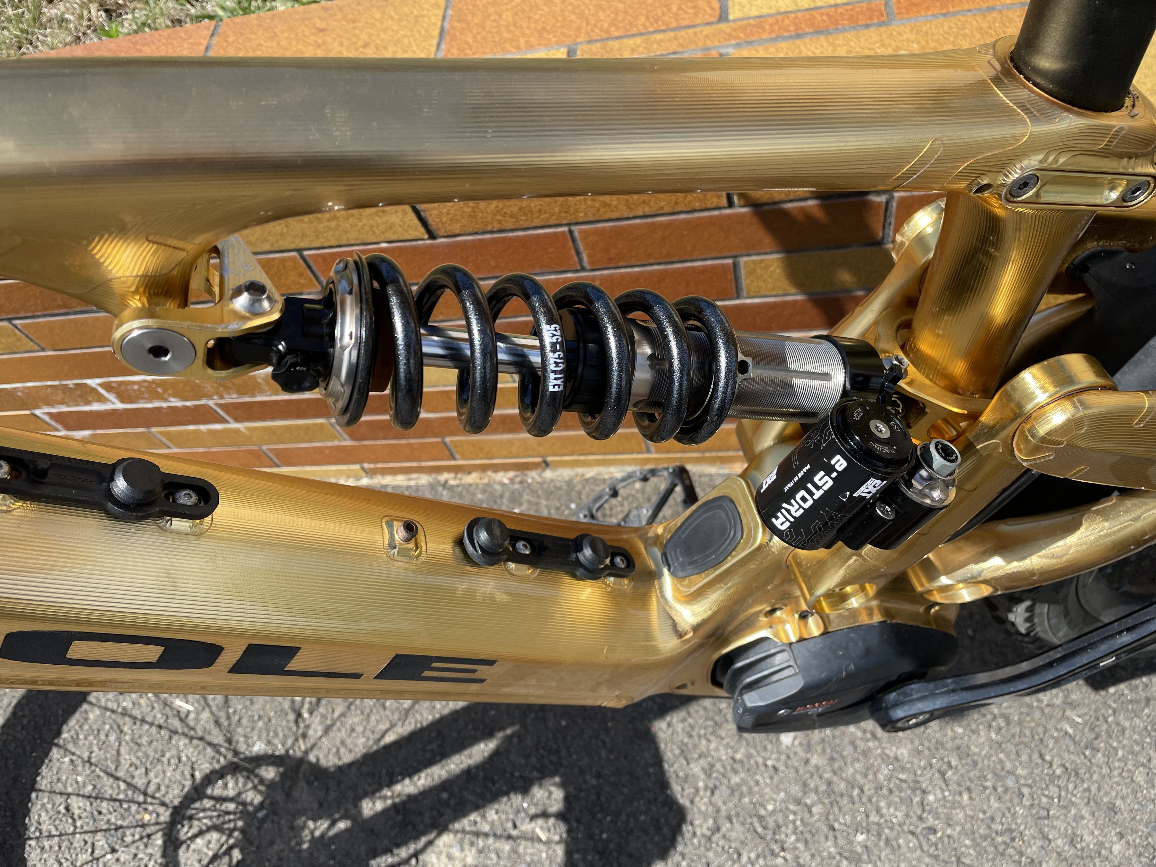

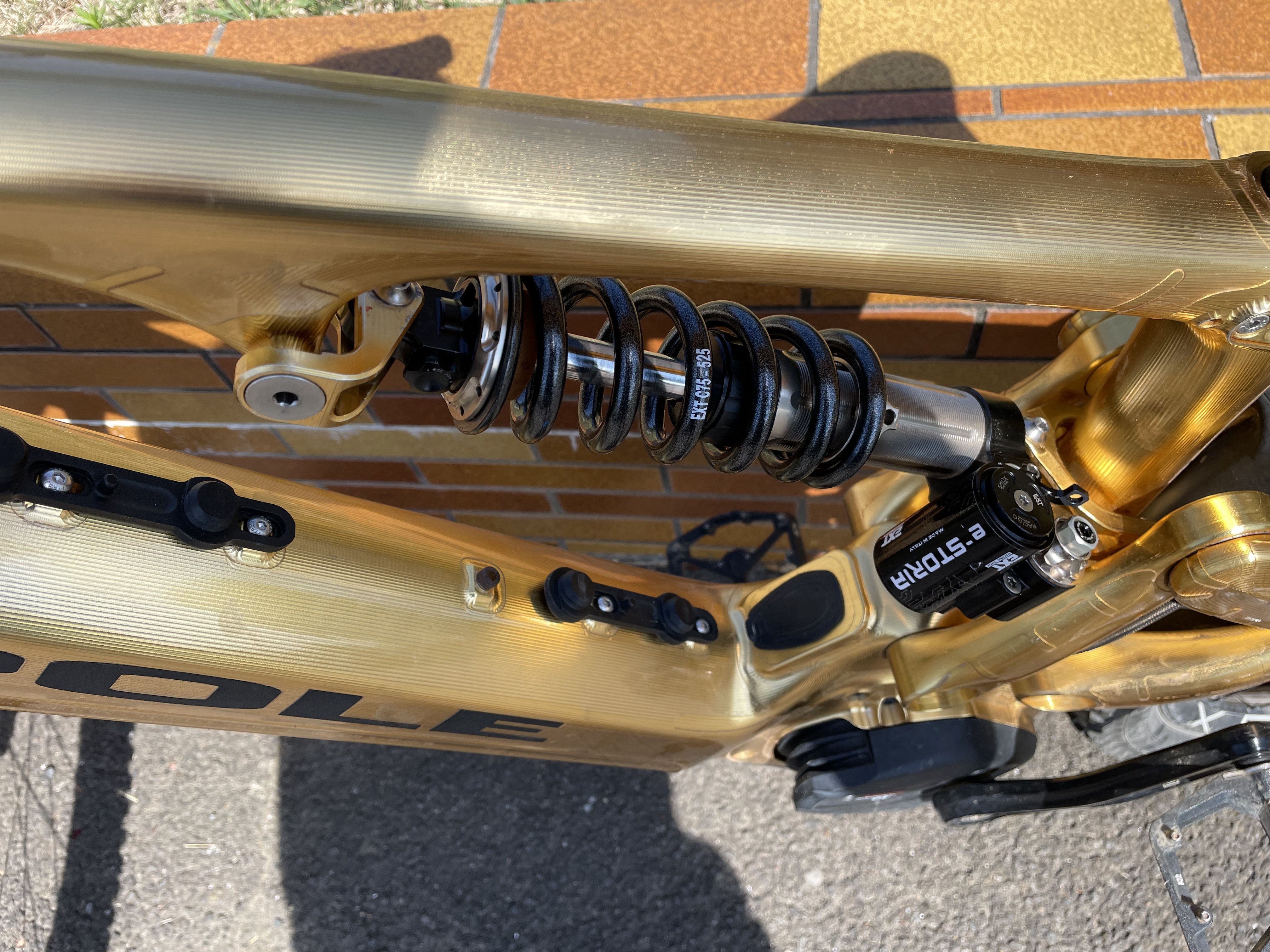

Gandalf
Dec 16, 2020
39
114
What bushings did you use on the EXT E-Storia?
New ordered or the "old" from the existing damper removed
regards Erwin
Gandalf
Dec 16, 2020
39
114
Conversion finished
